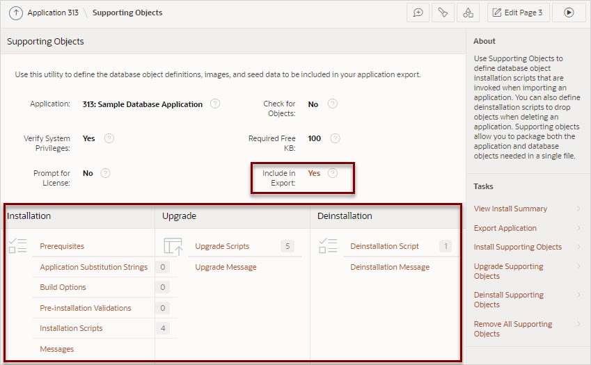

25.4.2.2 Supporting Objects Page
Learn about the Supporting Objects page.
The top of the Supporting Objects page displays the application name and indicates current selections for the following: Check for Objects, Verify System Privileges, Required Free KB, Prompt for License, and Include in Export. To learn more about these options, see field-level Help.
To specify whether to include supporting objects with an application export, find Include in Export at the top of the page, click either Yes or No. If you select Yes, a new page appears. From the Include Supporting Object Definitions in Export list, make a new selection and click Apply Changes.
The rest of the page is divided into the following categories: Installation, Upgrade, and Deinstallation.
25.4.2.2.1 Installation
Learn about the links under Installation on the Supporting Objects page.
Use the links under Installation to define the following types of information:
  • Prerequisites. Defines built-in checks required before installing the application, such as required free disk space, required system privileges, and schema object restrictions.
  • Application Substitution Strings. Lists static substitution strings defined for the application. You can define static substitution strings for phrases or labels that occur in many places within an application.
    When packaging an application, you can include prompts for substitution strings which users can specify when they install the custom application.
  • Build Options. Lists build options defined for this application. You can use build options to conditionally display specific functionality within an application.
    When packaging an application, you can include prompts for specific build options which display when the application is installed.
  • Pre-installation Validations. Lists validations defined for the custom application. Similar to normal page validations, these validations prevent a user from installing database objects if the user-defined conditions are not satisfied. To create a new validation, click Create and follow the on-screen instructions.
  • Installation Scripts. Define multiple installation scripts that create the application's supporting database objects. To create a new script, click Create and follow the on-screen instructions. To edit an existing script, click the Edit icon. To prevent another developer from editing a script, click the Lock icon. If the script is locked, the Lock icon appears as a closed padlock. If the script is unlocked, the Lock icon appears as an open padlock.
    The Data Package installation script type requires Oracle Database 18c and later.
  • Messages. Enables you to define messages that display when the user installs or deinstalls the application. Supported HTML tags include <b>, <i>, <u>, <p>, <br>, <hr>, <ul>, <ol>, <li>, and <pre>.
    When these messages display, only a limited set of HTML tags are recognized to prevent a cross site-scripting (XSS) attack.
25.4.2.2.2 Upgrade
Learn about the links under Upgrade on the Supporting Objects page.
Use the links under Upgrade to define the following types of information:
  • Upgrade Scripts. Click Upgrade Scripts to define scripts to upgrade database objects, images, and seed data when upgrading an existing application.
  • Upgrade Message. Enables you to define messages that display when the user upgrades the application. Supported HTML tags include <b>, <i>, <u>, <p>, <br>, <hr>, <ul>, <ol>, <li>, and <pre>.
25.4.2.2.3 Deinstallation
Learn about the links under Deinstallation on the Supporting Objects page.
Use the links under Deinstallation to define the following types of information:
  • Deinstallation Script. Click Deinstallation Script to define a script to drop database objects and static files created by the installation scripts. To edit an existing script, click the Edit icon.
  • Deinstallation Message. Allows you to define messages that display when the user deinstalls the application. Supported HTML tags include <b>, <i>, <u>, <p>, <br>, <hr>, <ul>, <ol>, <li>, and <pre>.
