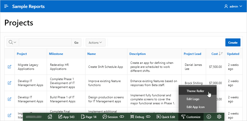

  1. Preview the page by running it.
    The Developer toolbar displays at the bottom of any editable running page.
  2. On the Developer toolbar, click Customize and then select Theme Roller.
    Description of customize_menu.png follows

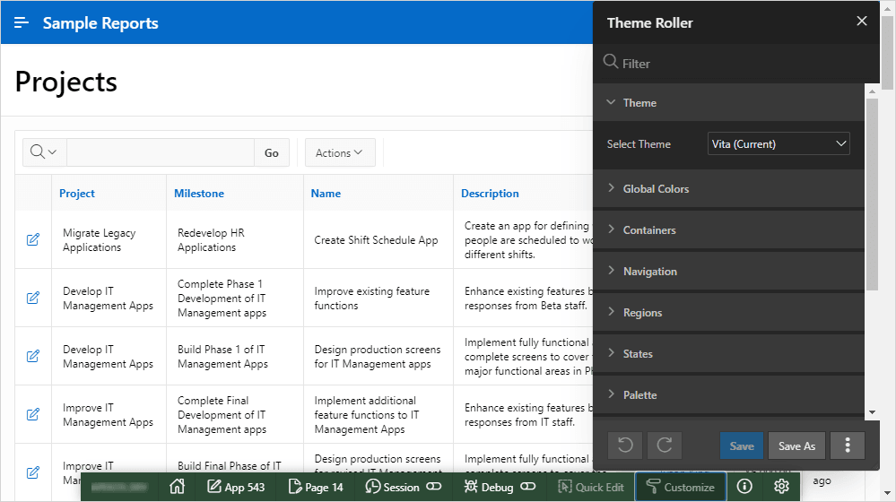

    Theme Roller fetches the styles for your application and loads them in the editor. The Theme Roller dialog appears.
    Description of theme_roller.png follows
  3. To search for an attribute, enter search terms in the Search field at the top of dialog. Only attributes that contain the search term appear.
    Tip:
    To navigate the Theme Roller dialog using keyboard shortcuts, press Ctrl+Fn+M and then release. Then, press Tab to navigate.
  4. To select or modify a theme:
    1. Theme, Select Theme - Select a theme from the drop-down list. In the next illustration, the Theme is set to Redwood Light.
    2. Expand or collapse sections by clicking on the section name.
    3. Modify the attributes.
      Undo and Redo - When you modify an attribute, the Undo and Redo buttons at the bottom of the dialog become active.
    4. Reset a Theme Style - To revert any unsaved theme style changes, select Reset from the Additional Options menu . The Additional Options menu is located next to the Save As button at the bottom of the dialog.
  5. Custom CSS - Enter CSS or or LESS-compatible code in the Code Editor. If you are including LESS-compatible code, you must enable the Enable LESS Compilation switch.
  6. Export or Import - Export or import theme style changes directly from the Theme Roller dialog. Select Export or Import from the Additional Options menu located next to the Save As button at the bottom of the dialog.
  7. Save the theme by clicking one of the following:
    • Save - If the theme is editable, Save saves any style change and sets the theme as the application's current style.
    • Save As - Click Save As to save the theme as a new style and sets it as the application's current style.

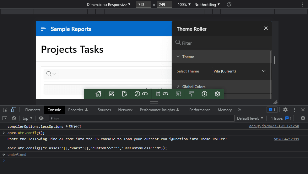

11.1.4.6 About Developer Console Integration
Use the exposed function apex.utr.config(); in your web browser developer's console to get and set the custom CSS code and LESS compilation configuration
Use the exposed function apex.utr.config(); in your web browser developer's console to get and set the custom CSS code and LESS compilation configuration.
To get styles, write apex.utr.config() without parameters into the console:
apex.utr.config();
Paste the following line of code into the JS console to load your current configuration into Theme Roller:
  apex.utr.config({"classes":[],"vars":{},"customCSS":"","useCustomLess":"Y"});
Description of dev_console_1.png follows
To set styles, add less or css code in the customCSS object of the JSON configuration into the console:
apex.utr.config({"classes":[],"vars":{},"customCSS":"h1 { color: #111; font-family: 'Helvetica Neue', sans-serif; ... }", "useCustomLess":"Y"});
The custom CSS will be added to the theme roller Code Editor and applied to the page automatically.
