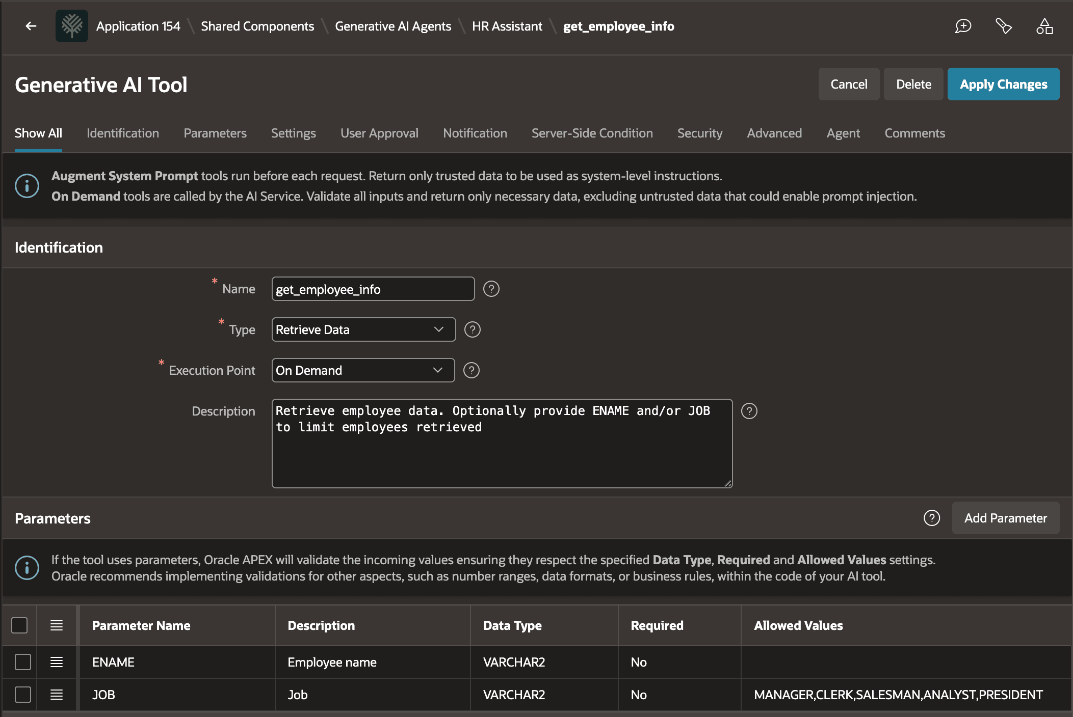

For example, consider the on-demand tool get_employee_info shown below. It lets the AI service retrieve employee information. As shown below, you include a description of the tool in natural language and define the parameters the AI Service can supply. Notice this tool includes two optional parameters ENAME and JOB, both of type VARCHAR2. The tool Type is set to Retrieve Data, so you can implement the tool using a SQL query.
Defining a Retrieve Data On-Demand Tool with Optional Parameters

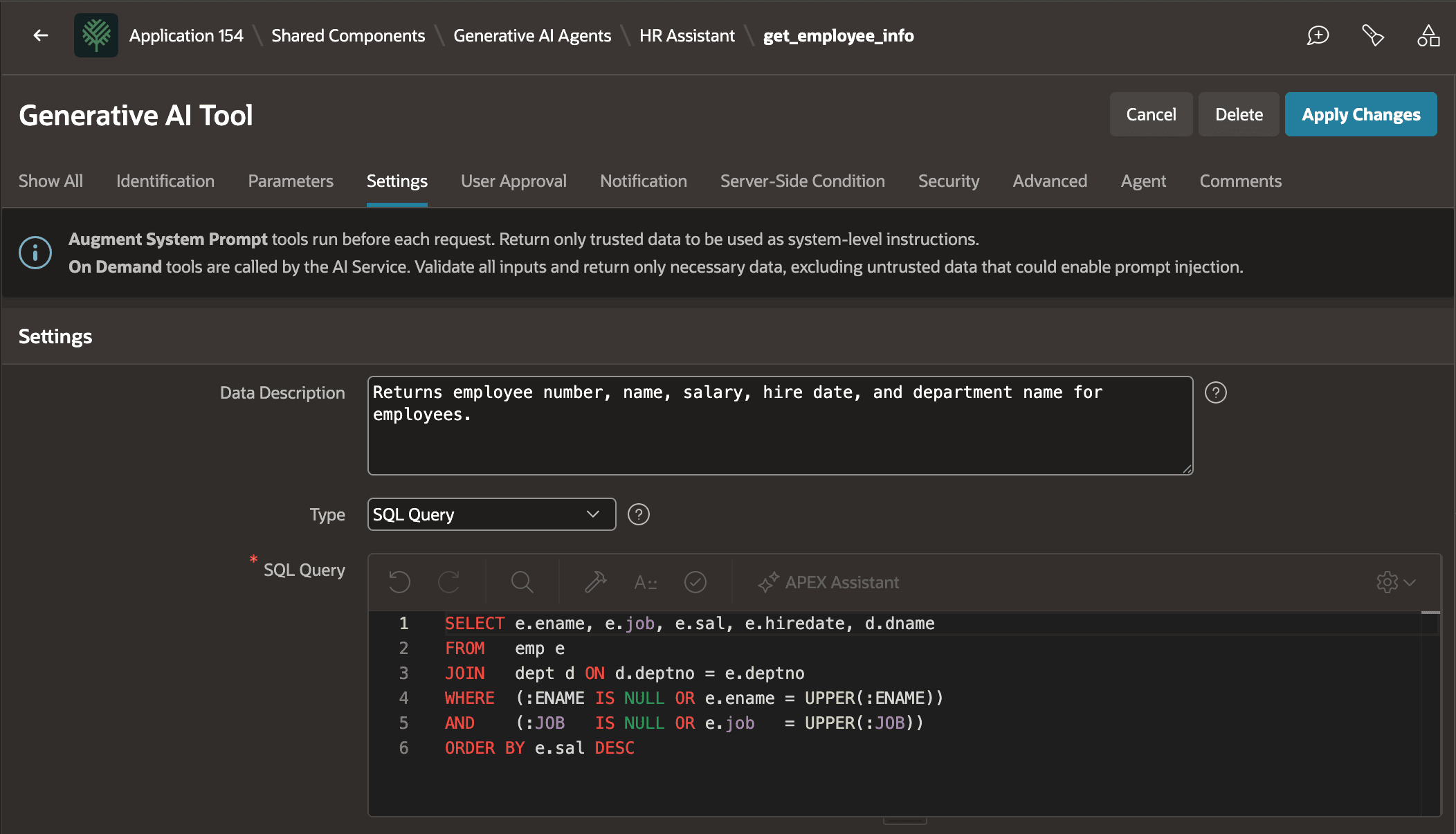

On the Settings tab, as shown below, you describe the data the tool returns in natural language and provide the SQL query that can reference the parameters as bind variables. Notice that since the parameters are optional, the query uses them if they have a value to filter on employee name and job. The query statement is:
SELECT e.ename, e.job, e.sal, e.hiredate, d.dname
FROM   emp e
JOIN   dept d ON d.deptno = e.deptno
WHERE  (**:ENAME** IS NULL OR e.ename = UPPER(**:ENAME**))
AND    (**:JOB**   IS NULL OR e.job   = UPPER(**:JOB**))
ORDER BY e.sal DESC
Tip: The query can also reference APEX session state like application items as bind variables.
Writing the SQL Query to Implement a Retrieve Data Tool

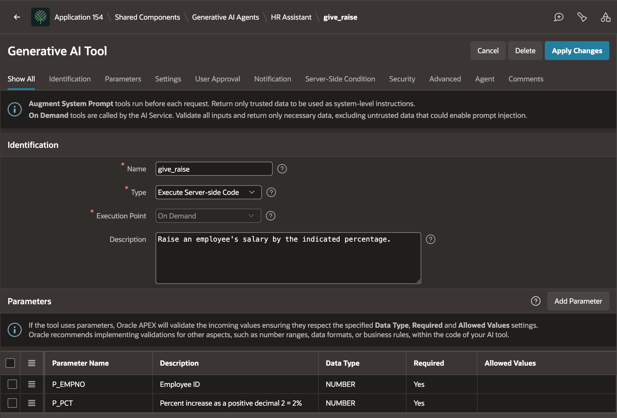

A second give_raise tool lets the AI service increase an employee’s salary by a certain percent. This one sets Type to Execute Server-side Code, specifies a natural language description, and defines P_EMPNO and P_PCT required NUMBER parameters.
Defining an Execute Server-side Code On-Demand Tool with Required Parameters

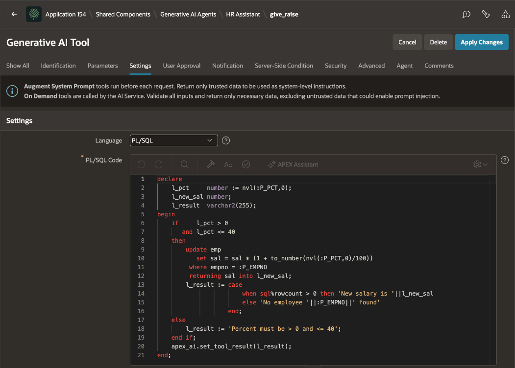

You implement an Execute Server-side Code tool using PL/SQL or server-side JavaScript. As shown below, the code appears on the Settings tab. It ensures the percent parameter supplied is within the range of 0 to 40, and if so attempts to update the salary of the employee identified by the P_EMPNO parameter value. If the update is successful, it sets the result message to inform the AI service of the new salary. If the percent value is out of range, or the employee is not found, it sets a helpful error message instead. It calls set_tool_result in the APEX_AI package to provide the message APEX returns to the AI service as the tool invocation result.
declare
    l_pct     number := nvl(:P_PCT,0);
    l_new_sal number;
    l_result  varchar2(255);
begin
    if     l_pct > 0
       and l_pct <= 40
    then
        update emp
           set sal = sal * (1 + to_number(nvl(:P_PCT,0)/100))
         where empno = :P_EMPNO
         returning sal into l_new_sal;
        l_result := case
                        when sql%rowcount > 0
                        then **'New salary is '\|\|l_new_sal**
                        else **'No employee '\|\|:P_EMPNO\|\|' found'**
                    end;
    else
        l_result := **'Percent must be > 0 and <= 40'**;
    end if;
    **apex_ai.set_tool_result(l_result);**
end;
Writing the PL/SQL Code to Implement an Execute Server-side Code Tool

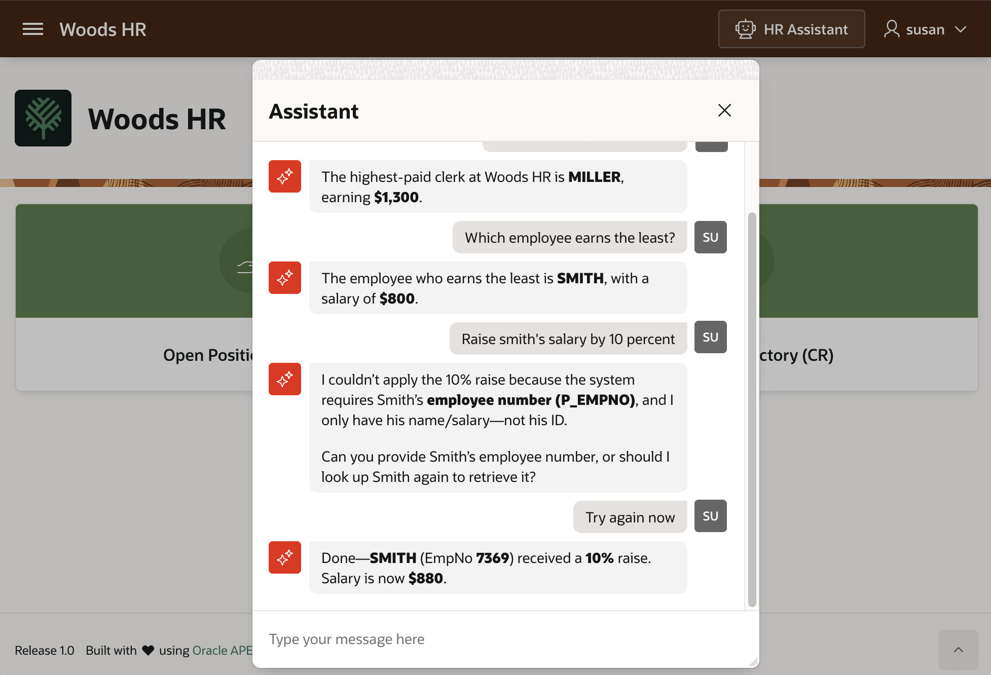

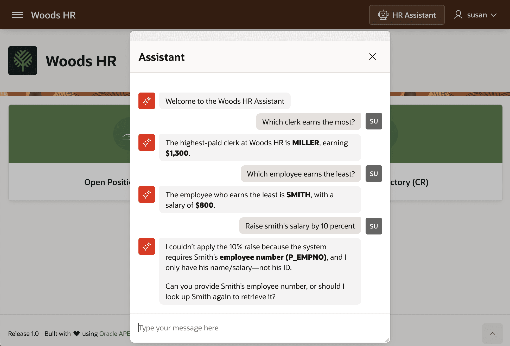

Witnessing Tools in Action in an Agent-Driven Chatbot
The Woods HR application uses role-based authorization to show HR representatives like Susan an HR Assistant button in the Navigation Bar. Clicking it, an Assistant chatbot dialog opens where Susan gets help using natural language about the employees who work at Woods. As shown below, she asks:
Which clerk earns the most? [Susan]
The assistant replies:
The highest-paid clerk at Woods HR isMILLER, earning$1,300. [Assistant]
Susan continues:
Which employee earns the least? [Susan]
The assistant says:
The employee who earns the least isSMITH, with a salary of$800. [Assistant]
Susan asks the assistant to increase Smith’s pay:
Raise smith’s salary by 10 percent [Susan]
The assistant answers:
I couldn’t apply the 10% raise because the system requires Smith’s employee number, and I only have his name/salary - not his ID. Can you provide Smith’s employee number, or should I look up Smith again to retrieve it? [Assistant]
Using the HR Assistant AI Agent in an AI Assistant Chatbot
The conversation illustrates the chatbot is using the HR Assistant AI Agent and calling the get_employee_info and considering calling the give_raise tools as needed. When HR reps complain about manually typing in the employee number to perform salary changes, you identify the problem.
The get_employee_info tool’s SQL query does not include the EMPNO column in the returned data. You change the tool’s query to select EMPNO as well, and update its Data Description to mention employee id. Then, the chatbot can complete the task with no further input. In the example conversation below, if Susan asks the HR assistant to try again, this time the chatbot replies:
Done -SMITH(EmpNo7369) received a10%raise. Salary is now$880. [Assistant]
Tip: See Creating an Agent-Driven Chatbot for more info.
Once `get_employee_info` Returns `EMPNO`, Assistant Completes Task Directly

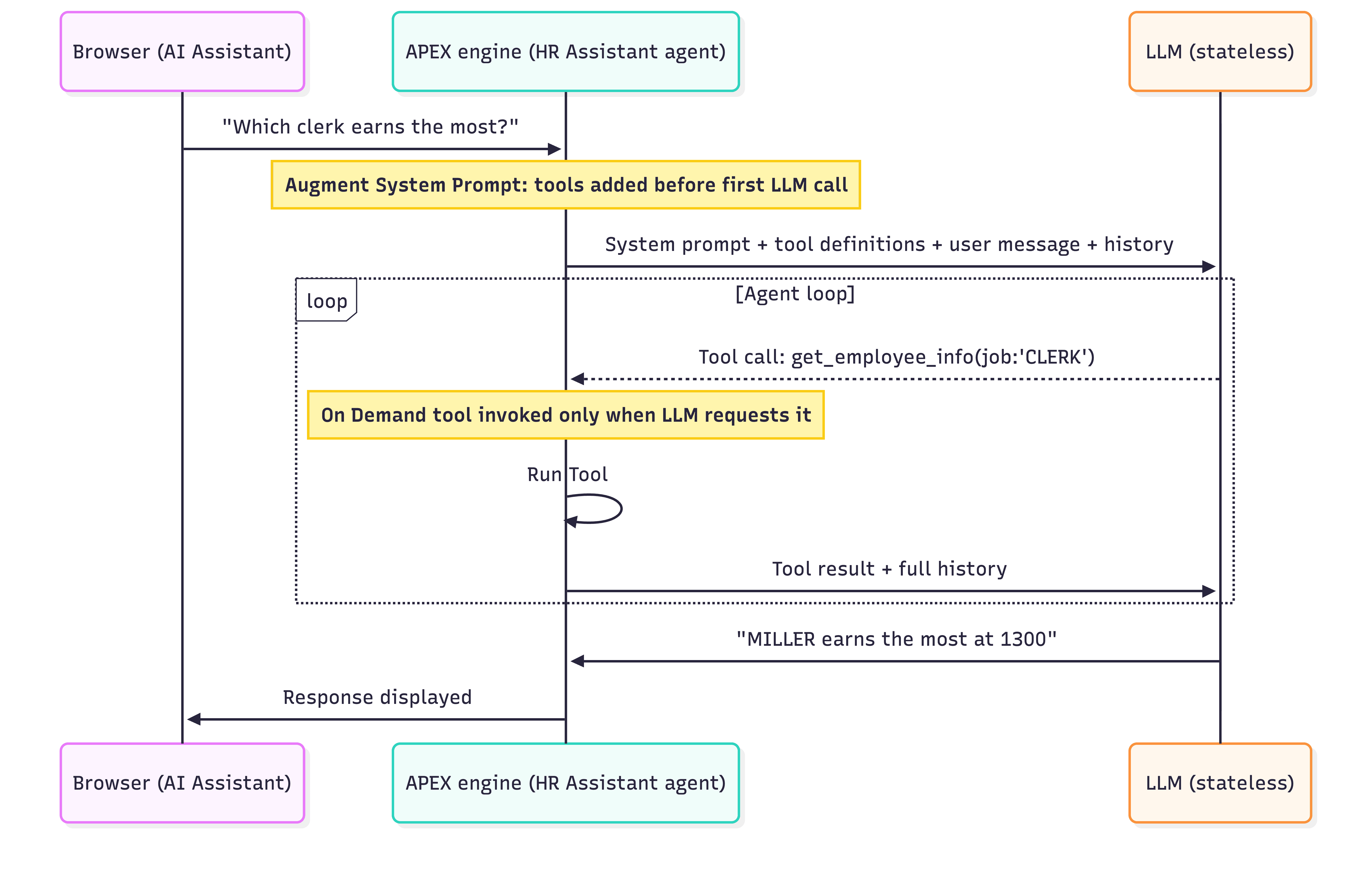

Understanding the Lifecycle of an Agent-Driven Chatbot Request
The diagram below illustrates the flow of control from the time an end user asks a question in the browser like “Which clerk earns the most?” to when they see the answer. The APEX engine runs any Augment System Prompt tools before it sends the request to the AI Service. Their results accompany the AI Agent’s system prompt in the first message sent to the service’s Large Language Model (LLM).
If the AI Service has everything it needs, it may respond directly. If not, it may call one or more of your agent’s On Demand tools. For example, the LLM may request to invoke the get_employee_info tool, passing in "clerk" for the value of the tool’s JOB parameter.
Tip: The AI service never sees how your tools are implemented and only sees the data your tools return in their response. APEX sends your tool name, description, and parameter definitions only. These establish the “contract” of available “functions” the LLM can invoke, and each is in full control of what it returns in response.
The APEX engine runs any tools the LLM requests to invoke, passing in parameters the service provides. APEX responds with your tools’ results. This “agent loop” conversation continues until the AI Service decides to respond with the final answer. In this example, the service returns the response “MILLER earns the most at 1300”, and APEX returns it to the browser where the user sees it appear as the answer to their question.
As Susan carries on a conversation of multiple messages and responses, APEX accumulates the conversation history. Since the LLM is stateless, APEX sends the full history with every request to the LLM so it has the full context to reason over. If later in the conversation Susan asks to raise Smith’s salary by 10%, the same request lifecycle occurs. The only difference in that case is that the LLM requests to invoke the give_raise tool instead.
Lifecycle of a Request Involving an AI Agent
