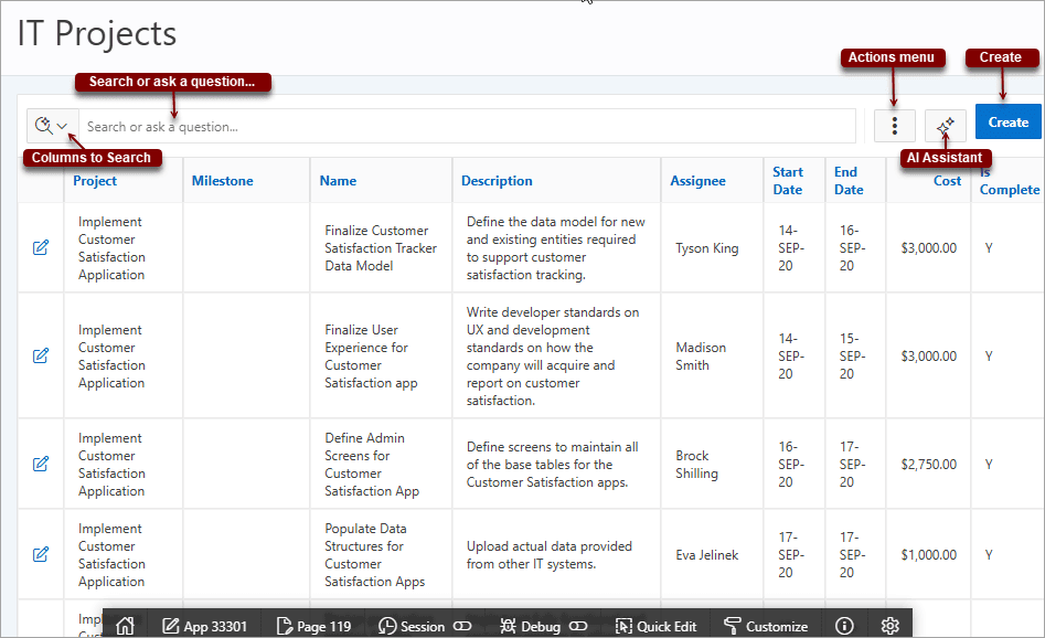

Save and run the page. Click Save and Run Page.
The interactive report page appears.
Note the search bar includes the following controls:
Columns to Search - Select specific columns to search or search all columns.
Search or ask a question - Enter natural language to apply filters, highlight, sort, show/hide columns,apply control breaks, perform group bys, aggregate data, pivot, create charts, add pagination save reports, and reset the report state.
Actions menu - Displays as three vertical dots (
). Use the Actions menu to customize the interactive report. Contains the same options that appear in standard interactive reports. -
Creates - Create a new row in the table.

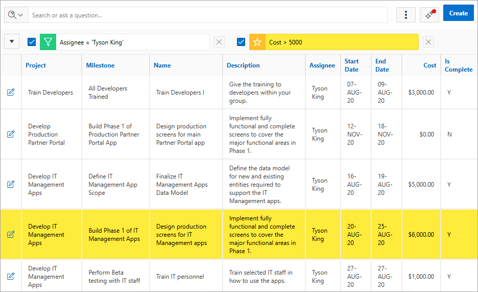

In the Search or ask a question:
Enter natural language to filter the report. For example:
Show projects where the Assignee is Tyson King and highlight rows in yellow if the cost is greater than 5000. -
Press Enter.
A revised report appears with two filters: Assignee = ‘Tyson King’ and Cost >5000.

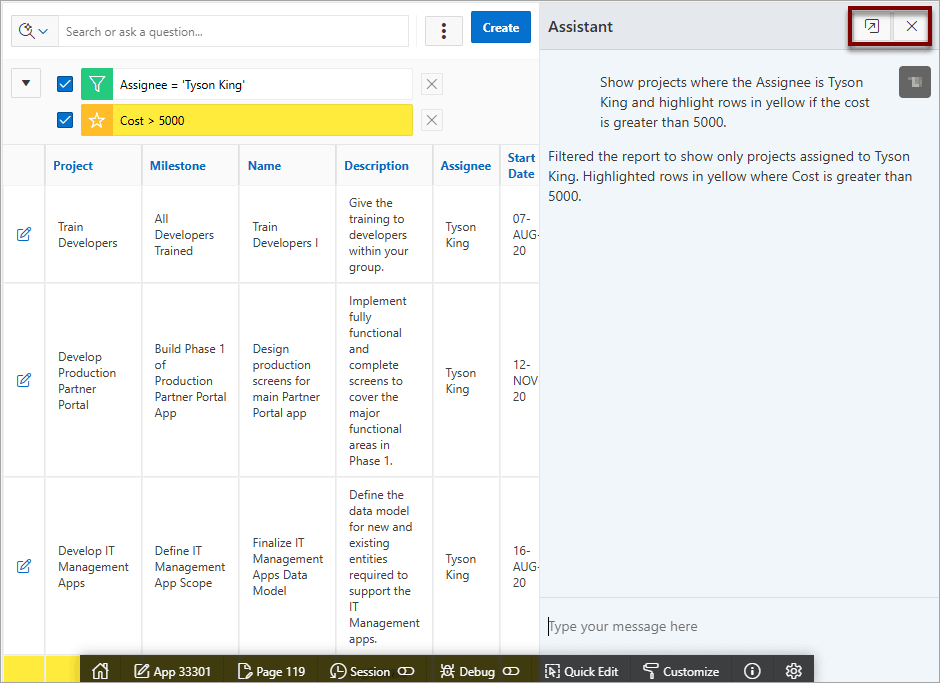

To view the AI Assistant, click the Assistant icon (
Click the Assistant icon.
The AI Assistant appears to the right of the report. Note the previously entered text displays in the AI Assistant window.
Additional AI Assistant controls include:
Detach - Displays the AI Assistant in a separate window on top of the report.
Close Assistant - Closes the AI Assistant window.
To add additional filters, enter more criteria in Type your message here field and press Enter.
