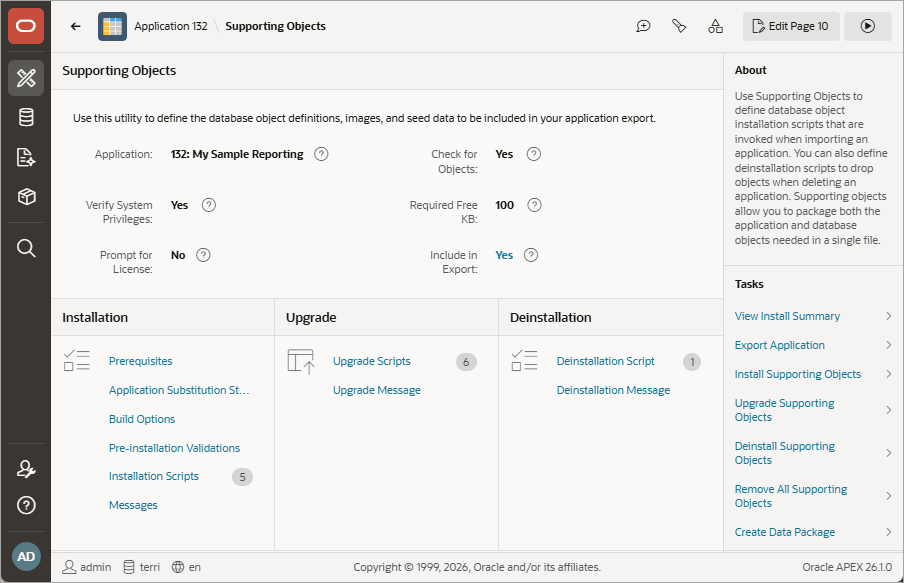

Accessing the Supporting Objects Utility
Create a custom application on the Supporting Objects utility page.
To access the Supporting Objects Page utility:
On the Workspace home page, click App Builder.
Select the application.
The Application home page appears.
Click the Supporting Objects icon.
The Supporting Objects page appears.
Learn about the Supporting Objects page.
The top of the Supporting Objects page displays the application name and indicates current selections for the following: Check for Objects, Verify System Privileges, Required Free KB, Prompt for License, and Include in Export. To learn more about these options, see field-level Help.
To specify whether to include supporting objects with an application export, find Include in Export at the top of the page, click either Yes or No. If you select Yes, a new page appears. From the Include Supporting Object Definitions in Export list, make a new selection and click Apply Changes.
The rest of the page is divided into the following categories: Installation, Upgrade, and Deinstallation.
See Also: Viewing Field-Level and Page Designer Help
