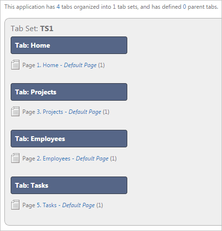

About the Tabs Page
The Tabs page describes the tabs defined in your application.

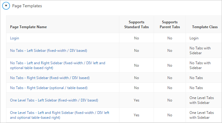

The Page Templates region at the bottom of the page displays a report of page templates associated with the current application. This region is hidden by default. To view it, click the greater than (>) icon to the left of Page Templates.

Prior to creating parent and standard tabs, check that your default template has positions defined for both standard and parent tabs using the appropriate substitution strings.
You also must make sure you do not override this template at the page-level.
To view page templates:
Navigate to the Shared Components page:
On the Workspace home page, click App Builder.
Select an application.
On the Application home page, click Shared Components.
Under Navigation, click Tabs.
The Tabs page appears.
Locate Page Templates at the bottom of the page. If needed, expand the Page Templates region.
See Also:
Using Themes for information about setting a default page template at the application level

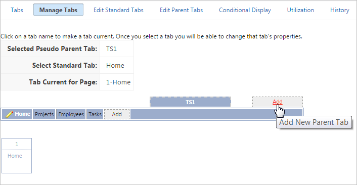

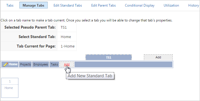

Click Manage Tabs.
To add a Parent tab, click the Add button in the upper row.
A graphical representation of the tabs defined in your application displays.
Parent tabs can control the display of standard tab sets. Clicking a parent tab displays the corresponding standard tab, with the default page as the current page.
To create a Standard tab, click the Add button in the lower row.
The Create Parent Tab or Create Standard Tab Wizard appears.
Follow the on-screen instructions.
