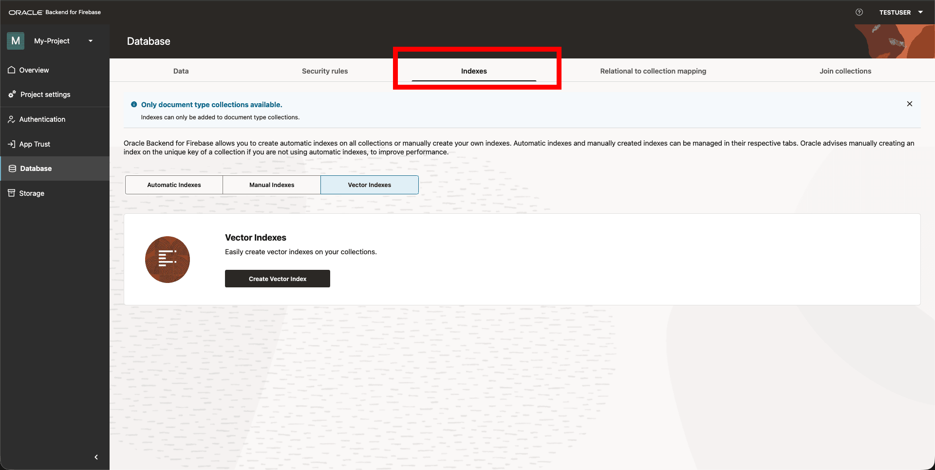

41.2 Console Steps
  1. Open the Database section in the Console.
  2. Navigate to the Indexes tab and click Create Vector Index.
    Figure 41-1 Console: Create Vector Index
  3. Pick the vector column you want to index.
  4. Pick the index type — HNSW or IVF.
  5. Pick the distance metric — COSINE, EUCLIDEAN, or DOT.
