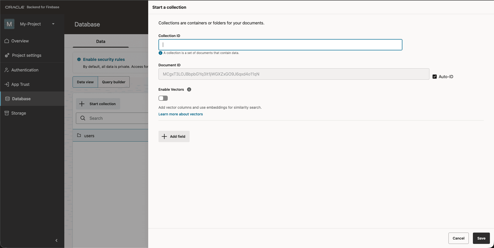

Sign in to the Console and open your project.
Go to Collections and click Create Collection.
Figure 39-1 Console: Create Collection
Give your collection a name.
Turn on the
Enable Vectorstoggle.Figure 39-2 Console: Enable Vectors

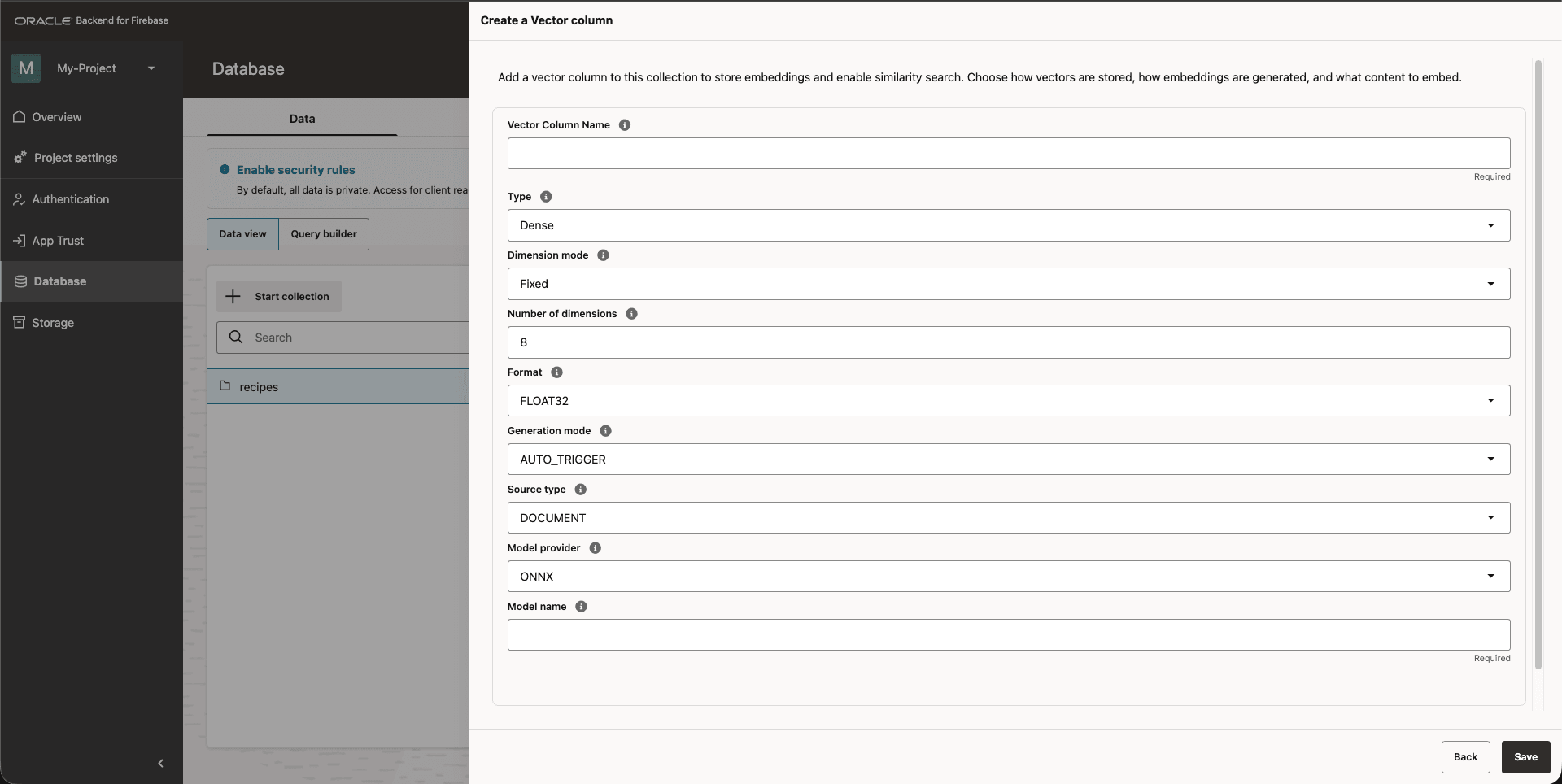

Fill in the column properties using the table in Vector Column Configuration as your guide.
Figure 39-3 Console: Create a Vector Column
If you picked
AUTO_TRIGGERorAUTO_SCHEDULER, fill in the Model and Source sections that appear. -
Click Save to save the column. Repeat for any additional vector columns you want to create.
