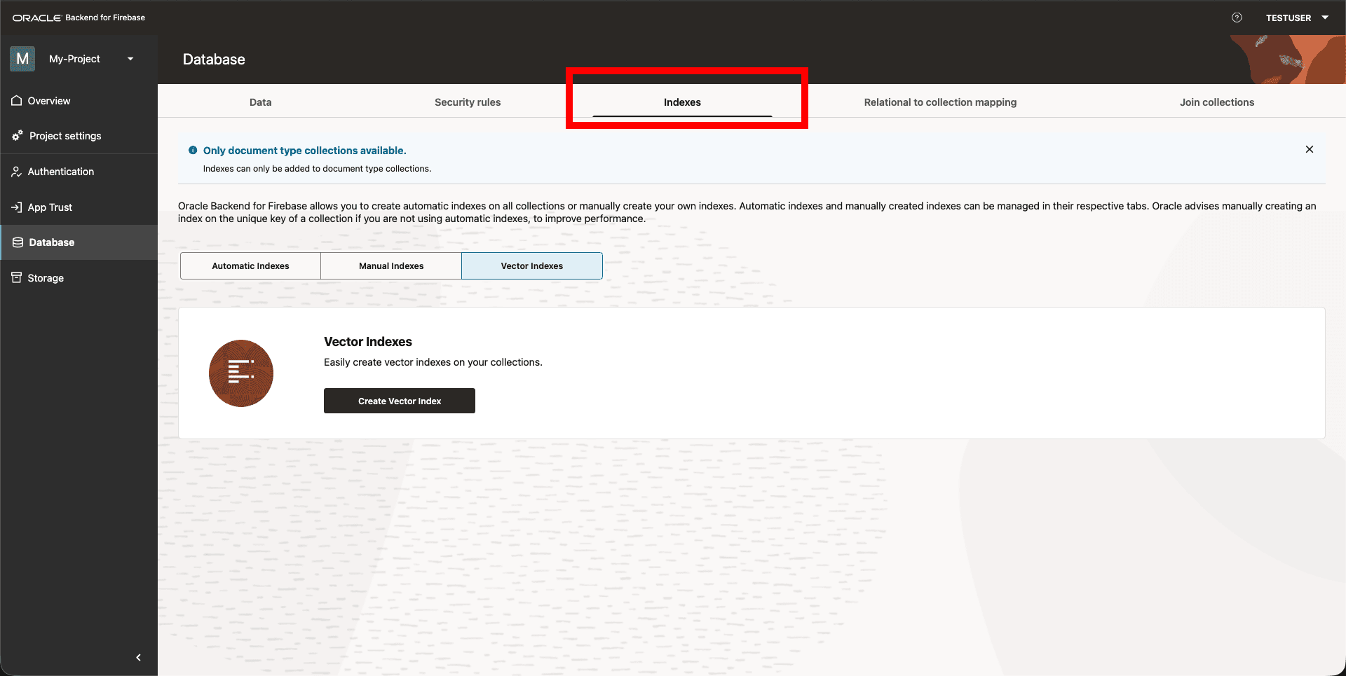

Console Steps
Open the Database section in the Console.
Navigate to the Indexes tab and click Create Vector Index.
Figure 41-1 Console: Create Vector Index
Pick the vector column you want to index.
Pick the index type — HNSW or IVF.
Pick the distance metric — COSINE, EUCLIDEAN, or DOT.
