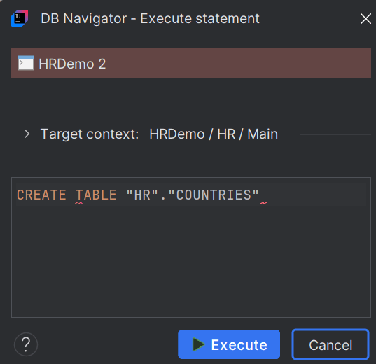

  3. Click the Execute Statement icon either on the left-hand side navigation gutter (icon appears next to the caret) or from the toolbar menu of the SQL editor window.
    The DB Navigator - Execute Statement dialog box displays (if configured) with details of the target database connection, schema, and session where the statement will be executed.

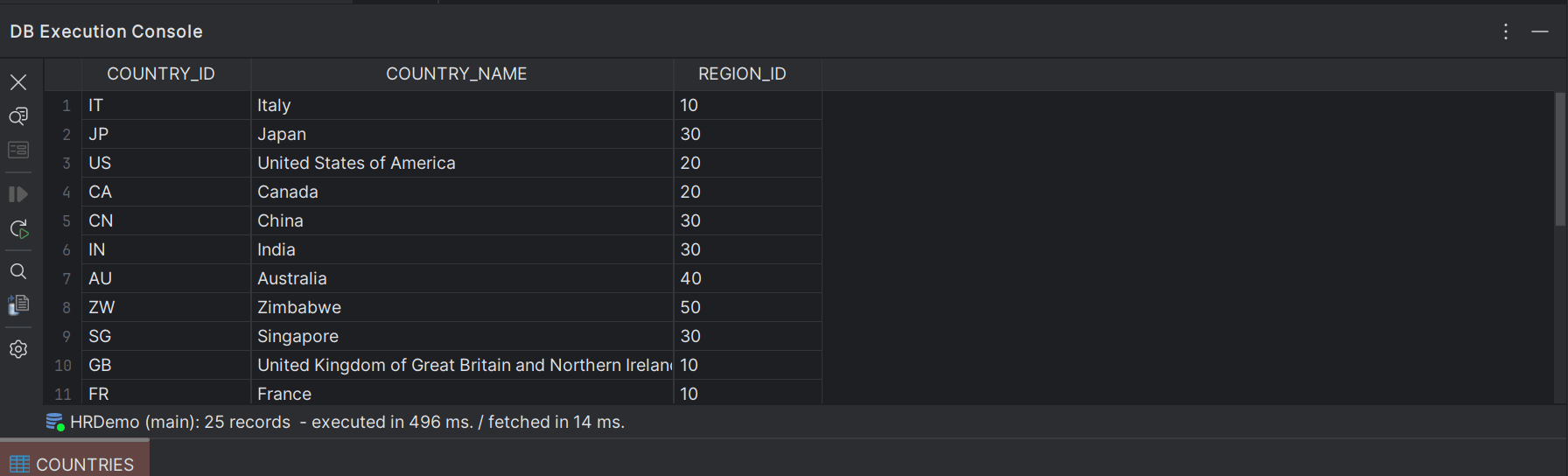

  4. Click Execute.
    The DB Execution Console window opens displaying the results in a dedicated tab. Information about the total number of records fetched and the execution time is displayed. If the execution fails, appropriate error messages also display in the console window.
    Results of Execution in DB Execution Console

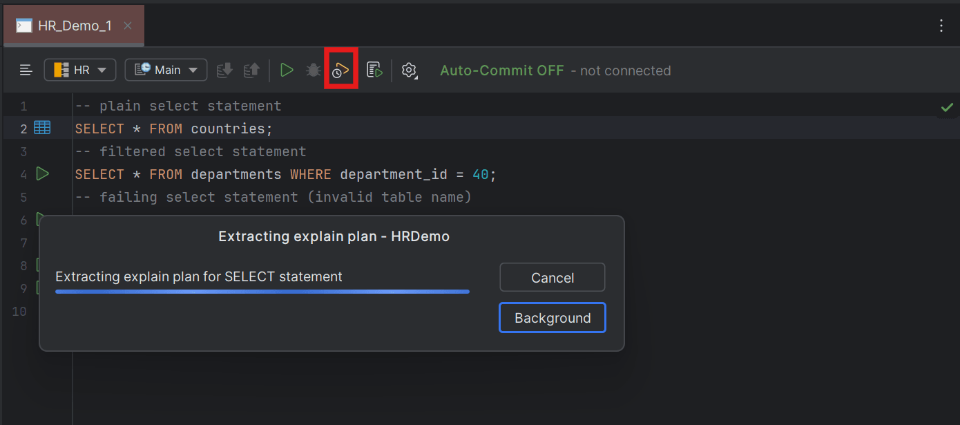

You can also extract and view the execution plan for the SQL statement by clicking the Execute Plan for Statement icon on the editor toolbar menu.
Generation of execution plan of statement in progress
The execution plan provides a complete breakdown of the SQL statement with details of the operation performed, cost in terms of resource utilization, projection and predicates and displays it on the DB Console window.
Execution plan for statement
