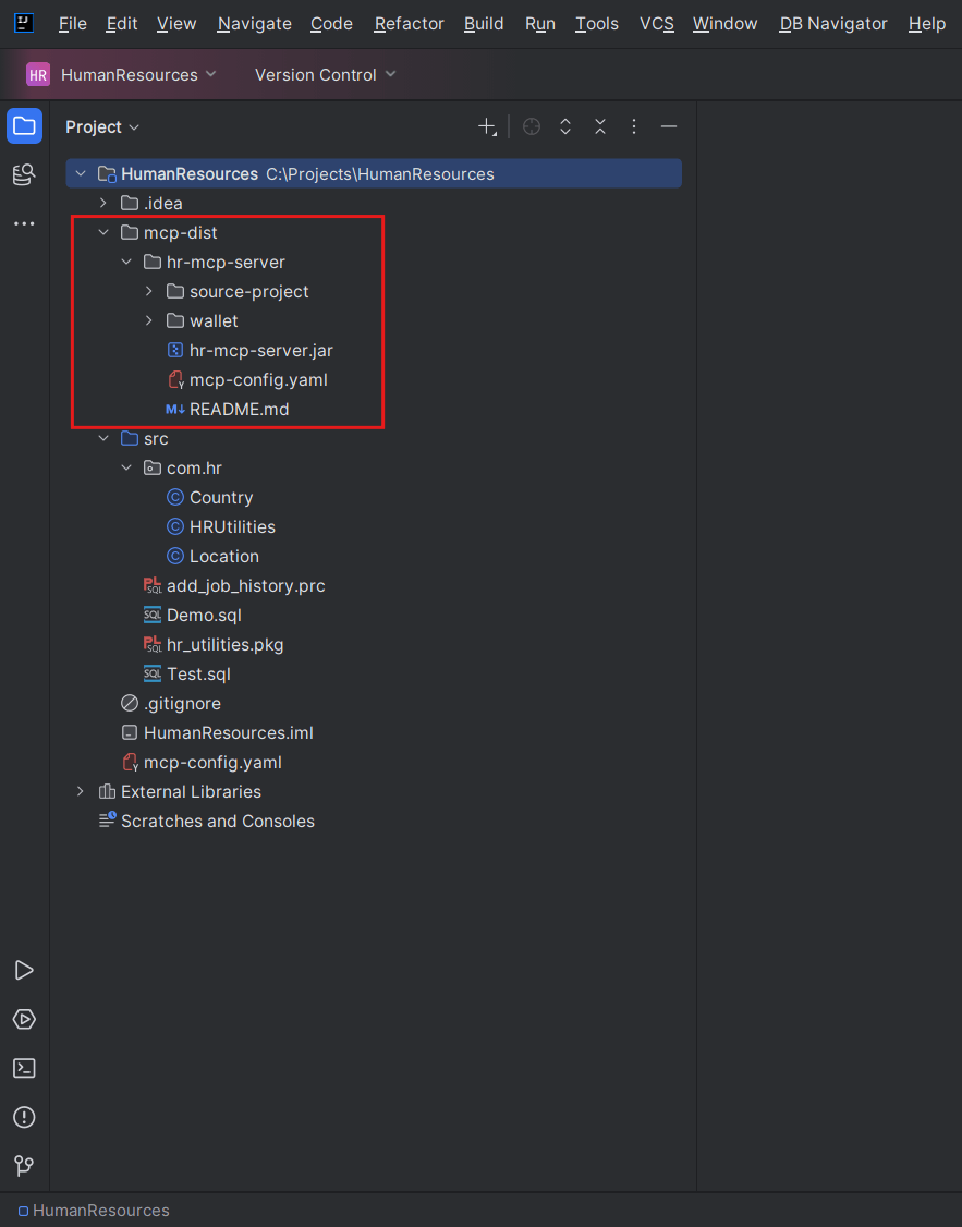

Upon successful completion of the MCP Server build process, the builder generates a deployable MCP server project. The generated artifacts are stored in the output directory you specified during saving the MCP Server configurations. You can access the MCP server project folder under the Project directory of Database Navigator.
MCP Server Builder Project components
Following are the components the MCP server build that are generated:
MCP Build Output Component Purpose Location
Runnable JAR Starts the generated MCP server. <project>/mcp-dist/<server-name>/<server-name>.jar
Runtime Configuration Contains transport, database URL, and tool definitions. <project>/mcp-dist/<server-name>/mcp-config.yaml
Oracle wallet Stores generated Oracle wallet credentials for the server runtime. <project>/mcp-dist/<server-name>/wallet/
Source project Contains Maven project files and generated Java source for customization. <project>/mcp-dist/<server-name>/source-project/
README file Documents run commands, client snippets, credential behavior, and customization. <project>/mcp-dist/<server-name>/README.md

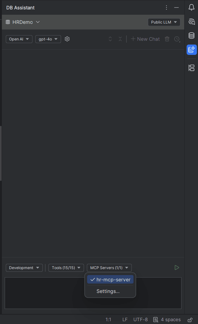

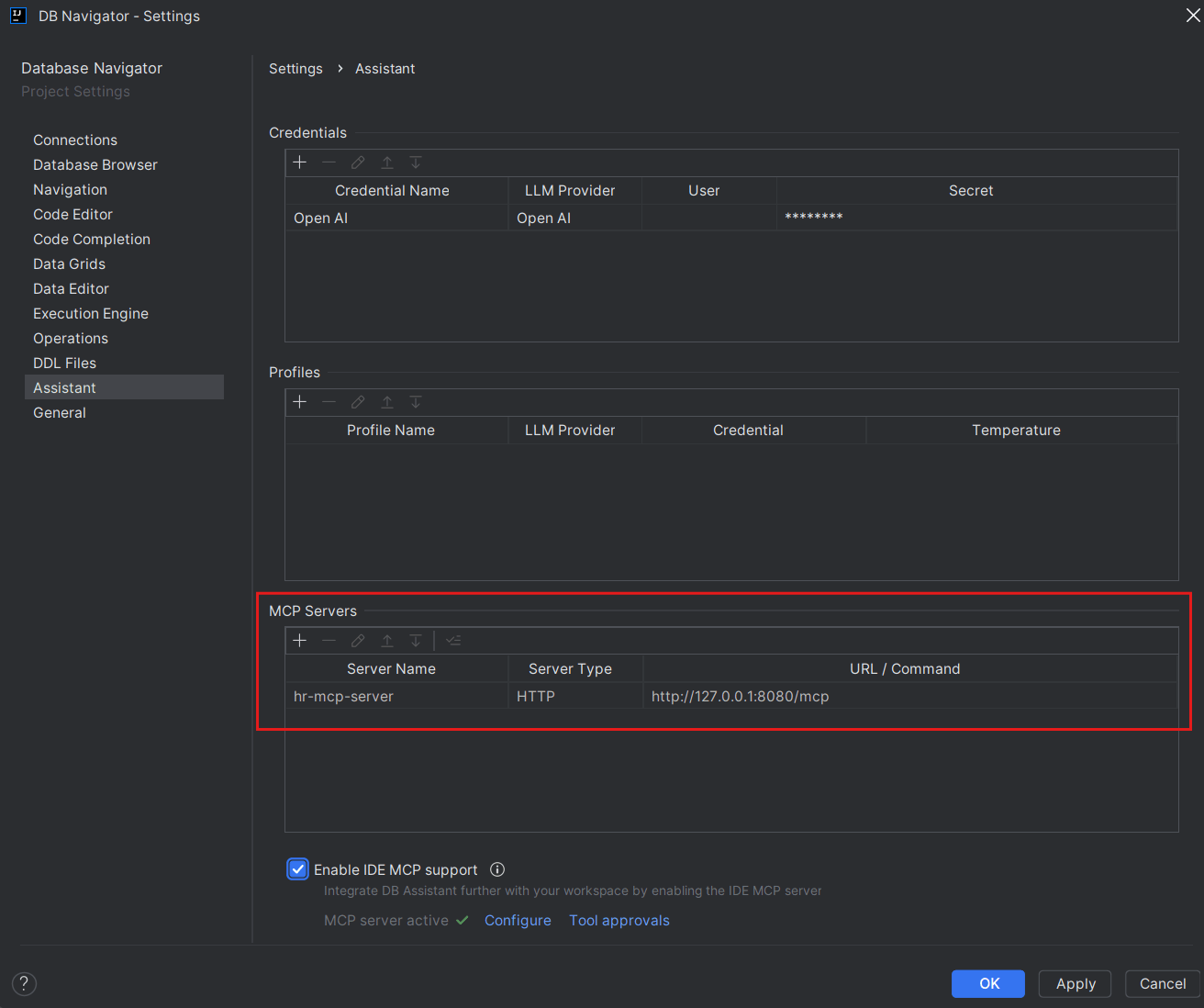

  • DBN Generic Assistant - Optionally consume the generated server after registering it as an HTTP or STDIO MCP server and approving its tools.
For using the MCP server with the DB Assistant module of Database Navigator tool, register the generated server through the Main menu > DB Navigator > Settings > Assistant > MCP Servers settings.
MCP Server build through DBN integrated with DB Assistant
You can then select it from the DB Assistant chat window in Development or Analytics mode.
MCP Server built through DBN available in DB Assistant Servers list
