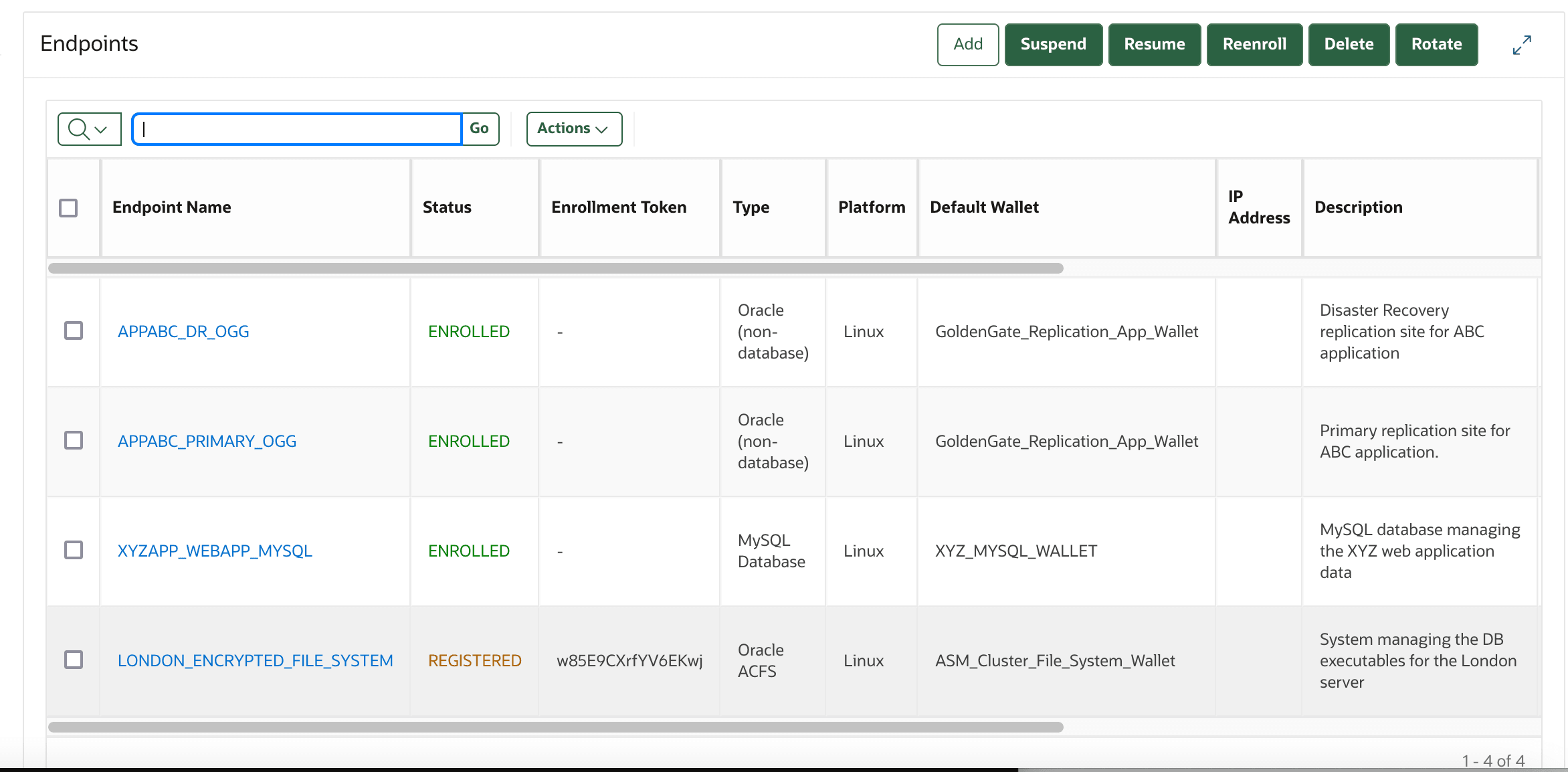

  2. Select the Endpoints tab, then Endpoints in the left navigation bar.
    The Endpoints page appears listing all the Oracle Key Vault endpoints.
    Description of 21.5_endpoint_page.png follows
    The Endpoints page displays the list of registered and enrolled endpoints with the following endpoint details: name, type, description, platform, status, enrollment token, alert, endpoint certificate expiration, common name of certificate issuer, and last active time. This listing of endpoints depends on who is logged in. The endpoint information listing depends on who is logged-in, some details such as the enrollment token, and the buttons listed above the table on Endpoints page may be visible depending on the user's role or privilege status. For example, a user with the System Administrator role can see buttons related to all operations such as Add, Suspend, and Resume, while one with only the Create Endpoint privilege can see only the Add button. The endpoint status can be either Registered or Enrolled:
    • Registered Status: The endpoint has been added and the one-time enrollment token has been generated. This token will be displayed in the corresponding Enrollment Token column.
    • Enrolled Status: The one-time enrollment token has been used to download the endpoint software. The Enrollment Token column displays a dash (-) to indicate that the enrollment token has been used. If you do not have the System Administrator role (that is, you have the Manage Endpoint privilege), then you can only view enrollment tokens for those endpoints that you can manage.
    • Created By: The user who created the endpoint. If the user no longer exists, or if the endpoint was created in a version before this information was stored, then this field will show ANONYMOUS.
    • Creator Node: The node on which the endpoint was created. This is specific to multi-master cluster environments.
    • Name Status: The state of the endpoint. The state will be either ACTIVE or PENDING. This is specific to multi-master cluster environments.
    • Cluster Subgroup: The subgroup on which the endpoint was created. This is specific to multi-master cluster environments.

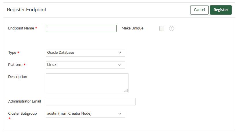

  3. On the Endpoints page, click Add.
    The Register Endpoint page appears. The Make Unique check box and Cluster Subgroup drop-down only appears in multi-master cluster mode.
    Description of 21_add_endpoint.png follows
  4. In the Endpoint Name field, enter a name for the endpoint.
  5. If you are using a multi-master cluster, then choose whether to select the Make Unique checkbox.
    Make Unique helps to control naming conflicts with names across the multi-master cluster environment. Endpoints that were created before an Oracle Key Vault conversion to a cluster node are not affected by naming conflicts.
    • If you select Make Unique, then the endpoint will be active immediately and users can use this endpoint.
    • If you do not select Make Unique, then the endpoint will be created in the PENDING state. Oracle Key Vault will then begin a name resolution operation and may rename the endpoint to a name that is unique across the cluster. If there is a naming collision, then the collision will be reported on the Conflicts page on any node in the cluster. The endpoint will then be renamed to a unique name. You will need to go to a read/write node of the cluster and either accept the renamed endpoint or change the endpoint name. If you change the endpoint name, then this will restart the name resolution operation and the endpoint will return to a PENDING state. An endpoint in the PENDING state cannot be used to perform most operations.
  6. From the Type drop-down list, select the type of endpoint.
    Supported types are Oracle Database, Oracle Database Cloud Service, Oracle (non-database), Oracle ACFS, MySQL Database, SSH Server, and Other. An example of Other is a third-party KMIP endpoint. If you are using Oracle Advanced Security Transparent Data Encryption (TDE) and want to use Oracle Key Vault to manage a TDE master encryption key or wallet, then you must set Type to Oracle Database.
  7. Complete the following endpoint information:
    • Platform: Supported platform choices are Linux, Linux for Arm (aarch64), IBM: Linux on System z, Solaris SPARC, Solaris x64, AIX, HP-UX, and Windows.
    • Description: Optionally, enter a useful identifying description such as the host name, IP address, function, or location of the endpoint.
    • Administrator Email: Optionally, enter the email address of the endpoint manager to have the enrollment token and other endpoint-related alerts sent directly from Oracle Key Vault. You must have SMTP configured to use the email notification feature.
    • Cluster Subgroup: For a multi-master cluster environment, select a subgroup for the endpoint. If you select No Cluster Subgroup, then the endpoint will not be a part of any cluster subgroup. If you select the option suffixed with (from Creator Node), the endpoint will be a part of the cluster subgroup to which its creator node belongs, even if the creator node's cluster subgroup changes. All other options assign an endpoint to an existing cluster subgroup, to which it will belong regardless of its creator node's cluster subgroup.
    • SSH Server Hostname: For type SSH Server, enter the hostname or the IP address of the SSH server host on which the Oracle Key Vault Secure Shell (SSH) endpoint will be deployed.
  8. Click Register.
    The Endpoints page appears listing the new endpoint with a status of Registered. The Enrollment Token column displays the one-time enrollment token.

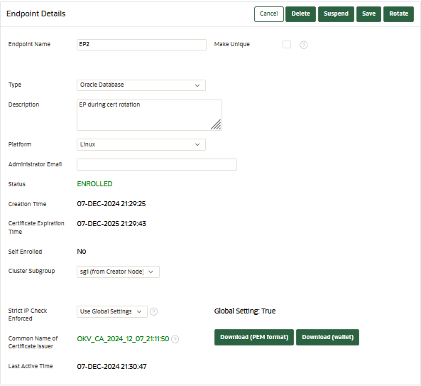

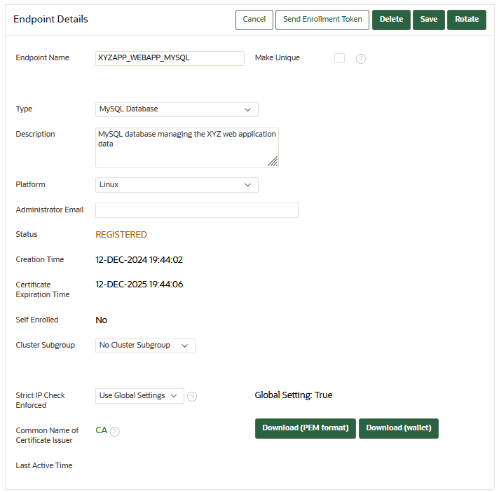

  9. Click the endpoint name to see details for the endpoint.
    The Endpoint Details page appears.
    Description of 2110_endpoint-details.png follows
    The Send Enrollment Token button on the Endpoint Details page only appears for an endpoint whose Status is Registered. The users with the System Administrator role or the Manage Endpoint privilege for the endpoint can view an Endpoint's enrollment token, or Send Enrollment Token button.
    There are two ways to send the one-time enrollment token to the endpoint manager:
    • If you did configure SMTP and entered the email address, you can have Oracle Key Vault send the enrollment token directly to the endpoint manager, shown in the next step, where you click the Send Enrollment Token button.
    • If you did not configure SMTP or enter the email address, then you must use an out-of-band method to send the enrollment token to the endpoint manager.
    The endpoint must be enrolled and the endpoint jar file must be downloaded from the node on which the endpoint was most recently created or reenrolled.
  10. Click Send Enrollment Token.
    At this stage, the endpoint’s administrator can complete the enrollment process for the endpoint. When the enrollment token is used to download and install the endpoint software on the endpoint side, the endpoint status changes from Registered to Enrolled.

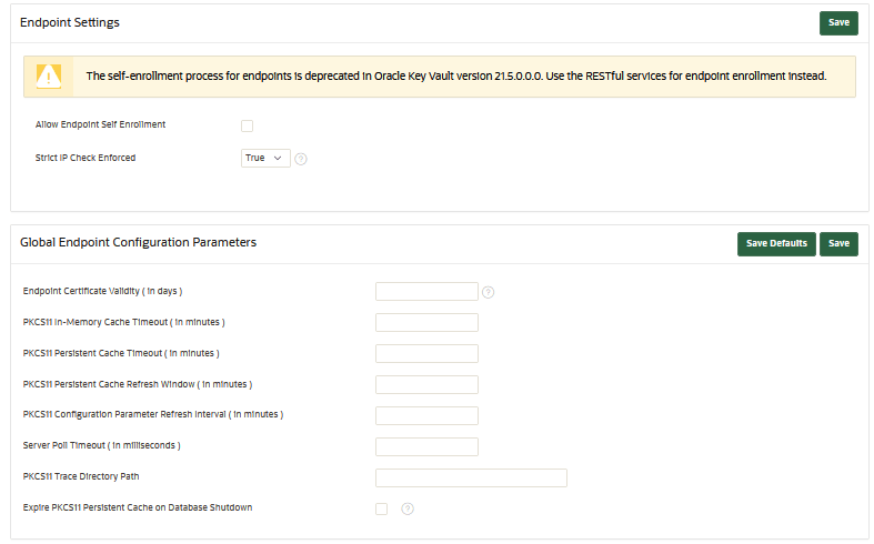

12.2.4 Adding Endpoints Using Self-Enrollment
The self-enrollment process immediately sends the endpoint to the Enrolled status without the intermediate Registered status.
12.2.4.1 About Adding Endpoints Using Self-Enrollment
Oracle Key Vault associates a self-enrolled attribute with all endpoints that are enrolled through endpoint self-enrollment.
Self-enrolled endpoints go directly to Enrolled status without the intermediate Registered status when a user downloads the endpoint software. You can recognize self-enrolled endpoints by their system generated names in the format ENDPT_001. In a multi-master cluster, system generated endpoint names are in the format ENDPT_node_id_sequential_number, where node_id is a value such as 01 or 02. For example, ENDPT_01_001 can be the generated name of an endpoint.
Endpoint self-enrollment is disabled by default and must be enabled by a user who has the System Administrator role.
A best practice is to enable endpoint self-enrollment for limited periods when you expect endpoints to enroll. After the expected endpoints have been enrolled, you should disable endpoint self-enrollment.
The self-enrollment process for endpoints is deprecated in Oracle Key Vault 21.5. You can use the RESTful services utility for endpoint enrollment instead.
12.2.4.2 Adding an Endpoint Using Self-Enrollment

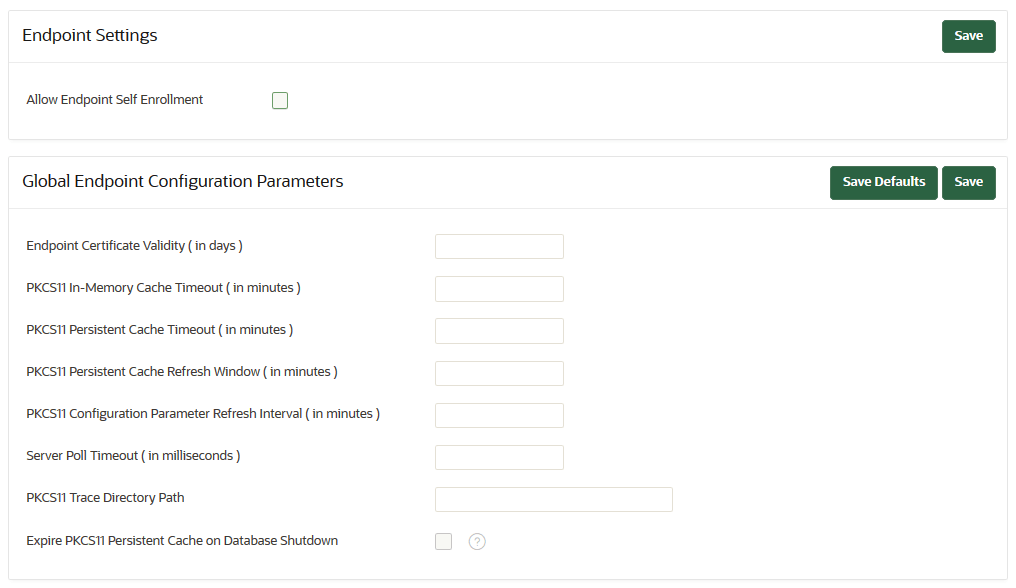

You can configure the self-enrollment process for endpoints from the Oracle Key Vault management console.
  1. Log in to the Oracle Key Vault management console as a user who has the System Administrator role.
  2. Select the Endpoints tab, and then Settings from the left navigation bar.
  3. Check the box to the right of Allow Endpoint Self-Enrollment.
  4. Click Save.

When you suspend an endpoint, its status will change from Enrolled to Suspended. You cannot suspend an endpoint that is in the PENDING state unless you are the user who created it.
  1. Log in to the Oracle Key Vault management console as a user who has the System Administrator role or the Manage Endpoint privilege.
    A user with the Manage Endpoint privilege can only suspend endpoints that they can manage.
  3. In the Endpoints page, select the check boxes to the left of the endpoints that you want to suspend.
  4. Click Suspend.
  5. In the confirmation window, click OK.
    When you suspend an endpoint, its Status on the Endpoints page will be Suspended.
  6. To enable the endpoint, perform Steps 1-3.
    From the Endpoint Details pane click Enable. The endpoint Status on the Endpoints page will now read Enrolled.

12.2.5.5 Reenrolling an Endpoint
When you reenroll an endpoint, the enrollment process automatically upgrades the endpoint software and also generates new endpoint certificates.
You must also reenroll an endpoint to accommodate changes such as pairing a primary Oracle Key Vault server with a new secondary server in a primary-standby configuration. The action of reenrolling an endpoint will immediately disallow any connections from the endpoint's old deployment. If you are reenrolling an endpoint, Oracle recommends that you immediately download okvclient.jar and deploy it in a directory that is separate from the existing deployment. When you deploy the software, use the -o option to overwrite the symbolic link pointing to the old okvclient.ora. You cannot reenroll an endpoint that is in the PENDING state unless you are the user who created the endpoint.
    A user who has the Manage Endpoint privilege can only reenroll endpoints that he or she created.
  3. In the Endpoints page, check the boxes to the left of the endpoints that you want to reenroll.
  4. Click Reenroll.
    A new enrollment token will be generated for each reenrolled endpoint and appear in the corresponding Enrollment Token column. You can use this one-time token to reenroll the endpoint. You must download the endpoint jar file from the same node on which the endpoint was reenrolled.
    After you deploy the okvclient.jar file, the message
The endpoint software for Oracle Key Vault installed successfully
should appear. If, instead, the message
The endpoint software for Oracle Key Vault upgraded successfully
appears, then the re-enrollment was performed in the old deployment directory, and as a result, the endpoint software was upgraded but not successfully re-enrolled.
    You can overwrite the symbolic link reference that points to okvclient.ora in the new directory by using the okvclient.jar option -o.
12.2.5.6 Rotating Endpoint Certificates
Rotating an endpoint's certificate extends its certificate validity without incurring downtime for the endpoint.
Endpoints communicate with Oracle Key Vault using TLS certificates. When an endpoint’s certificate is close to expiration, you can rotate the endpoint so that it is issued with a new certificate without incurring downtime.
You can determine the remaining time to expiration of the endpoint certificate from the Oracle Key Vault Management console, by navigating to the Endpoints page and checking the Endpoint Certificate Expiration field.
You can also monitor the expiration of an endpoint certificate by configuring the Endpoint Certificate Expiration alert so as to receive a reminder when an endpoint certificate is due to expire.
If an endpoint is not rotated before its certificate expires, it will experience downtime. You must re-enroll the endpoint when that happens.
You can rotate a single endpoint, or multiple endpoints at once. Rotating an endpoint generates a new certificate on Oracle Key Vault. The endpoint must then reach out to Oracle Key Vault to receive this new certificate, and subsequently acknowledge receipt of the certificate back to Oracle Key Vault to fully complete the certificate rotation.
In Oracle Key Vault release 21.9, after a certificate rotation, password-protected endpoints may fail to connect to the Oracle Key Vault deployment, with Server Connect Failed errors. A fix for this issue is available as a patch for bug 37006283. Apply this patch to the Oracle Key Vault deployment before rotating the endpoint certificates.
To rotate the endpoint certificates, perform the following steps.
  1. Log into the Oracle Key Vault management console as a user with the System Administrator role, or the Manage Endpoint privilege on the given endpoint(s).
  3. In the Endpoints page, check the boxes to the left of the endpoints that you want to rotate.
  4. Click Rotate.
    This process can take several minutes to complete, depending on the number of endpoints that are being rotated. After a few minutes, the message “One or more endpoints rotated successfully” appears. For each rotated endpoint, the Common Name of Certificate Issuer field on the Endpoints page is changed to Updating to Current Certificate Issuer. In the backend, Oracle Key Vault has generated a new certificate for each rotated endpoint.
    An endpoint that has been rotated will receive its new certificate the next time that it reaches out to Oracle Key Vault. In a multi-master cluster, the endpoint must reach out to the Oracle Key Vault cluster node on which the endpoint certificate was rotated in order to receive the new certificate. After the endpoint has received its new certificate, it must acknowledge receipt back to Oracle Key Vault. When that happens, the endpoint is considered to have completed rotation, and its Common Name of Certificate Issuer is changed from Updating to Current Certificate Issuer to the common name of the current Oracle Key Vault CA certificate. Its Endpoint Certificate Expiration field should show the new expiration date of its certificate.
    • When one or more endpoints are rotated, a banner with the message Certificate Rotation In Progress is displayed on the Endpoints page. In a multi-master cluster, this banner is displayed on the Endpoints page of all cluster nodes. It remains until all rotated endpoints successfully receive and acknowledge receipt of their new certificate, that is, complete certificate rotation. You can check how many endpoints are still being rotated through the Common Name of Certificate Issuer field on the Endpoints page. For any endpoints that have not yet completed the rotation, this field will continue to display Updating to Current Certificate Issuer.
    • In a multi-master cluster environment, the endpoint will receive its new certificate only when it reaches out to the cluster node on which its certificate was rotated. Since the endpoint can communicate with any node in the endpoint node scan list, the endpoint may run many operations before it reaches the rotating node and receives its certificate. The endpoint also has to acknowledge the receipt of the new certificates by reaching out to a node in the cluster.
    • The endpoint certificate rotation times increases with the number of nodes in the cluster. The endpoints prioritize the nodes in the local subgroup, hence consider rotating the endpoint certificate on a node in its cluster subgroup.
    • In a multi-master cluster environment, an endpoint must reach out to the rotating node to receive its new certificate. In a cluster with many nodes, the endpoint may reach out to any node in the scan list. If this happens during certificate rotation, then the endpoint makes a best-effort attempt to also reach out to the rotating node in order to receive its new certificate in as few operations as possible. However, depending on the number of nodes in the cluster and the periodicity with which the endpoint reaches out to Oracle Key Vault, the endpoint certificate rotation can take a long time to complete. Oracle recommends that you rotate the endpoint certificate well ahead of its expiration in order to avoid re-enrolling the endpoint, which would incur downtime.
    • In a multi-master cluster environment, to view the endpoint's rotating node, navigate to the Endpoints page, and from the Actions drop-down list, select Select Columns. Add the Rotating Node column to the list of columns to display, and click Apply. Alternatively, the rotating node is also visible on the Endpoint Details page for a given endpoint.
      The rotating node can be viewed on the Endpoints and Endpoint Details pages only while a certificate rotation is in progress.
    • When an endpoint is rotated, the validity of its new certificate depends on the Endpoint Certificate Validity configuration parameter of the Oracle Key Vault deployment, and on the remaining time to expiration of the Oracle Key Vault CA certificate.

12.3 Managing Endpoint Details
Endpoint details refers to endpoint name, type, description, platform, and email, and adding the endpoint to a group, or upgrading the endpoint software.
12.3.1 About Endpoint Details
The Endpoint Details page provides a consolidated view of the endpoint.
To access this page, you can select the Endpoints tab and then click the name of an endpoint. From here you can modify endpoint details and complete endpoint management tasks. (The following screen shows a partial view.)
Description of 2110_endpoint_details.png follows
12.3.2 Modifying Endpoint Details
You can modify the endpoint name, endpoint type, description, platform, and email.
In a multi-master cluster, endpoint details can only be modified while the endpoint is in the PENDING state by the creator on the node on which it was created.
    A user who has the Manage Endpoint privilege can only modify endpoints that this user has created. To see which endpoints that a user can manage, select the Users tab, then select Manage Users. Check the User Details page for the user in question, and scroll down to the Access to Endpoints area.
  3. In the Endpoints page, click the name of the endpoint.
  4. In the Endpoint Details page, modify any of the following: Endpoint Name, Type, Description, Platform, Administrator Email, Cluster Subgroup (for multi-master cluster environments only), or Strict IP Check Enforced.
    The Strict IP Check Enforced setting is set to Use Global Settings by default for any endpoint that was created in Oracle Key Vault. If you modify this option to True, then Oracle Key Vault checks if the endpoint is connecting to it using the same IP that was used when the endpoint software was first deployed. If you modify this option to False, then Oracle Key Vault allows the endpoint to connect to it using any IP address. The global settings can be modified from the Global Endpoint Settings page. Oracle recommends that you set the effective endpoint setting to True (either through Global Endpoint Settings or Local Endpoint Settings) unless otherwise required.
  5. Click Save.

12.4.2.1 Setting Global Endpoint Configuration Parameters
You can set global endpoint configuration parameters in the Oracle Key Vault management console.
  3. In the Endpoint Settings section, configure the following settings:
    • Allow Endpoint Self Enrollment: This check box allows endpoints to be self-enrolled from the software download page.
    • Strict IP Check Enrolled: This selection enables or disables the strict IP check for connections for all endpoints to the server/node (unless they have their own per-endpoint setting configured). Selecting the value False allows the endpoint to connect to Oracle Key Vault using an IP address different from the one used at the time of endpoint provisioning.
  4. The Allow Endpoint Self Enrollment check box.
  5. The Strict IP Check Enforced drop-down with True and False options.
  6. In the Global Endpoint Configuration Parameters section, configure the following settings:
    • Endpoint Certificate Validity ( in days ): Specify the number of days for which the current endpoint certificate is valid. Valid settings are 365 through 1095. The default is 365. When the endpoint enrolled, the endpoint certificate validity period will always be less than the CA certificate validity period.
    • PKCS 11 In-Memory Cache Timeout ( in minutes ): Specify the duration in minutes for which the master encryption key is available after it is cached in the in-memory cache.
      PKCS 11 Persistent Cache Timeout ( in minutes ): Specify the duration in minutes for which the master encryption key is available after it is cached in the persistent master encryption key cache.
    • PKCS 11 Persistent Cache Refresh Window ( in minutes ): Specify the duration in minutes to extend the period of time for which the master encryption key is available after it is cached in the persistent master encryption key cache.
    • PKCS11 Configuration Parameter Refresh Interval ( in minutes ): Specify the frequency at which a long-running process will re-read the okvclient.ora configuration file.
    • Server Poll Timeout ( in milliseconds ): Specify a timeout in seconds for a client's attempt to connect to an Oracle Key Vault server, before trying the next server in the list. The default value is 300 (milliseconds). In Oracle Key Vault clients first establish a non-blocking TCP connection to Oracle Key Vault to quickly detect unreachable servers. After the first attempt, the client makes a second and final attempt to connect to the server but this time waits for twice as long as the duration specified by the SERVER_POLL_TIMEOUT parameter. This is done to overcome possible network congestion or delays.
    • PKCS 11 Trace Directory Path: Specify a directory to save the trace files.
    • Expire PKCS11 Persistent Cache on Database Shutdown: Enables or disables the PKCS#11 persistent cache for a given endpoint database to automatically expire upon shutdown of the endpoint database.
    If the Global Endpoints Configuration Parameters values are empty, it indicates that the manually customized values in the okvclient.ora file are in effect. After you set these values in the Oracle Key Vault management console, you must edit these values from the Oracle Key Vault management console only. You cannot set empty values.
  7. Click Save.

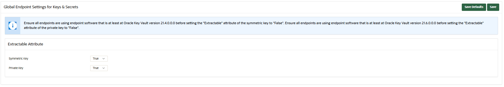

12.4.2.2 Configuring Global Endpoint Settings for Keys and Secrets
You can set the default extractable attribute value for new symmetric keys that you create or register in the endpoint configuration.
  1. Log in to the Oracle Key Vault management console as a user who has the Key Administrator role.
    The Endpoint Settings page appears.
  3. Scroll down to the Global Endpoint Settings for Keys & Secrets section.
  4. From the Symmetric Key menu, select one of the following choices:
    • True (default) allows the object value to be extracted from Oracle Key Vault.
    • False prevents the object value from being extracted from Oracle Key Vault.
  5. From the Private Key menu, select one of the following choices:
  6. Save these settings using the following choices:
    • Save Defaults sets the default value (of TRUE) which is used as the default value or the extractable attribute.
    • Save sets a value that is used as the default value for the extractable attribute.

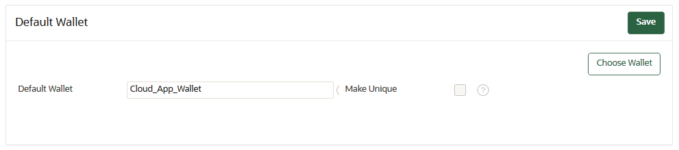

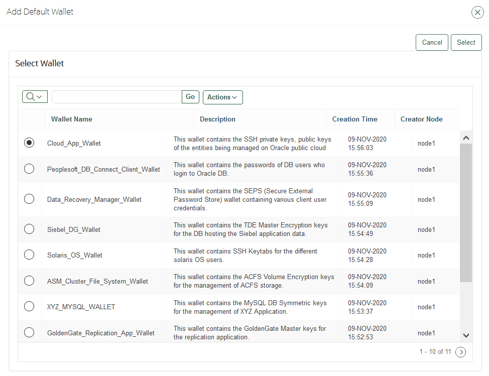

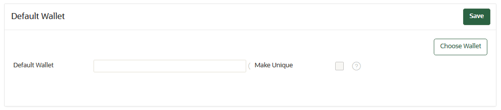

12.5 Default Wallets and Endpoints
You can use a default wallet, which is a type of virtual wallet, with an endpoint.
12.5.1 Associating a Default Wallet with an Endpoint
A default wallet is a type of virtual wallet to which security objects are uploaded when a wallet is not explicitly specified.
Default wallets are useful for sharing with other endpoints such as nodes in an Oracle Real Application Clusters (Oracle RAC), or primary and standby nodes in Oracle Data Guard by having all endpoints use the same default wallet.
If you want to use the default wallet, then you must set this wallet after you register the endpoint before you enroll it. If you decide to use a default wallet after enrollment, then you must remove the default wallet and subsequently reenroll the endpoint.
An enrollment status of registered means that the endpoint has been added to Oracle Key Vault, but the endpoint software has not yet been downloaded and installed. When the status is registered, then you must associate the default wallet with the endpoint.
The endpoint's enrollment status becomes enrolled when you download and install the endpoint software to the endpoint. If you set the default wallet after you enroll the endpoint, then you must reenroll the endpoint to ensure that all future security objects created by the endpoint are automatically associated with that wallet.
In a multi-master cluster, you can only assign the default wallet on the same node where the endpoint and wallet were created when either are still in the PENDING state. After both are in the ACTIVE state, then there are no restrictions. After the default wallet is assigned and the endpoint is enrolled, the default wallet can be accessed from any node, as long as both are in the ACTIVE state and the information has been replicated to that node.
12.5.2 Setting the Default Wallet for an Endpoint
Setting a default wallet for an endpoint automatically uploads the endpoint's security objects to the wallet if another wallet is not explicitly specified.
Oracle requires that you set the default wallet right after registering the endpoint, and before downloading the endpoint software.
  1. Log in to the Oracle Key Vault management console as a user who has the Key Administrator role or the Manage Endpoint privilege.
    If you are logging on as a user with the Manage Endpoint privilege, then you must have full wallet access (Read/Write/Manage Wallet) on the wallet that you want to set as the endpoint's default wallet.
  3. In the Endpoints page, click the name of the endpoint that you want.
  4. In the Default Wallet pane, select Choose Wallet.
    Description of 21_wallet_default_none.png follows
    The Add Default Wallet page appears displaying a list of available wallets.
    Description of 21_wallet_default_select.png follows
  5. Select a wallet from the list to be the default wallet by clicking the option to the left of the wallet, and then click Select.
    The selected wallet name appears in the Default Wallet pane.
    Description of 21_wallet_default_selected.png follows
  6. Click Save.

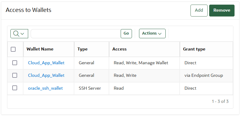

You can grant an endpoint access to a virtual wallet, and revoke or modify access when it is no longer necessary.
12.6.1 Granting an Endpoint Access to a Virtual Wallet
An endpoint must have the Read, Modify, and Manage Wallet privileges on the wallet before security objects can be uploaded or downloaded.
You can grant an endpoint access to a virtual wallet as soon as the endpoint has been added to Oracle Key Vault, when it is still in registered status.
  1. Log in to the Oracle Key Vault management console as an administrator who has the Key Administrator role or the Manage Endpoint privilege on the endpoint.
  3. On the Endpoints page, select the endpoint that must have access to the virtual wallet.
    The Endpoint Details page appears. Scroll down the page to the Access to Wallets pane.
    Description of 217_access_to_wallets1.png follows
  4. In the Access to Wallets pane, which lists the wallets the endpoint already has access to, click Add to add another wallet to this list.
    The Select Wallet page appears. A user with the Manage Endpoint privilege can only view the wallets to which this user has access.
  5. Select a wallet from the available list of wallets shown on the Add Access to Endpoint page.
  6. In the Select Access Level pane, select the appropriate level of access.
  7. Click Save.

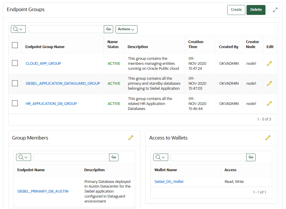

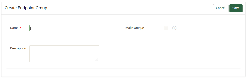

12.7.2 Creating an Endpoint Group
Endpoints that must share a common set of security objects stored in wallets can be grouped into an endpoint group.
For example, endpoints using Oracle Real Application Clusters (Oracle RAC), Oracle GoldenGate, or Oracle Active Data Guard may need to share keys for access to shared data.
  1. Log in to the Oracle Key Vault management console as a user who has the Key Administrator role or the Manage Endpoint Group privilege.
    A user who has the Manage Endpoint Group privilege will only be able to manage the endpoint groups that he or she created.
  2. Select the Endpoints tab, then Endpoint Groups in the left navigation bar.
  3. Click Create.
    The Create Endpoint Group page appears.
    Description of 21_create_endpoint_group.png follows
  4. Enter the name of the new group and a brief description.
    Ensure that you follow the correct naming guidelines for objects.
  5. If you are using a multi-master cluster, then choose whether to select the Make Unique check box.
    Make Unique helps to control naming conflicts with names across the multi-master cluster environment. Endpoint groups that were created before an Oracle Key Vault conversion to a cluster node are not affected by naming conflicts.
    • If you select Make Unique, then the endpoint group will be active immediately and users can use this endpoint group. Clicking Make Unique also displays a list of endpoints that you can add to the endpoint group.
    • If you do not select Make Unique, then the endpoint group will be created in the PENDING state. Oracle Key Vault will then begin a name resolution operation and may rename the endpoint group to a name that is unique across the cluster. If there is a naming collision, then the collision will be reported on the Conflicts page on any node in the cluster. The endpoint group will then be renamed to a unique name. You will need to go to a read/write node of the cluster and either accept the renamed endpoint group or change the endpoint name. If you change the endpoint group name, then this will restart the name resolution operation and the endpoint group will return to a PENDING state. An endpoint group in the PENDING state cannot be used to perform most operations.
  6. Click Save to complete creating the endpoint group.
    The new endpoint group now appears in the Endpoint Groups page.

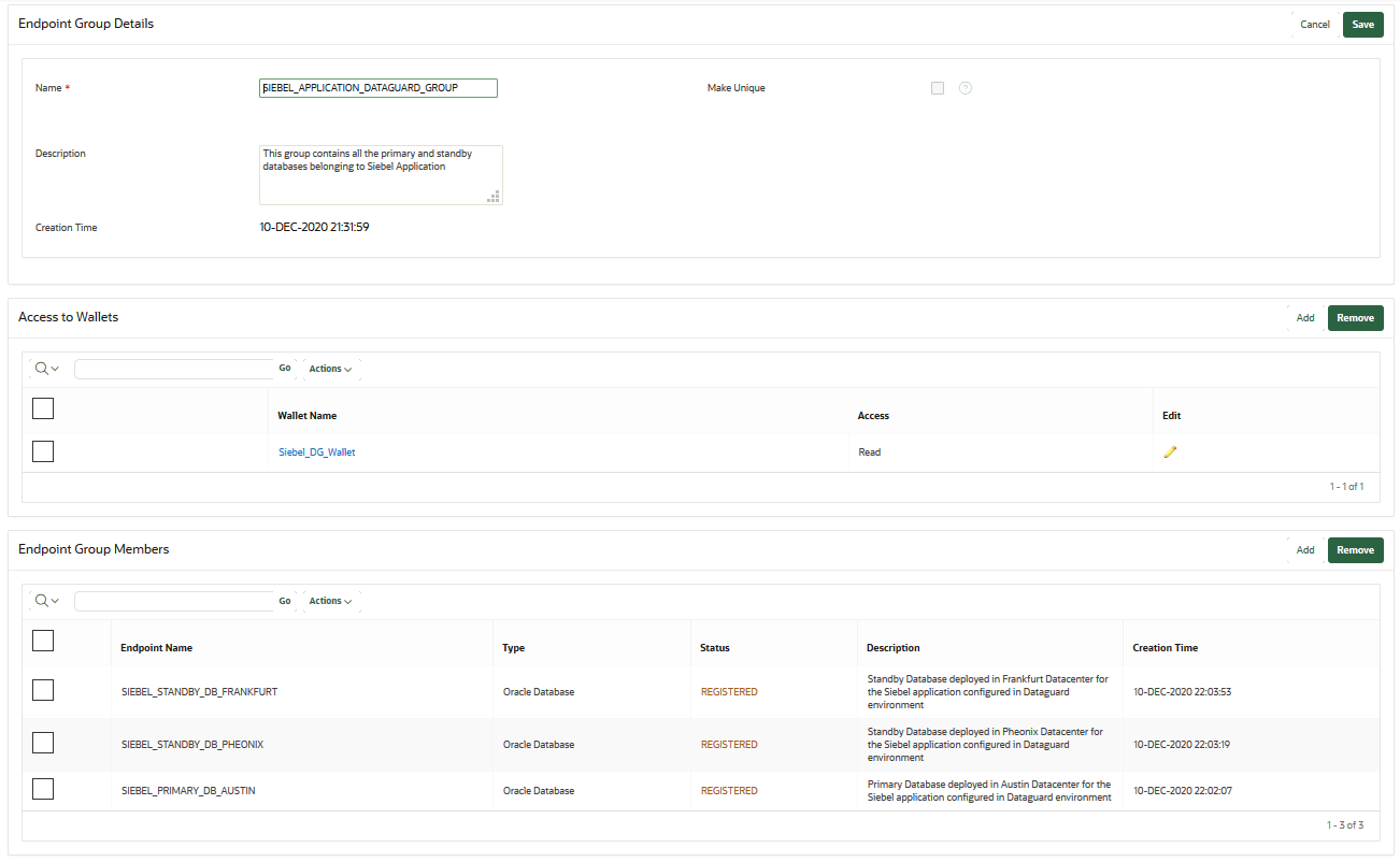

12.7.3 Modifying Endpoint Group Details
You can add endpoints and access mappings to an endpoint group after creating the endpoint group.
An endpoint can belong to more than one endpoint group. You cannot add one endpoint group to another endpoint group.
    A user who has the Manage Endpoint Group privilege can only modify endpoint groups that he or she created.
    The Endpoint Groups page appears.
  3. Click the edit pencil icon in the Edit column corresponding to the endpoint group.
    The Endpoint Group Details page appears.
    Description of 21_endpoint_group_details.png follows
  4. Modify the endpoint name as necessary.
  5. Modify the description as needed.
  6. Add or remove access to wallets or endpoint group members by clicking Add or Remove.
  7. Click Save.

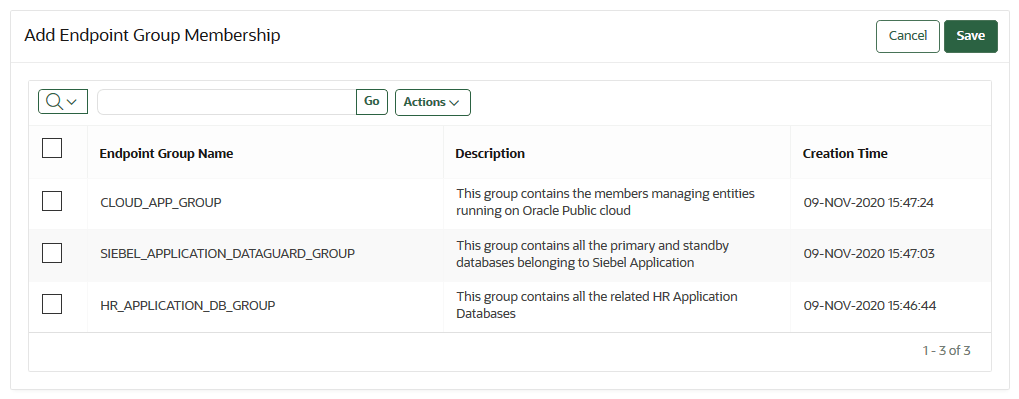

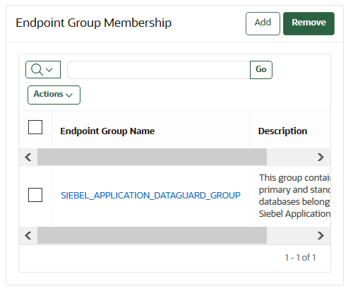

12.7.5 Adding an Endpoint to an Endpoint Group
You can add an endpoint to a named endpoint group.
In a multi-master cluster, you cannot add an endpoint that is in the PENDING state to an endpoint group. Also, you cannot add an endpoint to an endpoint group that is in the PENDING state.
  1. Log in to the Oracle Key Vault management console as an administrator who has the Key Administrator role or Manage Endpoint Group privilege.
    A user who has the Manage Endpoint Group privilege can only add endpoints to endpoint groups that he or she created.
    The Endpoints page appears.
  3. Select the endpoint you want to add to a group.
  4. Scroll to Endpoint Group Membership and then click Add.
    The Add Endpoint Group Membership page appears.
    Description of 21_add_endpoint_group_membership.png follows
    A list of endpoint groups is displayed under Endpoint Group Name.
  5. Check the boxes to the left of the endpoint groups you want to add the endpoint to.
  6. Click Save.
    The Endpoint Group Membership pane displays the checked endpoint group.
    Description of 21_added_endpoint_group_membership.png follows
