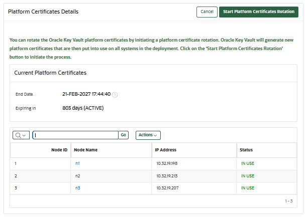

Rotate platform certificates before they expire using the Oracle Key Vault management console.

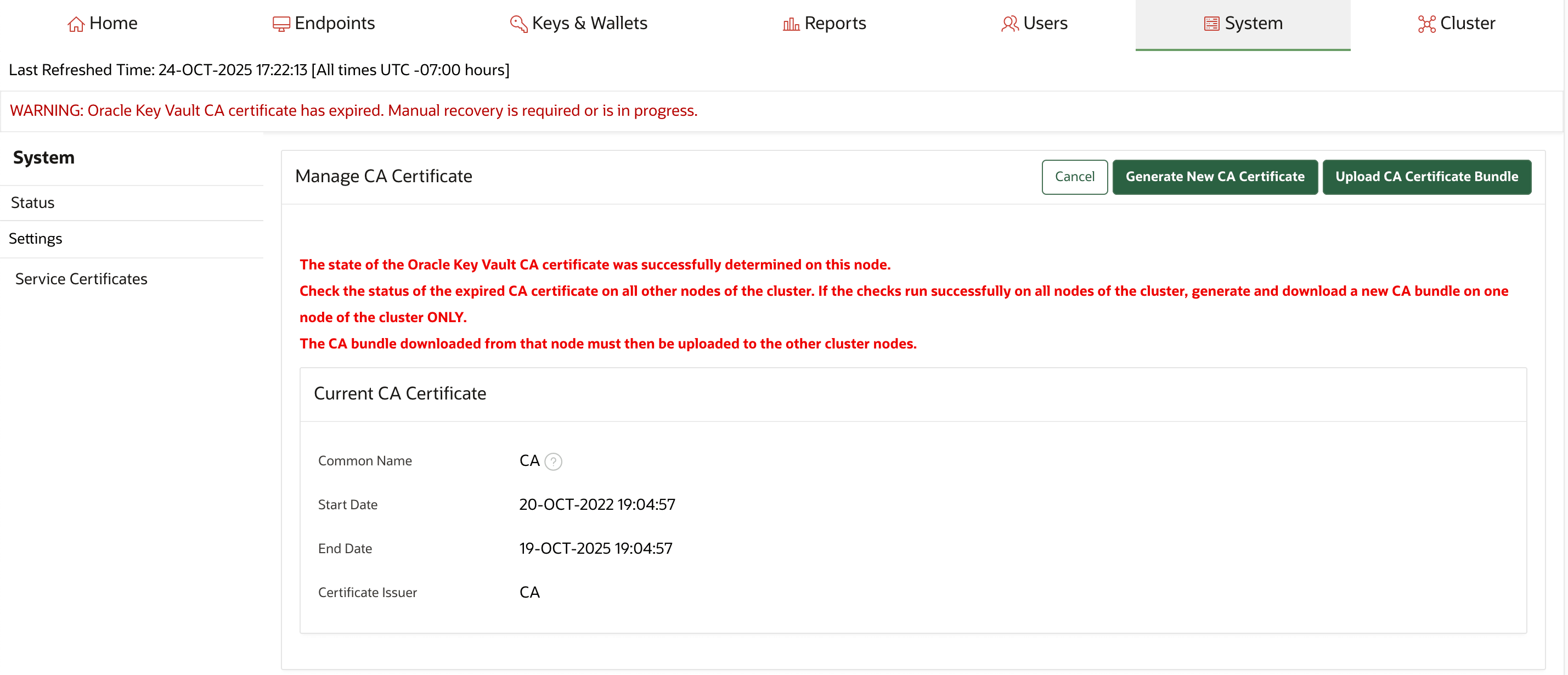

If you do not rotate the CA certificate before it expires, none of the endpoints can communicate with the Oracle Key Vault server or any node of the Oracle Key Vault cluster and all the endpoints will face a downtime. In the cluster deployment none of the Oracle Key Vault nodes will be able to communicate with each other and in case of primary-standby, the communication between primary and standby servers will breakdown.
The CA Certificate must be rotated before it expires to prevent outage to endpoints. Start the CA certificate rotation several weeks in advance of CA certificate expiry to prevent outage to the Oracle Key Vault deployment and endpoints.Rotating CA certificates also rotates the server or node certificates and endpoint certificates.

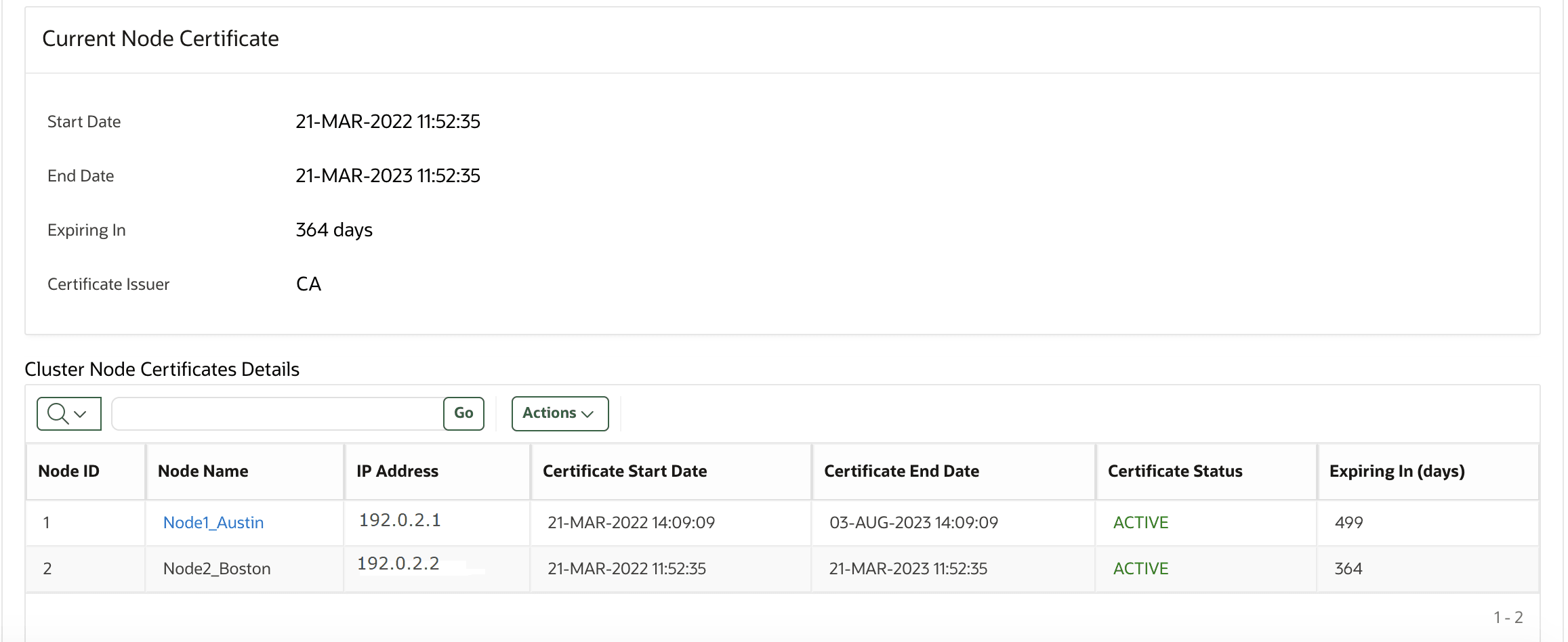

Server or Node Certificate is the TLS certificate of the Oracle Key Vault server or a cluster node. While in a standalone or primary-standby deployment, Oracle Key Vault uses server certificates to communicate with its endpoints. In a multi-master deployment of Oracle Key Vault, each cluster node has its own node certificate. Oracle Key Vault cluster nodes use node certificates to communicate with each other and with the endpoints.
These certificates are referred to as server certificates for standalone and primary-standby systems and as node certificates in multi-master cluster configurations. The Oracle Key Vault CA certificate is used to issue these certificates.
Rotate the server or node certificate before they expire as described in section Managing Server Certificates and Node Certificates Rotation. The CA and endpoint certificates are not rotated when server or node certificates are rotated.
Rotating the node certificate in a multi-master cluster deployment is a per-node operation.If the server certificate is not rotated in a standalone deployment before it expires, none of the endpoints can communicate to the Oracle Key Vault server and all the endpoints will face a downtime. If you do not rotate the server certificate in a primary-standby deployment before it expires, then none of the endpoints can communicate to the primary server and all the endpoints face a downtime.
If you do not rotate the node certificate in cluster deployment before it expires, the endpoints use the other nodes for the endpoint operations like fetching a key. However, the inter-node communication will be impacted and operations like creating a new endpoint or creating a new wallet will be impacted.
If all of the node certificates in the cluster deployment have expired, endpoints cannot communicate with any node in the multi-master cluster.Endpoint Certificate

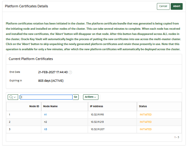

Platform Certificates
Oracle Key Vault platform certificates are used when adding a new node to an Oracle Key Vault multi-master cluster. Platform certificates are also used when shipping redo between read/write nodes in the cluster. The platform certificates are different from the Oracle Key Vault service certificates.

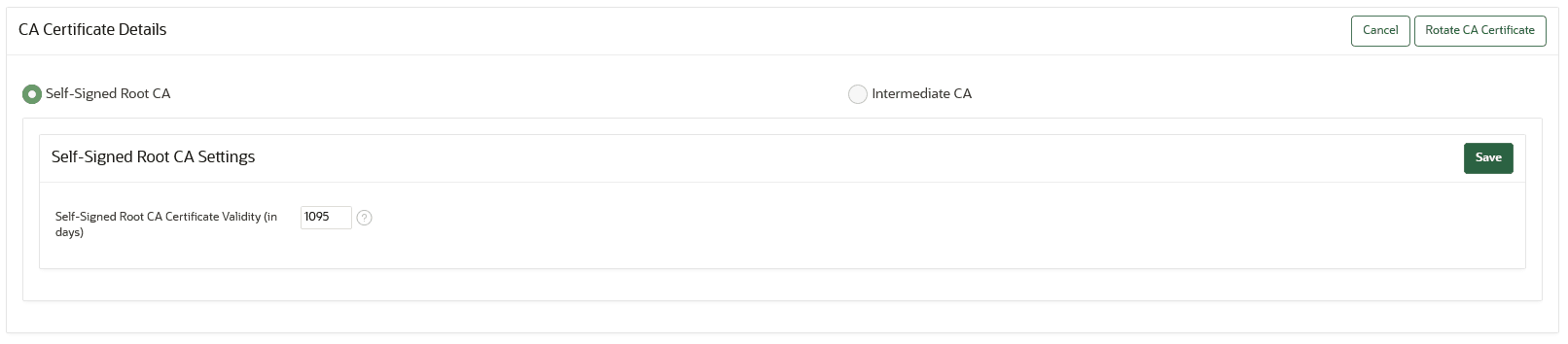

You can configure the validity period for the self-signed Root certificate authority (CA) certificate from the Oracle Key Vault management console. - Configuring Certificate Validity Period for Server and Node Certificates

19.2.3 Configuring Certificate Validity Period for Server and Node Certificates
You can configure the validity period for server or node certificates in the Oracle Key Vault management console.
The certificate validity period takes effect the next time you rotate the server or node certificates. It will also be taken into account when you generate the server or node certificates as part of a CA certificate rotation, or when you add a new node to the cluster, to the node certificates for that new node. Irrespective of the value that the server or node certificate validity is set to, when the certificates are eventually generated, Oracle Key Vault ensures that their expiry date is less than that of the CA certificate.

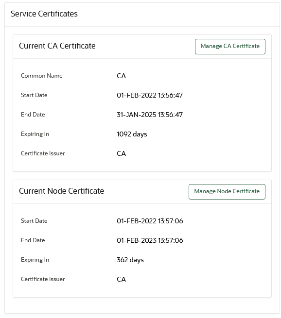

You can find the expiration date of endpoint certificates in the Oracle Key Vault management console. - CA Certificate Expiration Date on Status Page
You can check the CA Certificate Expiration Date, which is the expiration date of the Oracle Key Vault CA certificate, from the Status page. - Server and Node Certificate Expiration on Status Page
You can check the Server Certificate Expiration Date (in a standalone or primary-standby environment) or the Node Certificate Expiration Date (in a multi-master cluster environment) from the Status page. - Finding the Expiration Date of the CA Certificate
You can find how much time the Oracle Key Vault CA certificate has before it expires by navigating to the Service Certificates page. - Finding the Expiration Date of Server Certificates and Node Certificates
You can find the expiration date of server certificates and node certificates in the Oracle Key Vault management console.

Expiration of a certificate, especially the CA certificate, breaks the endpoint and Oracle Key Vault communication, and impacts the operations of one or more endpoints to the extent of stopping of endpoint operations completely. In addition, upgrades and communication between the Oracle Key Vault multi-master cluster nodes may also fail. Ensure that you rotate certificates much before their expiration date.
To avoid this scenario, Oracle recommends that you configure alerts as a reminder to rotate the certificates before they expire. There are separate alerts for endpoint certificate expiration, server or node certificate expiration, and CA certificate expiration.

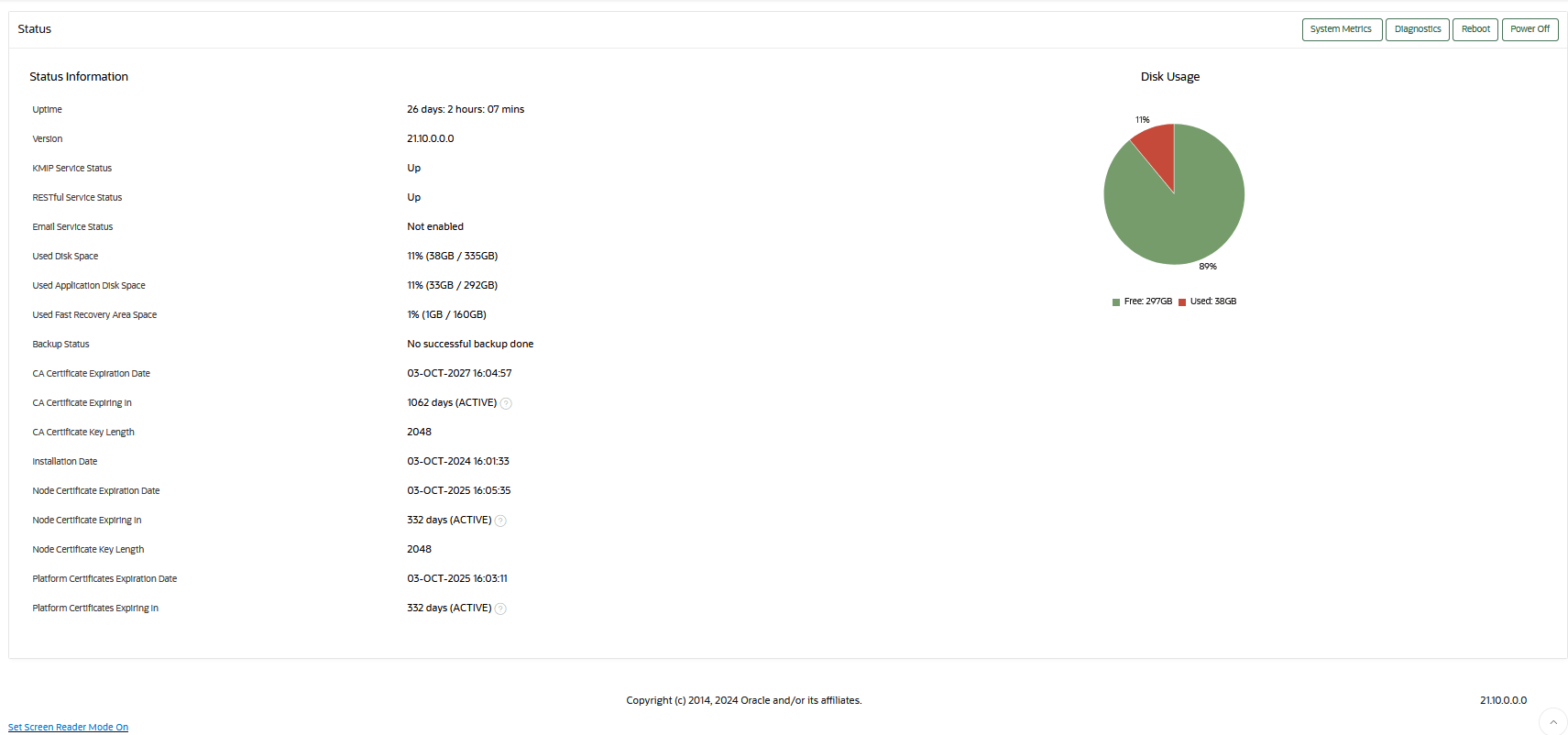

19.3.3 CA Certificate Expiration Date on Status Page
The CA Certificate Expiration Date field in the System Status page reflects the expiration date of the CA certificate. The CA Certificate Expiring In on the System Status page shows how many days are left to expire for the CA certificate.
To navigate to the System Status page, select the System tab.
- Log in to the Oracle Key Vault management console as a System
Administrator.
In a multi-master cluster environment, you can log in to any node in the cluster.
- Select the System tab and then Status from the left navigation side bar.
- Check the CA Certificate Expiration Date field.
- Check the CA Certificate Expiring in field.
Description of the illustration 2110_ca_certificate_details_status_page1.png
Oracle Key Vault raises an alert for the CA certificate expiration when the CA Certificate Expiration Date falls within the alert threshold period. You can also monitor the CA Certificate Expiration Date over SNMP.

19.3.4 Server and Node Certificate Expiration on Status Page
The Server Certificate Expiration Date field on the System Status reflects the expiration date of the server certificate. The Server Certificate Expiring In on the Status page shows how many days are left for the server certificate to expire. In a multi-master cluster environment, these fields are called Node Certificate Expiration Date and Node Certificate Expiring In. The Node Certificate Expiration Date field reflects the expiration date of the node certificate, while Node Certificate Expiring In shows how many days are left for the node certificate to expire.
In a multi-master cluster environment, log into the node whose node certificate expiration date you wish to check. Different nodes can have different node certificate expiration dates.
To navigate to the Status page, select the System tab.
- Log in to the Oracle Key Vault management console as a System Administrator.
- Check the Server Certificate Expiration Date field. In a multi-master cluster environment, this field is Node Certificate Expiration Date.
- Check the Server Certificate Expiring in field. In a multi-master cluster environment, this field is Node Certificate Expiring In.
Oracle Key Vault raises an alert for the Server or Node certificate expiration, when the server or node certificate expiration date falls within the configured alert threshold period. You can also monitor the Server Certificate Expiration Date over SNMP.

19.3.5 Finding the Expiration Date of the CA Certificate

19.3.6 Finding the Expiration Date of Server Certificates and Node Certificates
You can also check the Server Certificates and Node Certificates expiration date on the Oracle Key Vault System Status page.Related Topics

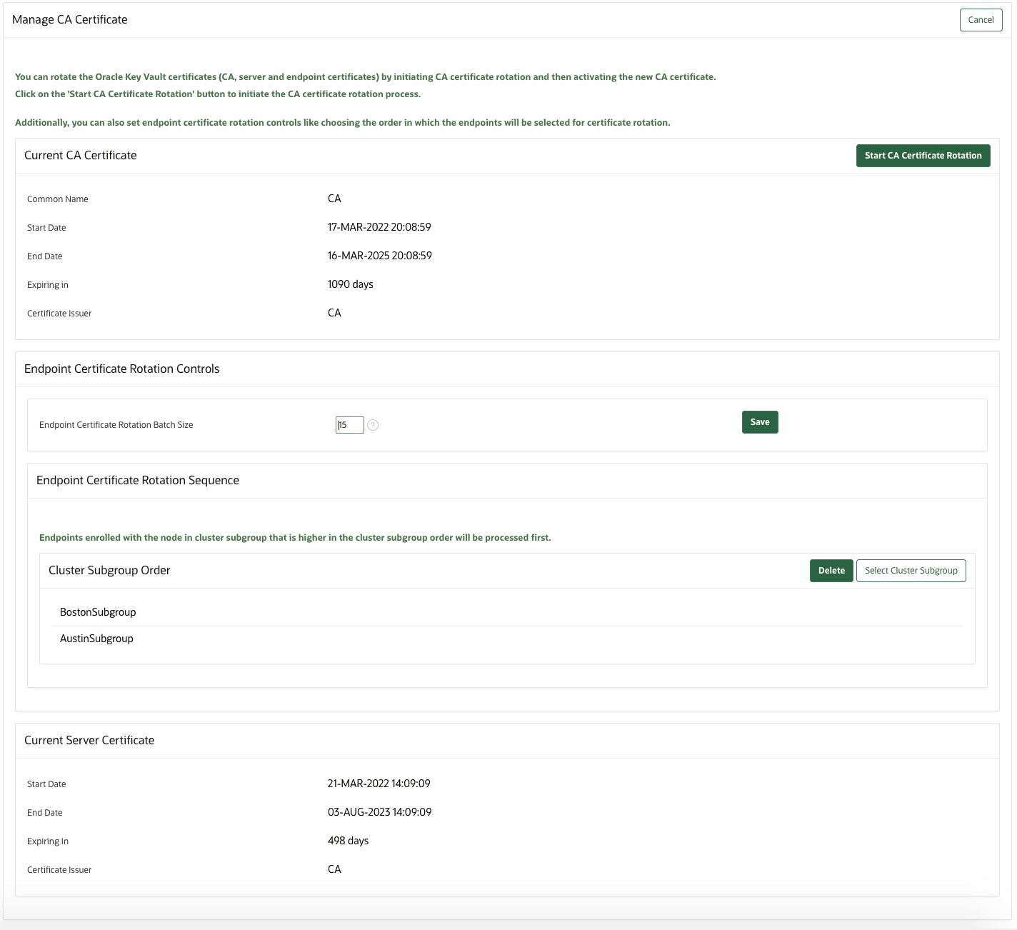

19.4 Managing CA Certificate Rotation
You can use the Oracle Key Vault management console to rotate the CA certificate before the certificate gets expired. The new CA certificate can be a self-signed Root CA certificate or an intermediate CA certificate.
- Steps for Managing CA Certificate Rotation

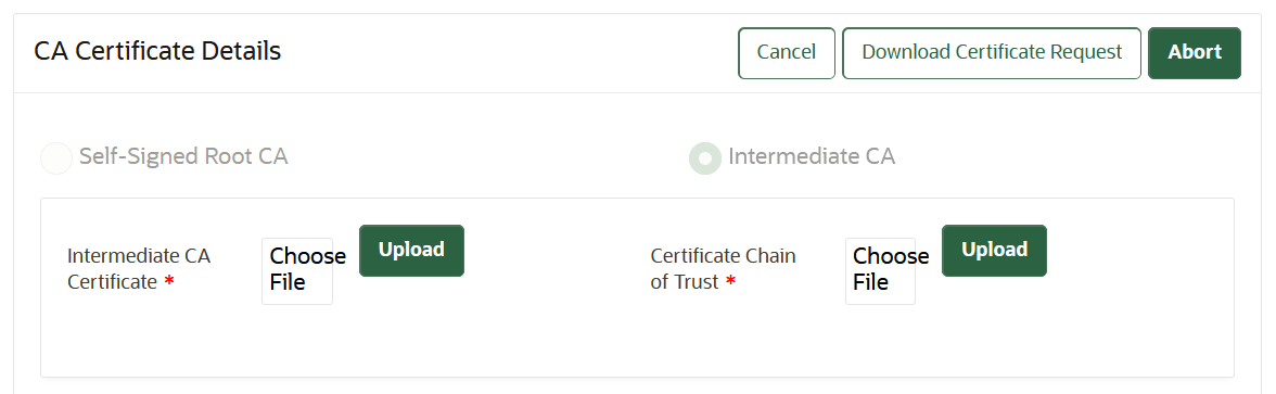

A user with the System Administrator role can perform CA certificate rotation when the CA is expiring. The user can set up a new self-signed Root CA or an intermediate certificate and put the new certificate into use. The server or node certificates, and the endpoint certificates are also rotated as part of this process. - Checking for Self-Signed Root CA or Intermediate CA Certificate

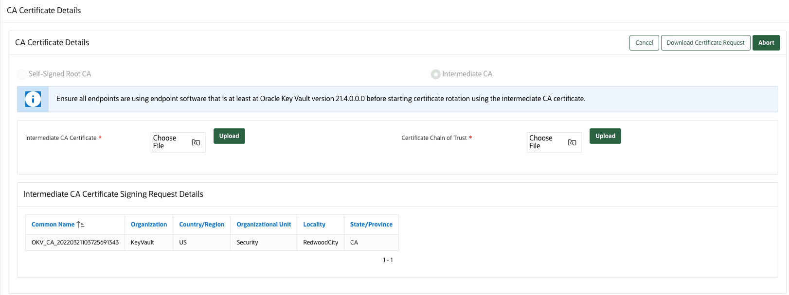

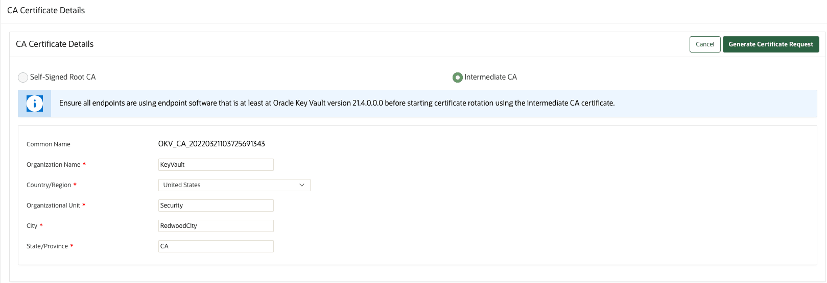

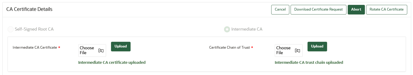

Oracle Key Vault uses either a self-signed root CA certificate or an intermediate CA certificate. - Setting the Key Length of the CA Certificate
You can select between the 2048-bits or 4096-bits key length values for the certificate authority (CA) certificate key length. - Setting the Validity of Self-Signed Root CA Certificate
You can set the number of days for the validity of a self-signed Root certificate authority (CA) certificate. - Setting Up the Intermediate CA Certificate
Use the Oracle Key Vault management console to generate the certificate signing request for the intermediate CA certificate, and upload the intermediate CA certificate signed by a trusted third party. - Rotating CA Certificate

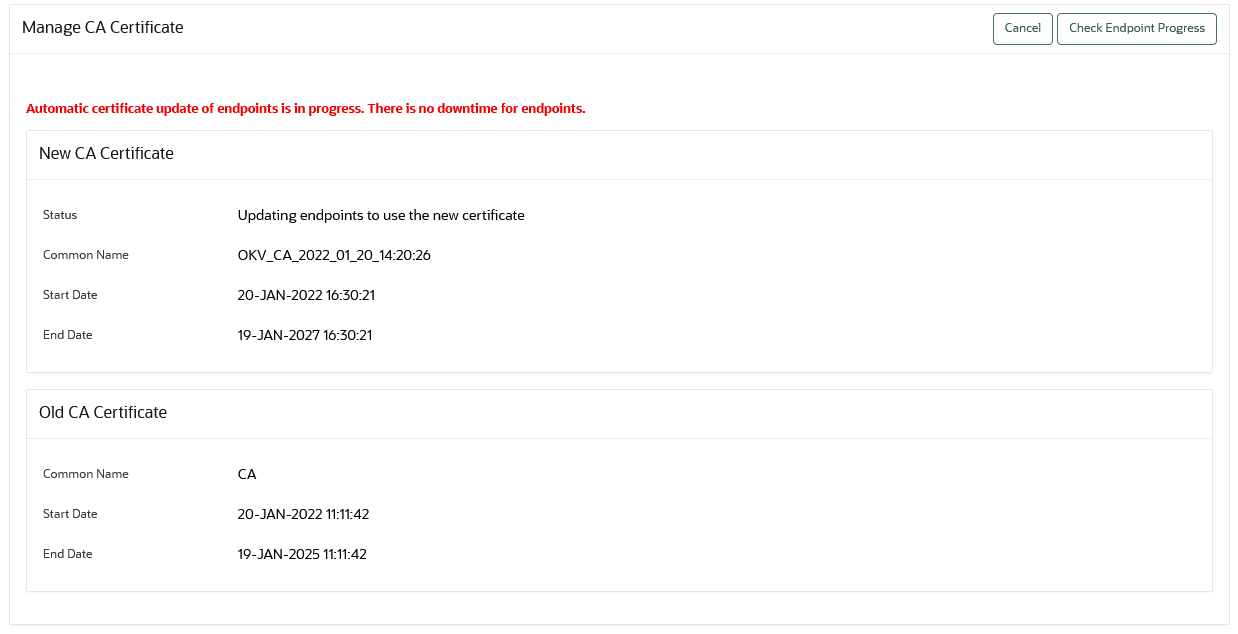

Use the Oracle Key Vault management console to rotate CA certificate and enable either a self-signed root CA certificate or an intermediate CA certificate. - Setting the Endpoint Certificate Rotation Batch Size
The endpoint certificate rotation batch size value represents the number of endpoints that can be in theROTATEDstate on a given Oracle Key Vault server or node during the CA certification rotation process. - Setting the Endpoint Certificate Rotation Sequence

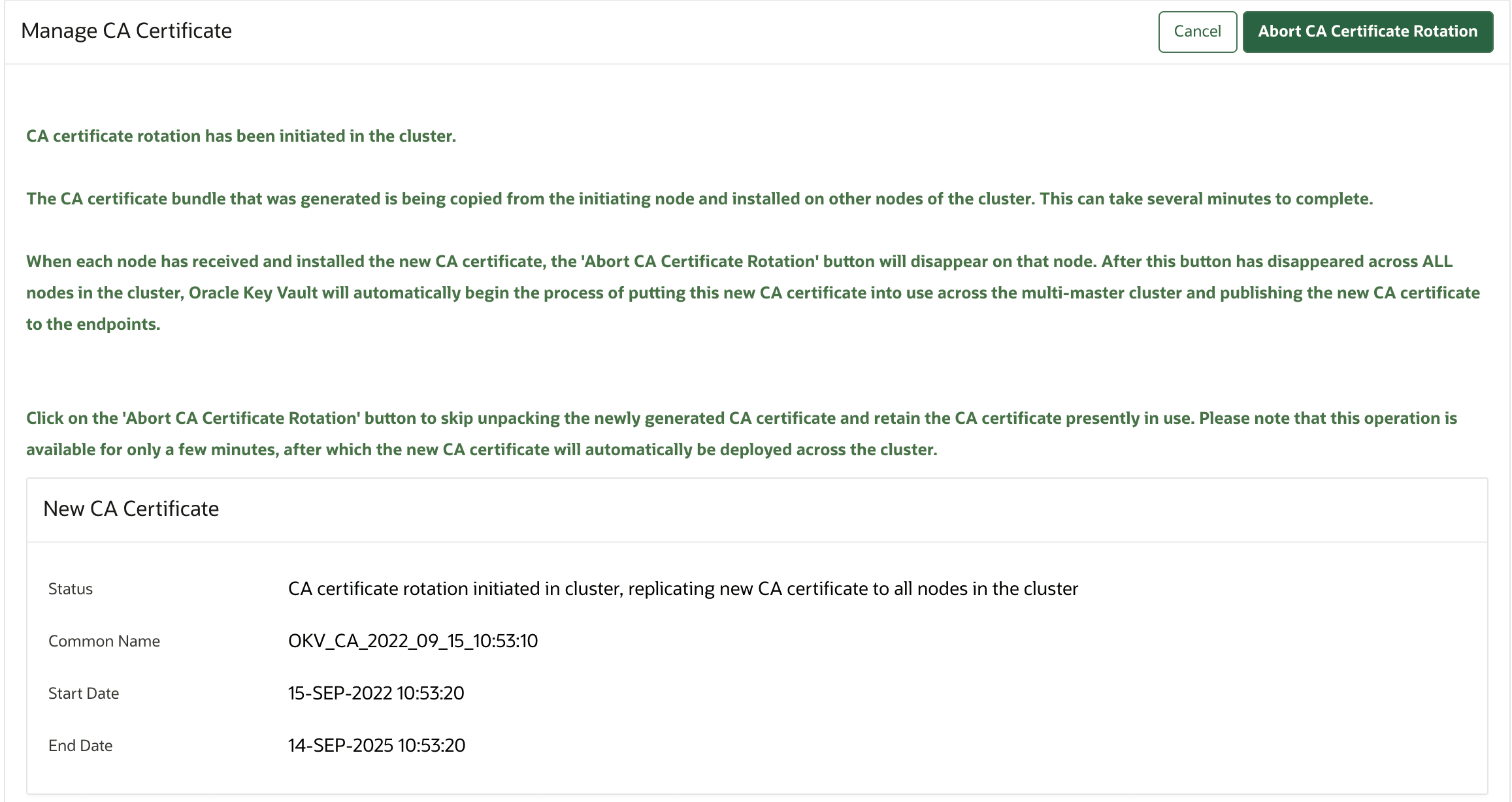

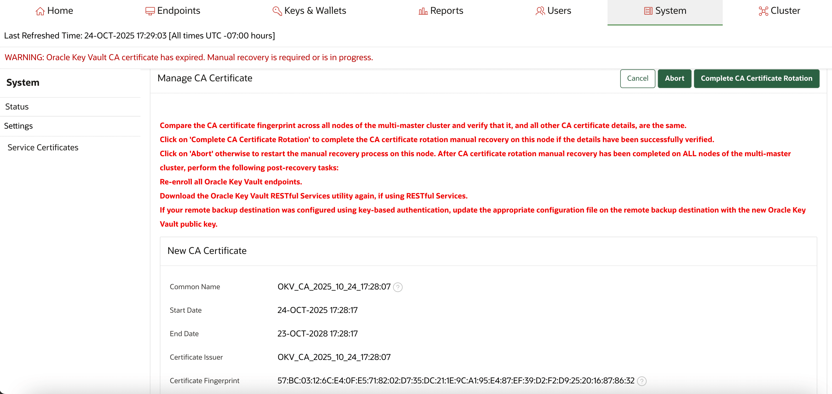

In a multi-master cluster environment, when you rotate certificate authority (CA) certificate, you broadly set the order in which endpoints can be rotated by ordering cluster subgroups. - Checking Overall Certificate Rotation Status
Use the Oracle Key Vault management console to check the overall status of a certificate rotation. - Checking Certificate Rotation Status for Endpoints
Use the Oracle Key Vault management console to check the status of a certificate rotation for endpoints. - Post-CA Certificate Rotation Tasks
After you complete the CA certificate rotation, perform the post-rotation tasks. - Factors Affecting CA Certificate Rotation Process

19.4.2 Checking for Self-Signed Root CA or Intermediate CA Certificate

19.4.4 Setting the Validity of Self-Signed Root CA Certificate
Related Topics
Parent topic: Managing CA Certificate Rotation
19.4.5 Setting Up the Intermediate CA Certificate
Uploading the intermediate CA certificate does not enable it (that is, uploading the intermediate CA certificate does not put it into use). Perform the following steps to rotate the CA certificate and enable the uploaded intermediate CA certificate:
Related Topics
19.4.6 Rotating CA Certificate
Perform these steps to complete the CA certificate rotation process throughout the Oracle Key Vault environment.

19.4.7 Setting the Endpoint Certificate Rotation Batch Size
endpoints that can be in the ROTATED state on a given Oracle Key
ROTATED state when Oracle Key Vault server or node has
issued the endpoint certificate using the new CA certificate but the new
endpoint certificate is either not yet received or acknowledged by the
endpoint.
19.4.8 Setting the Endpoint Certificate Rotation Sequence
Cluster subgroups are usually used to group endpoints in a region or data center. Since the re-issue of endpoint certificates during CA certificate rotation could be a time consuming process, it is convenient to process endpoints per cluster subgroup for operations simplicity.
19.4.9 Checking Overall Certificate Rotation Status

19.5.1 About Server Certificates and Node Certificates Rotation
Oracle Key Vault uses server certificates to communicate with its endpoints. Oracle Key Vault cluster nodes use node certificates to communicate with each other and with the endpoints.
These certificates are referred to as server certificates for standalone and primary-standby configurations and as node certificates in multi-master cluster configurations. The Oracle Key Vault certificate authority (CA) certificate issues these certificates.
You can rotate just these certificates, independently of the CA certificate rotation process. Doing so has no impact on the certificate expiry dates of the Oracle Key Vault CA or on any endpoints.
It is useful to rotate just the server and node certificates in situations where the Oracle Key Vault CA is still valid for much longer, but the server node certification will expire soon. This can happen because the CA validity is usually longer than the server or node certification validity.
- Set the validity of the server or node certificate
- Rotate server or node certificate
19.5.2 Configuring Certificate Validity Period for Server and Node Certificates

19.6 Managing the Oracle Key Vault CA Certificate After Expiry
You cannot start a CA certificate rotation when the Oracle Key Vault CA certificate has already expired.
When the endpoints cannot communicate with Oracle Key Vault it results in an outage. As a result, in a multi-master cluster environment, Oracle Key Vault nodes cannot communicate with each other. In such a scenario, you must regenerate a new CA certificate manually using the following steps.
In a multi-master cluster environment, this new CA certificate must be distributed from the generating node to all other nodes. After the CA certificate has been distributed across the cluster, you must rotate the node certificates on each cluster node in turn.
Back up Oracle Key Vault before commencing with these steps.
To manually issue a new CA certificate after the current CA certificate has expired, perform the following steps.
Parent topic: Managing Service Certificates

19.8 Managing Platform Certificates
- About Platform Certificates
Oracle Key Vault platform certificates are used when adding a new node to an Oracle Key Vault multi-master cluster. Platform certificates are also used when shipping redo between read/write nodes in the cluster. - Guidelines for Rotating Platform Certificates
Consider these guidelines when rotating platform certificates. - Rotating Platform Certificates
Learn how to rotate platform certificates in a multi-master cluster environment.
19.8.1 About Platform Certificates
Platform certificates are managed using a different process than the Oracle Key Vault service certificates. You must rotate the Oracle Key Vault platform certificates before they expire.
You cannot initiate a platform certificate rotation in deprecated primary-standby deployments. For more information, see Rotating Platform Certificates on a Standalone Oracle Key Vault Server.Parent topic: Managing Platform Certificates
19.8.2 Guidelines for Rotating Platform Certificates
- You must be a user who has the System Administrator role to rotate the platform certificates.
- Platform certification operation is possible only when all nodes of the cluster are of version Oracle Key Vault 21.10 or later.
- You cannot rotate the platform certificates when the cluster is being upgraded.
- You can initiate the platform certificates rotation on any cluster node. Other nodes will be automatically notified. You do not have to initiate on other cluster nodes and you should avoid this.
- The platform certificate rotation process is not allowed when any of the following cluster operations are in progress:
- CA certificate rotation
- Cluster services port change
- Recovery Passphrase change
- Adding a node
- Disabling a node
- Converting a server node to a cluster node
Conversely, you cannot initiate these operations when platform certificate rotation is in-progress.
- Deleting or force-deleting a node is always possible, so that there are no restrictions when performing either a delete or a force-delete when a platform certificate rotation is in-progress.
