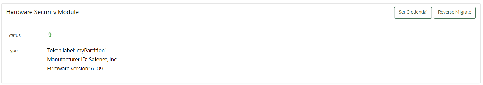

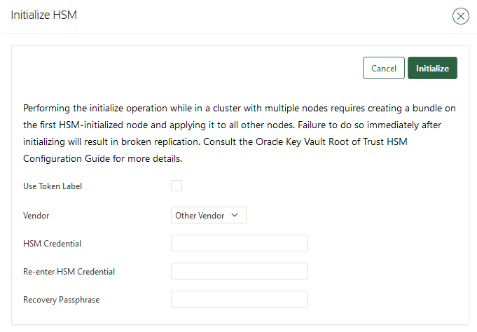

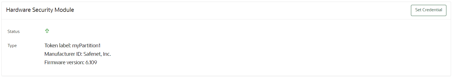

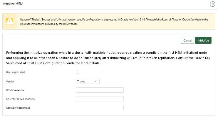

HSM-Enabling in a Standalone Oracle Key Vault Deployment
You can use the Oracle Key Vault management console to HSM-enable Oracle Key Vault, which configures additional protection for the TDE master encryption key.
/var/okv/log/hsm directory.
If you change the HSM credential on the HSM after initialization, then you must also update the HSM credential on the Oracle Key Vault server using the Set Credential command before the system restarts. Oracle does not recommend that you change the HSM credential after HSM initialization if there are primary-standby Oracle Key Vault deployments using the HSM, because the standby does not have its credential set by the Set Credential command on the primary.Parent topic: Configuring an HSM for Oracle Key Vault

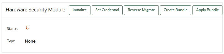

Configuring an HSM for a Multi-Master Cluster with Multiple Nodes
You can configure HSM for multiple nodes by copying a bundle from the first HSM-enabled node to the other nodes in the cluster before configuring HSM for the other nodes.
- About Configuring an HSM for a Multi-Master Cluster with Multiple Nodes
The general procedure is to perform steps on first on one node of the cluster, then on the other nodes in the cluster. - Step 1: Create and Copy the Bundle after HSM-Enabling the First Node
After HSM-enabling the first node in the multi-master cluster, you must create a bundle and copy it to the other nodes in the cluster. - Step 2: Configure the Remaining Nodes
After you configure the first node, you are ready to install the bundle on the remaining nodes.
The instructions for configuring an HSM for a multi-master cluster starting with a single node explain how to configure an HSM for a multi-master cluster, starting with a single node of the cluster and is the recommended way to configure a cluster to use HSM(s). However, if you have already configured a multi-master cluster, you can still configure the cluster to use HSMs. However, there are extra steps needed, involving manually copying a bundle from the first HSM-enabled node to all of the other nodes in the cluster and applying it before proceeding to HSM-enable any other node. Note that if the first node that is HSM-enabled has a read-write peer node, then the read-write peer will not be able to decrypt the replicated information from the HSM-enabled node until the bundle is copied and applied successfully to the read-write peer. This could result in data loss if the bundle is not immediately successfully created and applied to the read-write peer, even if the first node that is HSM-enabled is reverse-migrated afterwards.
After you HSM-enable the first node in the cluster, use the following steps to create the bundle on the HSM-enabled node and copy and apply it on all other nodes in the cluster before you proceed to HSM-enable any other node.

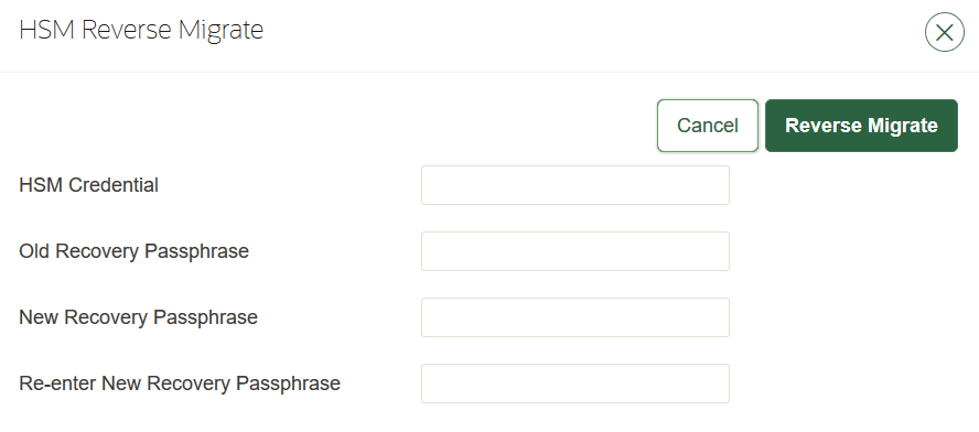

Reverse Migration Operations
Reverse migrating an HSM-enabled Oracle Key Vault server reverts the Key Vault server to using the recovery passphrase to protect the TDE wallet.
This operation is necessary if you no longer want to use the HSM to protect the TDE wallet password (for example, if the HSM must be decommissioned).
- Reverse Migrating a Standalone Deployment
You can reverse migrate a standalone deployment by using the Oracle Key Vault management console. - Reverse Migrating a Multi-Master Cluster
You can reverse migrate a multi-master cluster by using the Oracle Key Vault management console. - Reverse Migrating a Primary-Standby Deployment
To reverse migrate a primary-standby deployment, use both the Oracle Key Vault management console and the command line.
