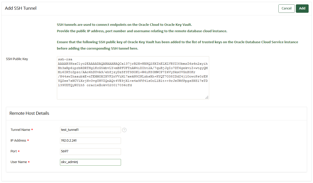

6.3 Using an SSH Tunnel Between Oracle Key Vault and Database as a Service
An on-premises Oracle Key Vault communicates with an Oracle Cloud Database as a Service instance using a secure SSH tunnel.
6.3.1 Creating an SSH Tunnel Between Oracle Key Vault and a DBaaS Instance
You can create a connection between Oracle Key Vault and a Database as a Service (DBaaS) instance by configuring an SSH tunnel.
You can configure the SSH tunnel only after you set up the Database as a Service instance. You must have the Database as a Service instance's public IP address and the name of the operating system user that you want to use to establish the tunnel.

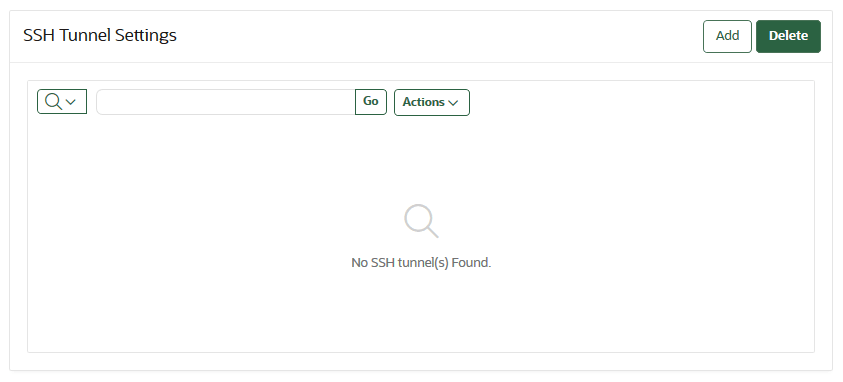

  1. Log in to the Oracle Key Vault management console as a user who has the System Administrator role.
  2. Select the System tab, and then Settings in the left navigation bar.
  3. In the Network Details area, select SSH Tunnel.
    The SSH Tunnel Settings page appears.
    Description of 21_ssh_tnl_setting.png follows
  4. Click Add.
  5. Copy the text in SSH Public Key field and save it.
    Remember that this is the public key that was copied into the OCI instance for user okv and was uploaded when you created a low privileged operating system user the Database as a Service instance. You will need to transport it to the Database as a Service instance and add it to the authorized_keys file of the Database as a Service user okv at /home/okv/.ssh/authorized_keys.
  6. In the Remote Host Details page, enter information in the following fields:
    • Tunnel Name: Choose a descriptive name that identifies the tunnel, based on the Database as a Service instance to be associated with it.
    • IP Address: Enter the public IP address of the Database as a Service instance.
    • Port: Enter a port number if you want to use a particular port number, or use the displayed default.
    • User Name: Enter okv for the user name.
    You can complete these fields only after you set up the Database as a Service instance and obtained the public IP address and user name.

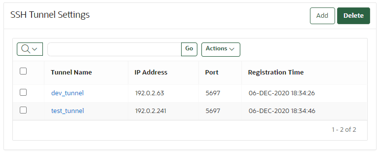

  7. Click Add.

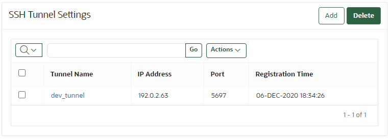

    The SSH Tunnel Settings page appears. It displays the SSH tunnel that you just created and any preexisting SSH tunnels.
    Description of 21_view_ssh.png follows
    It lists the tunnels created with the name, IP address, port, and registration time of each.

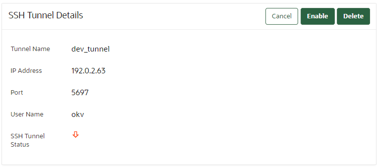

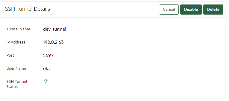

  8. Click a tunnel name to see the SSH Tunnel Details page.
  9. To delete a tunnel, check the box by the tunnel that you want to delete and then click Delete.
    You can delete more than one tunnel by selecting multiple boxes.

  10. Click Disable to disable the tunnel.
    When you disable the tunnel, the endpoints that are associated with this tunnel will no longer be able to communicate with Oracle Key Vault.
    Description of 21_disable_ssh.png follows
  11. In the confirmation dialog box, click Yes.
    The Disable button is replaced by an Enable button.

  4. Click a tunnel name to see the SSH Tunnel Details page.
  5. Click Disable to disable the tunnel.
    When you disable the tunnel, the endpoints that are associated with this tunnel will no longer be able to communicate with Oracle Key Vault. A red down arrow appears next to the SSH Tunnel Status label.
  6. In the confirmation dialog box, click Yes.

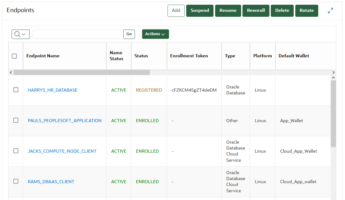

6.4.2 Step 1: Register the Endpoint in the Oracle Key Vault Management Console
The endpoint registration process downloads an okvclient.jar file, which contains the Oracle Key Vault software that the endpoint needs, to the local system.

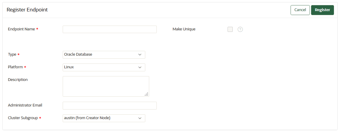

  2. Select the Endpoints tab, and then Endpoints in the left navigation bar.
  3. Click Add.
    The Register Endpoint page appears.
    Description of 21_dbcs_reg_endpoint.png follows
  4. Enter the following endpoint details:
    • Endpoint Name: Enter a unique name for the endpoint.
    • Make Unique: If you are using a multi-master cluster, then choose whether to select the Make Unique check box. Make Unique helps to control naming conflicts with endpoint names across the multi-master cluster environment.
      • If you select Make Unique, then the endpoint will be active immediately for Oracle Key Vault operations.
      • If you do not select Make Unique, then the endpoint account will be created in the PENDING state. Oracle Key Vault will then begin a name resolution operation and may rename the endpoint name to a name that is unique across the clusters. If there is a naming collision, then you must recreate the endpoint with a unique name. An endpoint in the PENDING state cannot be used in any Oracle Key Vault operations.
    • Type: Select Oracle Database Cloud Service. When you select this option, the Click here to add a SSH tunnel link appears. Click this link to go to the Add SSH Tunnel page where you can add an SSH tunnel.
    • Platform: Linux is automatically selected.
    • Description: Enter a meaningful description to identify the endpoint.
    • Administrator Email Optionally, enter the email address of an administrator who should receive endpoint-related alerts.
    • Cluster Subgroup: For a multi-master cluster environment, select the cluster subgroup for this endpoint.
  5. Click Register.
    After a short delay the Endpoints page displays the new endpoint in the Registered state with an Enrollment Token.
  6. Click Endpoint Name. The Endpoint Details page appears.

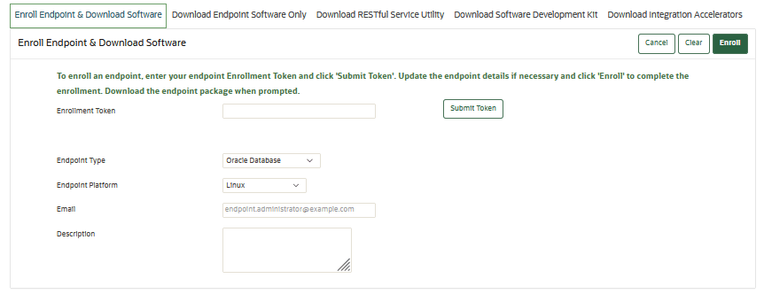

  9. Open the Oracle Key Vault management console as an endpoint manager. Do not log in
  10. Click Endpoint Enrollment and Software Download immediately after the Login button.
    The Enroll Endpoint & Download Software page appears.
    Description of 2110_endpoint_download.png follows
    The fields are populated with the values that were chosen by the Oracle Key Vault system administrator while registering the endpoint. You can change these values while completing the enrollment of the endpoint. Note that you must select the Primary SSH Tunnel for Database as a Service endpoints from the drop-down list. This is the only difference in the enrollment process from on-premises endpoints.
  11. In the Enrollment Token field, enter the endpoint token and then click Submit Token to validate the token.
  12. Click Enroll to download the okvclient.jar file to your local system.
  13. Move the okvclient.jar file to a secure directory on the Cloud Database as a Service instance with appropriate permissions in place so it cannot be read or copied by others.
    $ scp -i path_to_private_key-file path_to_okvclient.jar_on_local_computer oracle@node_ip_address:path_to_okvclient.jar_on_cloud_db_instance
    In this specification:
    • path_to_okvclient.jar_on_local_computer refers to the location of okvclient.jar on an on-premises local computer.
    • path_to_okvclient.jar_on_cloud_db_instance refers to the location of okvclient.jar on the oracle cloud database as a service instance.
