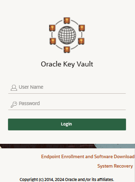

  2. Connect to the Oracle Key Vault management console.
    For example:
    https://192.0.2.254
    The login page to the Oracle Key Vault management console appears. Do not log in.

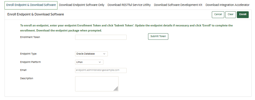

  3. Click the Endpoint Enrollment and Software Download button, which is after the Login button.
    The Enroll Endpoint & Download Software page appears.
    Description of 2110_endpoint_download1.png follows
  4. If the endpoint was registered by an Oracle Key Vault system administrator, then do the following:
    1. Enter the endpoint's enrollment token in Enrollment Token, and click Submit Token.
      If the token is valid, then a valid token message appears after the Enrollment Token field. The Endpoint Type, Endpoint Platform, Email and Description fields are automatically populated with the values that were entered during endpoint registration.
      If the token is invalid, then an invalid token message appears. Check the token and retry the download procedure.
    2. Click Enroll at the top right corner of the page.

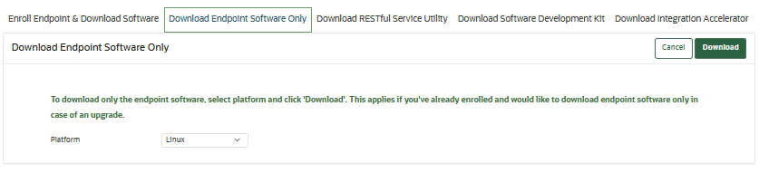

You can install the endpoint using the downloaded okvclient.jar file. For Oracle AI Database 26ai running on the linux-x64 platform, install the software with the "-arch db23ai" option to support Oracle 26ai databases running in FIPS mode using OpenSSL libraries and the new version of the local auto login wallet. This option is currently supported only on linux-x64 platform.
To upgrade to the latest endpoint software for an enrolled endpoint, you can download the endpoint software without having to re-enroll the endpoint.

    https://192.0.2.254
  3. In the lower-right corner of the login page under Login, click Endpoint Enrollment and Software Download.
  4. At the top of the page, click the Download Endpoint Software Only tab. Description of 2110_download_endpoint_software.png follows
  5. In the Download Endpoint Software Only page, select the endpoint platform from the Platform drop down menu and click Download.
  6. Save the file okvclient.jar to a desired location.
    For example:
    https://192.0.2.254
    Description of 21_new_login.png follows
  3. In the lower-right corner of the login screen, under Login, click Endpoint Enrollment and Software Download.
  4. In the Enroll Endpoint & Download Software page, click Download Endpoint Software Only.
    The Download Endpoint Software Only page appears.
  5. Select the Platform from the drop-down list and then click Download.
    A directory window appears, and prompts you to save the endpoint software file okvclient.jar. Navigate to the folder where you want to save the file.
  6. Save the file to an appropriate directory.
  7. Verify that the file is downloaded.
