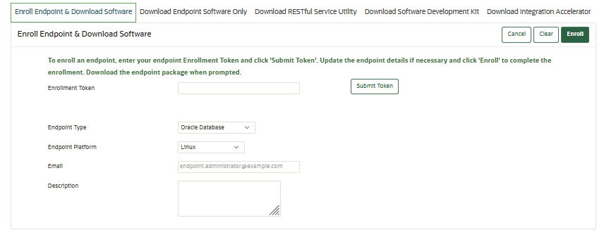

13.2.1 Step 1: Enroll the Endpoint and Download the Software
You must have the endpoint's enrollment token before you can download the endpoint software okvclient.jar.
okvclient.jar software file on the endpoint, starting with preparing the endpoint environment.

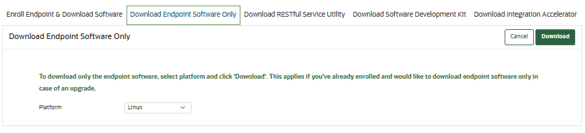

To upgrade to the latest endpoint software for an enrolled endpoint, you can download the endpoint software without having to re-enroll the endpoint.Parent topic: Finalizing Enrollment and Provisioning

13.8 Upgrading Endpoint Software

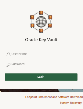

You can upgrade the endpoint software from the Oracle Key Vault management console login window.
- Step 1: Prepare the Endpoint Environment
Ensure that you have the correct privileges and that the endpoint has the correct configuration, such as Oracle environment variables. Perform the following steps as an endpoint manager. - Step 2: Download the Oracle Key Vault Software onto the Endpoint
You download theokvclient.jarfile to local computer. - Step 3: Install the Oracle Key Vault Software onto the Endpoint
You must be the endpoint manager to install the Oracle Key Vault software onto the endpoint. - Step 4: Perform Postinstallation Tasks
After you complete the installation, you can update the library used by TDE and then verify that the endpoint software was installed correctly. - Upgrading Endpoint Software on an Enrolled Endpoint
You should upgrade the endpoint software on an enrolled endpoint any time you upgraded to a new release of Oracle Key Vault.

13.8.2 Step 2: Download the Oracle Key Vault Software onto the Endpoint
You download the okvclient.jar file to local computer.
