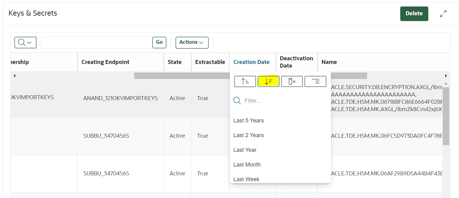

- Log in to the Oracle Key Vault management console as the Key Administrator user.
- Verify whether the latest keys are added to the wallet. Go to the Keys & Secrets page, and sort the keys in descending order by Creation Date.
- Check whether the latest keys created from that particular endpoint, Creating Endpoint are assigned to the wallet.

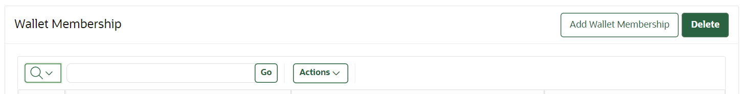

- If the key is not assigned to any wallet then, edit the key by clicking on the pencil icon.
- On the edit page, click on Add Wallet Membership and select the wallet assigned to the endpoint and save it.
- Verify whether the key has wallet membership by revisiting the Keys & Secrets page.

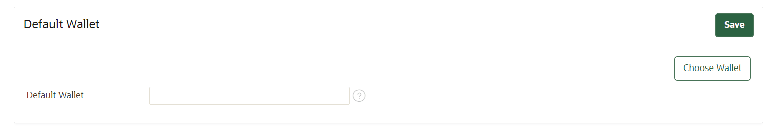

- Go to the endpoints page.
- Search for the endpoint then click on the endpoint name.
- Check the default wallet setting. If no default wallet is assigned, then click Choose Wallet to select the desired wallet.
- Click Save.
- Revisit the endpoint edit page to verify whether the default wallet is assigned correctly.

C.3.10 okvutil list Fails With KMIP Operation Failure Error
The okvutil list command fails with the KMIP Operation General Failure error.
Example
Error: KMIP Operation General FailureProbable Cause
The UUID of the key part of the Oracle Key Vault wallet is a private key and the required name and other details are not specified.
Solution
- As the support user, log in to the Oracle Key Vault server using
SSH, and then switch usersutoroot.ssh support@okv_server_IP_address su - root - Set the KMIP trace level to
16.vi /usr/local/okv/bin/kmipparam.ora TRACE_LEVEL=16Save the file.
- Restart the KMIP process.
service kmip restart - Run the
okvutil listcommand from the endpoint database. - Collect the latest KMIP traces on the Oracle Key Vault server.
/var/okv/log/kmipd/* - Search for KMIP OPERATIONAL errors in the latest KMIP trace file. The errors are displayed as follows:
2024-11-06 15:19:00.725: THREAD ID 139676363368192: trace_uuid: UUID: E91B163F-C4EA-45AC-88A3-2FE2CD816F2F 2024-11-06 15:19:00.725: THREAD ID 139676363368192: finish_op: status: 13 : setting local_err to KMIP_RES_REASON_GENERAL - Log in to the Oracle Key Vault management console, and from the Keys and Wallets tab, click Keys and Secrets. In the search bar, copy the UUID from Step 6 and verify that it exists.
- If the key is available and has no name or any other details, then perform Steps 9 to 13.
- On the right of the Key Details field, click the pencil icon to edit the key.
- Remove the assignment of the wallet membership for the current wallet of the endpoint, and then save your changes.
- Run the
okvutil listcommand again and verify if it is successful. If it fails, the error may be due to an issue with a different UUID. Repeat this procedure from step 6. - After the issue is resolved, disable KMIP traces.
