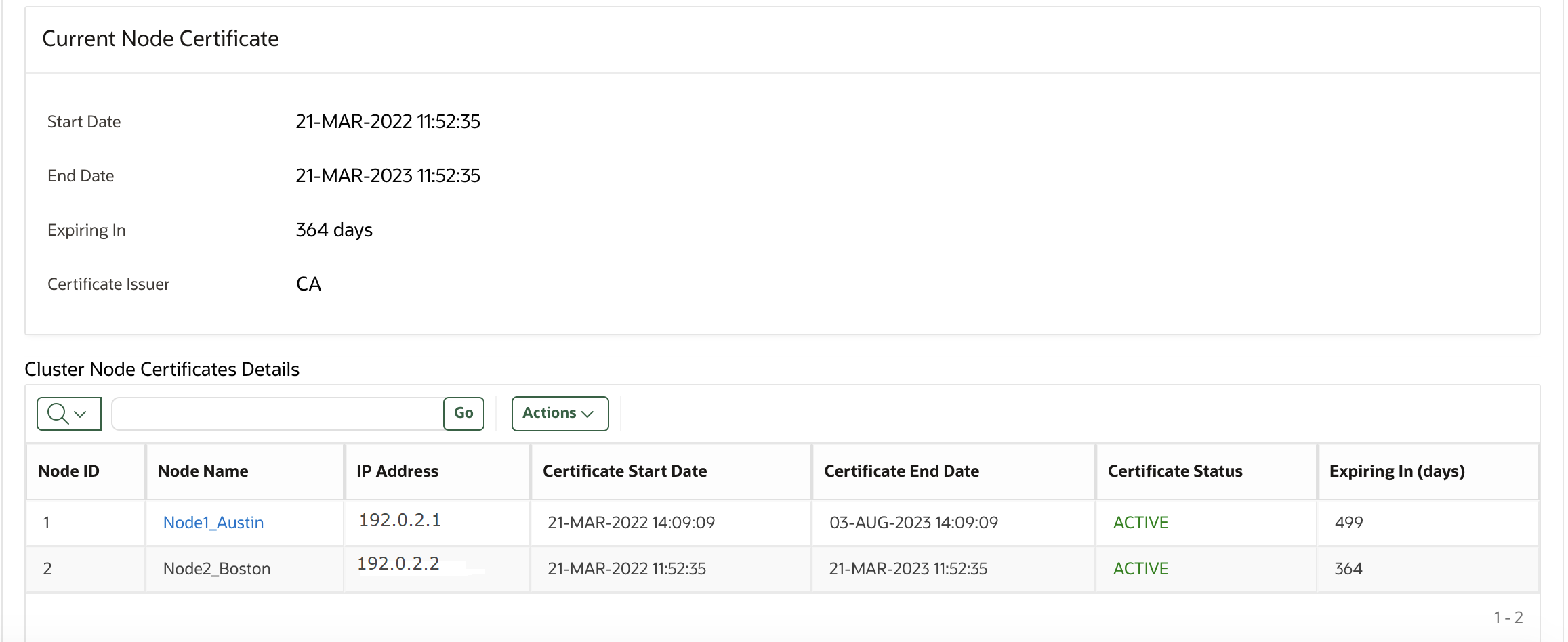

You can find the expiration date of server certificates and node certificates in the Oracle Key Vault management console. - Finding the Expiration Date of Endpoint Certificates

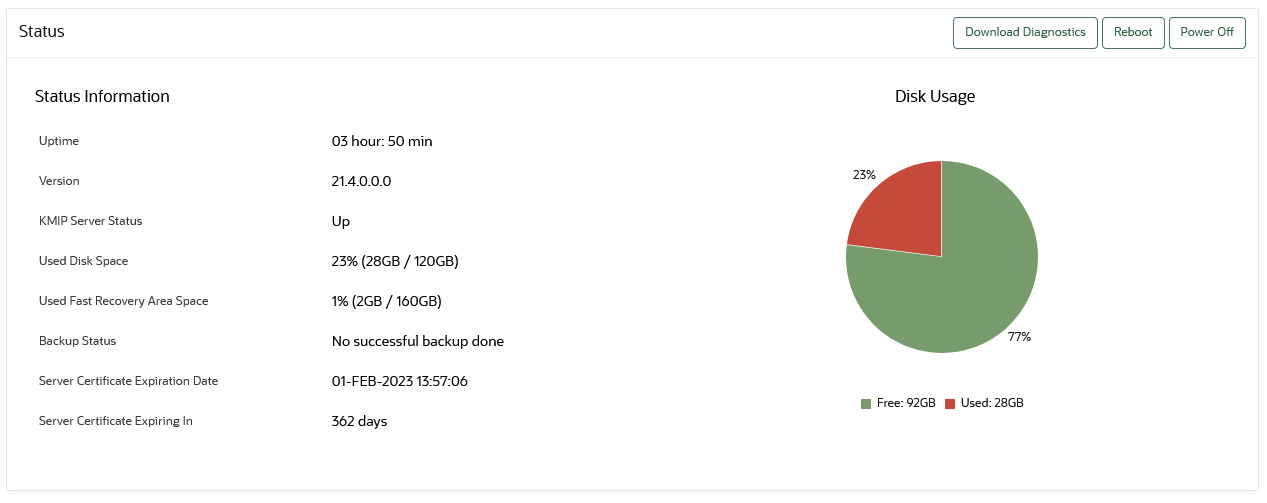

17.3.2 Server Certificate Expiration Date on Status Page
You can check the Server Certificate Expiration Date, which is the expiration date of CA or node or server certificate that is expiring first, from the Status page.
The Server Certificate Expiration Date field in the System Status page reflects the expiration date of the CA certificate, or the server/node certificate, whichever is expiring first. The Server Certificate Expiring In on the System Status page shows how many days are left to expire for any one of the CA or the server or node certificate that is expiring first.
To navigate to the System Status page, select the System tab.
- Log in to the Oracle Key Vault management console as a System
Administrator.
In a multi-master cluster environment, you can log in to any node in the cluster.
- Select the System tab and then Status from the left navigation side bar.
- Check the Server Certificate Expiration Date field.
- Check the Server Certificate Expiring in field.
Oracle Key Vault raises an alert for the Server Certificate Expiration Date when either the CA, or node, or server certificate falls within the alert threshold period. You can also monitor the Server Certificate Expiration Date over SNMP.
Parent topic: Monitoring Certificates Expiry

17.3.4 Finding the Expiration Date of Server Certificates and Node Certificates

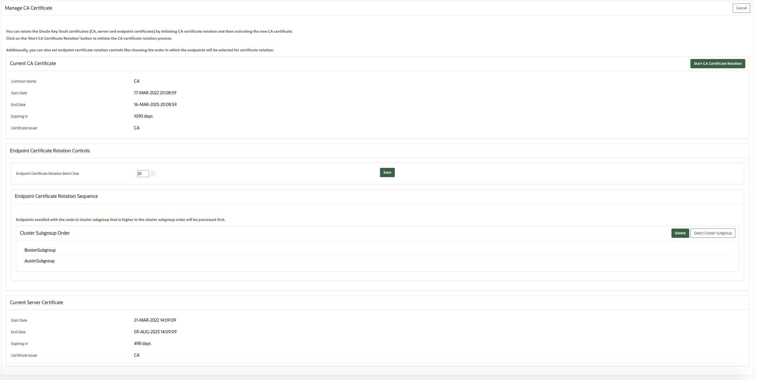

17.4 Managing CA Certificate Rotation
You can use the Oracle Key Vault management console to rotate the CA certificate. The new CA certificate can be a self-signed Root CA certificate or an intermediate CA certificate.
- Steps for Managing CA Certificate Rotation
A user with the System Administrator role can perform CA certificate rotation. The user can set up a new self-signed Root CA or an intermediate certificate and put the new certificate into use. The server or node certificates, and the endpoint certificates are also rotated as part of this process. - Checking for Self-Signed Root CA or Intermediate CA Certificate
Oracle Key Vault uses either a self-signed root CA certificate or an intermediate CA certificate. - Setting the Validity of Self-Signed Root CA Certificate
You can set the number of days for the validity of a self-signed Root certificate authority (CA) certificate. - Setting Up the Intermediate CA Certificate
Use the Oracle Key Vault management console to generate the certificate signing request for the intermediate CA certificate, and upload the intermediate CA certificate signed by a trusted third party. - Rotating CA Certificate
Use the Oracle Key Vault management console to rotate CA certificate and enable either a self-signed root CA certificate or an intermediate CA certificate. - Setting the Endpoint Certificate Rotation Batch Size
The endpoint certificate rotation batch size value represents the number of endpoints that can be in theROTATEDstate on a given Oracle Key Vault server or node during the CA certification rotation process. - Setting the Endpoint Certificate Rotation Sequence
In a multi-master cluster environment, when you rotate certificate authority (CA) certificate, you broadly set the order in which endpoints can be rotated by ordering cluster subgroups. - Checking Overall Certificate Rotation Status
Use the Oracle Key Vault management console to check the overall status of a certificate rotation. - Checking Certificate Rotation Status for Endpoints
Use the Oracle Key Vault management console to check the status of a certificate rotation for endpoints. - Post-CA Certificate Rotation Tasks
After you complete the CA certificate rotation, perform the post-rotation tasks. - Factors Affecting CA Certificate Rotation Process

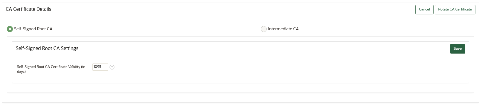

17.4.3 Setting the Validity of Self-Signed Root CA Certificate
Related Topics
Parent topic: Managing CA Certificate Rotation

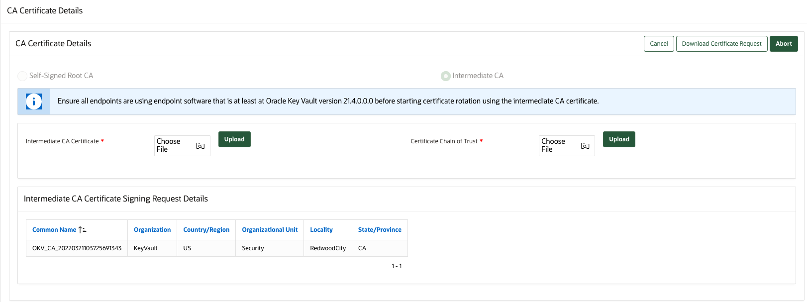

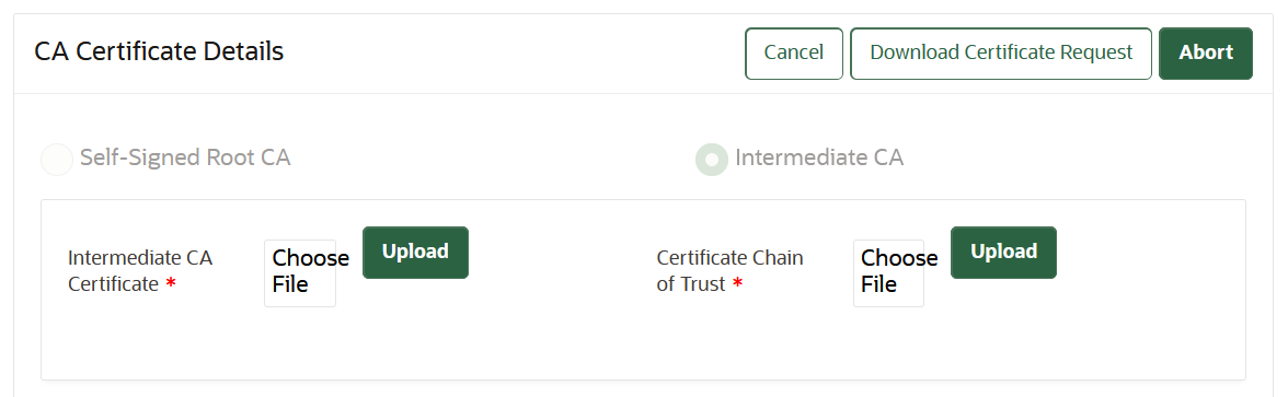

17.4.4 Setting Up the Intermediate CA Certificate
Related Topics

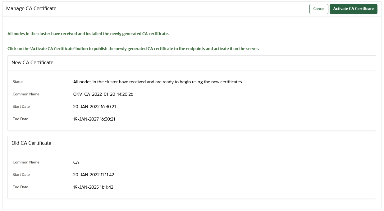

17.4.5 Rotating CA Certificate
Perform these steps to complete the CA certificate rotation process throughout the Oracle Key Vault environment.
Related Topics
17.4.6 Setting the Endpoint Certificate Rotation Batch Size
endpoints that can be in the ROTATED state on a given Oracle Key
ROTATED state when Oracle Key Vault server or node has
issued the endpoint certificate using the new CA certificate but the new
endpoint certificate is either not yet received or acknowledged by the
endpoint.
17.4.7 Setting the Endpoint Certificate Rotation Sequence
Cluster subgroups are usually used to group endpoints in a region or data center. Since the re-issue of endpoint certificates during CA certificate rotation could be a time consuming process, it is convenient to process endpoints per cluster subgroup for operations simplicity.

17.5.2 Configuring Certificate Validity Period for Server and Node Certificates
You can configure the validity period for server or node certificates in the Oracle Key Vault management console.
The certificate validity period takes effect the next time you rotate the server or node certificates. It will also be taken into account when you generate the server or node certificates as part of a CA certificate rotation, or when you add a new node to the cluster, to the node certificates for that new node. Irrespective of the value that the server or node certificate validity is set to, when the certificates are eventually generated, Oracle Key Vault ensures that their expiry date is less than that of the CA certificate.
17.5.3 Rotating Server Certificates and Node Certificates
You can rotate server certificates and node certificates in the Oracle Key Vault management console.
