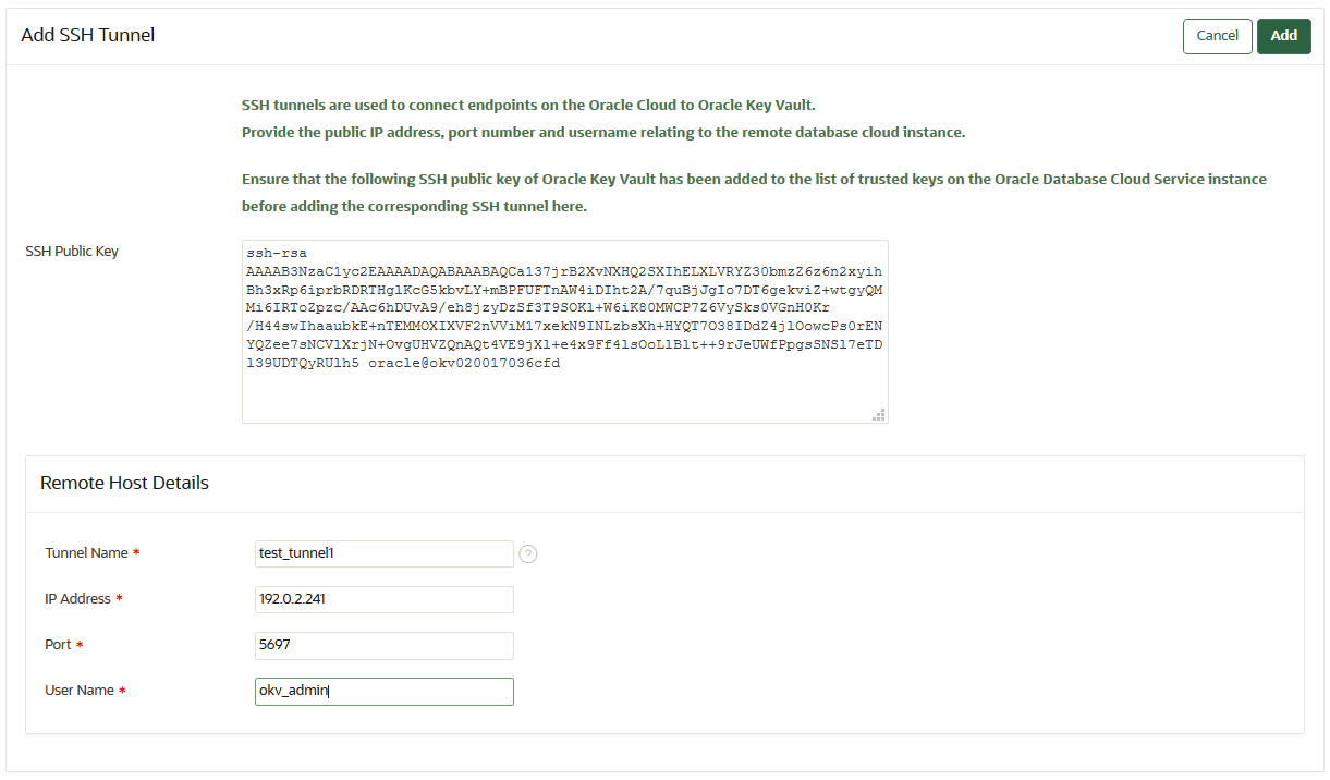

7.3.1 Creating an SSH Tunnel Between Oracle Key Vault and a DBaaS Instance
You can create a connection between Oracle Key Vault and a Database as a Service (DBaaS) instance by configuring an SSH tunnel.

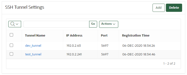

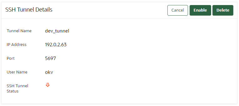

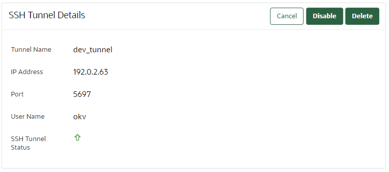

7.3.4 Viewing SSH Tunnel Configuration Details
The Oracle Key Vault management console provides information about SSH tunnels that have been configured for Oracle Key Vault.
7.3.5 Disabling an SSH Tunnel Connection
You can use the Oracle Key Vault management console to disable the Oracle Key Vault and Database as a Service instance connection.

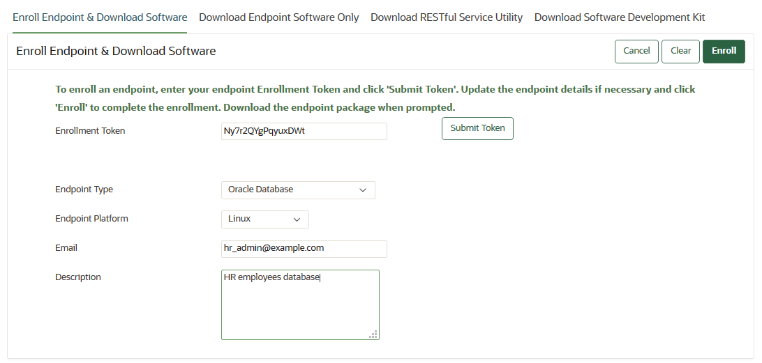

The enrollment of Database as a Service endpoints is similar to the enrollment of on-premises endpoints with the following exceptions:
Database as a Service endpoints should be registered with an endpoint type of “Oracle Database Cloud Service".
Database as a Service endpoints have a primary tunnel IP associated with them. You must select the SSH tunnel with the same public IP address of the Database as a Service instance.
The platform must be Linux. This is automatically selected and cannot be modified.
You must download the jar file on-premises and transfer it to the Database as a Service instance using an out-of-band method like SCP or FTP.

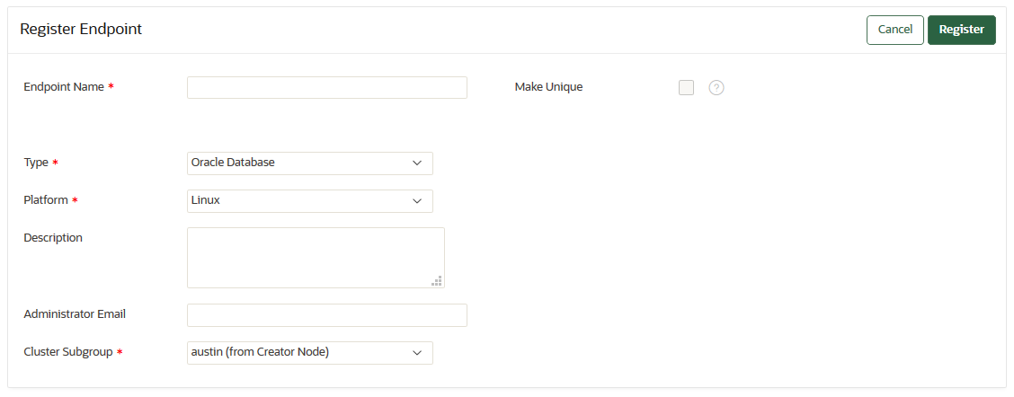

7.4.2 Step 1: Register the Endpoint in the Oracle Key Vault Management Console
The endpoint registration process downloads an okvclient.jar file, which contains the Oracle Key Vault software that the endpoint needs, to the local system.

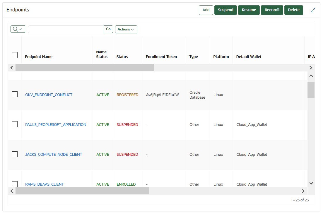

7.5.1 About Suspending Database Cloud Service Access to Oracle Key Vault
When the DBaaS service is suspended, the Oracle Key Vault Server rejects all requests from the suspended endpoints.
When you use an on-premises Oracle Key Vault to manage the online master encryption keys for Database as a Service endpoints, the master encryption keys are never stored persistently in Oracle Cloud. This way, the on-premises Oracle Key Vault administrator can control access to the encrypted data in the cloud.
An on-premises Oracle Key Vault administrator can suspend Database as a Service endpoints with a single click. This means that the Oracle Key Vault Server rejects all requests from the suspended endpoints. Because the endpoint cannot request keys from the Oracle Key Vault server, its ability to access encrypted data is lost after the key cached in memory times out. For Oracle Database Cloud Service endpoints, this time out is 5 minutes by default.
The on-premises Oracle Key Vault administrator can resume a suspended endpoint. This means that the Oracle Key Vault server can start servicing requests from the reinstated endpoint. The reinstated endpoint can now retrieve keys from the Oracle Key Vault server and access sensitive data.
In a multi-master cluster, when a node is being enabled or disabled, the information may not yet have reached all nodes in the cluster. If an endpoint attempts to contact a node whose information has not yet propagated throughout the cluster, an error may be returned.
Caution:
The suspend operation is a disruptive operation as it results in operational discontinuity. Therefore, you should use it with care. Usually, you should suspend the database only if there is a strong indication of abnormal activity in the Database as a Service instance.
You can only suspend enrolled endpoints. You cannot suspend endpoints that are in the Registered state. If you try to suspend endpoints that are already suspended, no operation will be performed. The endpoints will continue to be in suspended state.
