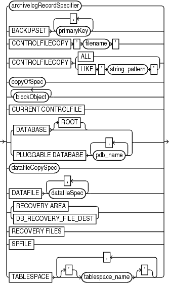

validateObject
This subclause specifies database files for validation. Refer to validateObject::= for syntax.

archivelogRecordSpecifier
Validates a range of archived redo log files. VALIDATE ARCHIVELOG is equivalent to BACKUP VALIDATE ARCHIVELOG.
BACKUPSET primary_key
Checks that the backup sets specified by primary_key exist and can be restored.
You can obtain the primary keys of backup sets by executing a LIST statement or, if you use a recovery catalog, by querying the RC_BACKUP_SET recovery catalog view.
The VALIDATE BACKUPSET command checks every block in the backup set to ensure that the backup is restorable. If RMAN finds block corruption, then it issues an error and terminates the validation. In contrast, the CROSSCHECK command examines the headers of the specified files if they are on disk or queries the media management catalog if they are on tape.
Use VALIDATE BACKUPSET when you suspect that one or more backup pieces in a backup set are missing or have been damaged. VALIDATE BACKUPSET selects which backups to test, whereas the VALIDATE option of the RESTORE command lets RMAN choose which backups to validate. For validating image copies, run RESTORE VALIDATE FROM DATAFILECOPY.
If you do not have automatic channels configured, then manually allocate at least one channel before executing VALIDATE BACKUPSET.
Note: If multiple copies of a backup set exist, then RMAN validates only the most recent copy. The VALIDATE command does not support an option to validate a specific copy. If one copy is on a different device from another copy, however, then you can use VALIDATE DEVICE TYPE to validate the copy on the specified device. If both copies exists on the same device, then you can use CHANGE to make one copy temporarily UNAVAILABLE and then reissue VALIDATE.
CONTROLFILECOPY{'filename' | ALL |LIKE 'string_pattern'}
Validates control file copies. You can specify a control file copy in one of the following ways:
  • 'filename' specifies a control file copy by file name.
  • ALL specifies all control file copies.
  • LIKE 'pattern' specifies a file name pattern that matches one or more control file copies. The percent sign (%) is a wildcard matching zero or more characters; an underscore (_) is a wildcard matching one character.
The control file copy can be created with the BACKUP AS COPY CURRENT CONTROLFILE command or the SQL statement ALTER DATABASE BACKUP CONTROLFILE TO '...'.
copyOfSpec
Validates image copies of data files and control files.
See Also: copyOfSpec for details.
CURRENT CONTROLFILE
Validates the current control file.
DATABASE
Validates the database.
In a multitenant container database (CDB), validates the whole CDB. Connect to the root as described in "Connecting to CDBs and PDBs". When connected to a pluggable database (PDB), validates the PDB.
RMAN validates all data files and control files. If the database is currently using a server parameter file, then RMAN validates the server parameter file.
Note: The online redo log files and temp files are not validated.
DATABASE ROOT
In a CDB, validates only the root. See the previous description of DATABASE for details about database validation.
PLUGGABLE DATABASE pdb_name
In a CDB, validates the specified PDBs. Use a comma-delimited list to specify multiple PDBs. Connect to the root as described in "Connecting to CDBs and PDBs".
datafileCopySpec
Validates one or more data file image copies.
When validating data file copies, RMAN checks for block corruption but does not terminate the validation if corruption is discovered. Unlike VALIDATE BACKUPSET, RMAN proceeds and reports the number of blocks that are corrupted.
See Also: datafileCopySpec for details
DATAFILE datafileSpec
Specifies a list of one or more data files that contain blocks requiring validation.
Note: You do not have to take a data file offline if you are validating it.
See Also: datafileSpec
RECOVERY AREA
Validates recovery files created in the current and all previous fast recovery area destinations. Recovery files are full and incremental backup sets, control file autobackups, archived redo log files, and data file copies. Flashback logs, the current control file, and online redo logs are not validated.
DB_RECOVERY_FILE_DEST
Semantically equivalent to RECOVERY AREA.
RECOVERY FILES
Validates all recovery files on disk, whether they are stored in the fast recovery area or other locations on disk. Recovery files include full and incremental backup sets, control file autobackups, archived redo log files, and data file copies. Flashback logs are not validated.
SPFILE
Validates the server parameter file currently used by the database. RMAN cannot validates other copies of the server parameter file, and cannot validate the server parameter file when the instance was started with an initialization parameter file.
TABLESPACE tablespace_name
Validates the specified tablespaces. RMAN translates tablespace names internally into a list of data files, then validates all data files that are currently part of the tablespaces. RMAN validates all data files that are currently members of the specified tablespaces.
When connected to the root in a CDB, refers to tablespaces in the root. Refers to tablespaces in a PDB when connected directly to a PDB.
See "Connecting to CDBs and PDBs".
