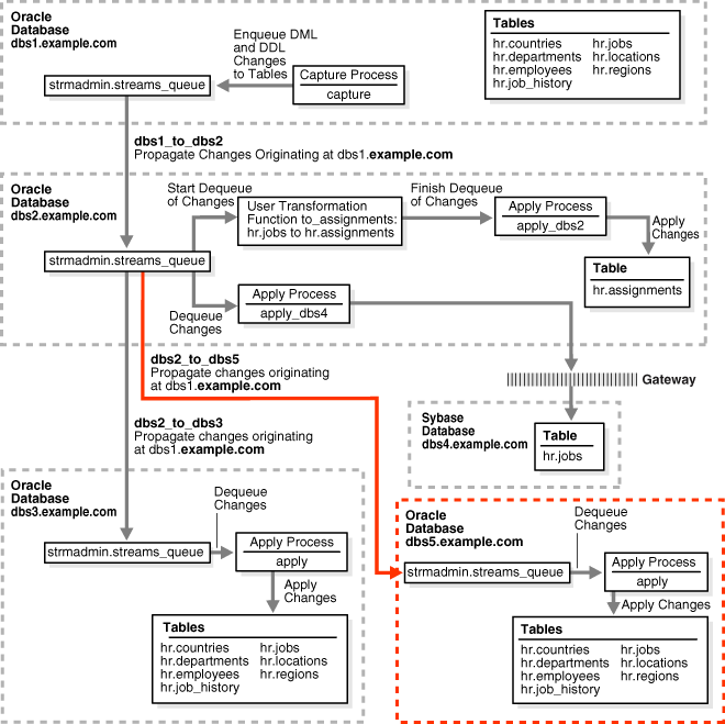

This example illustrates using Oracle Streams to replicate data between four databases. The environment is heterogeneous because three of the databases are Oracle databases and one is a Sybase database. DML and DDL changes made to tables in the hr schema at the dbs1.example.com Oracle database are captured and propagated to the other two Oracle databases. Only DML changes are captured and propagated to the dbs4.example.com database, because an apply process cannot apply DDL changes to a non-Oracle database. Changes to the hr schema occur only at dbs1.example.com. The hr schema is read-only at the other databases in the environment.
Figure 2-1 provides an overview of the environment.
Figure 2-1 Sample Environment that Shares Data from a Single Source Database
Description of "Figure 2-1 Sample Environment that Shares Data from a Single Source Database"
As illustrated in Figure 2-1, dbs1.example.com contains the following tables in the hr schema:
                        countries
                        departments
                        employees
                        job_history
                        jobs
                        locations
                        regions
This example uses directed networks, which means that captured changes at a source database are propagated to another database through one or more intermediate databases. Here, the dbs1.example.com database propagates changes to the dbs3.example.com database through the intermediate database dbs2.example.com. This configuration is an example of queue forwarding in a directed network. Also, the dbs1.example.com database propagates changes to the dbs2.example.com database, which applies the changes directly to the dbs4.example.com database through an Oracle Database Gateway.
Some of the databases in the environment do not have certain tables. If the database is not an intermediate database for a table and the database does not contain the table, then changes to the table do not need to be propagated to that database. For example, the departments, employees, job_history, and jobs tables do not exist at dbs3.example.com. Therefore, dbs2.example.com does not propagate changes to these tables to dbs3.example.com.
In this example, Oracle Streams is used to perform the following series of actions:
                        The capture process captures DML and DDL changes for all of the tables in the hrschema and enqueues them at thedbs1.example.comdatabase. In this example, changes to only four of the seven tables are propagated to destination databases, but in the example that illustrates "Add Objects to an Existing Oracle Streams Replication Environment", the remaining tables in thehrschema are added to a destination database.
                        The dbs1.example.comdatabase propagates these changes in the form of messages to a queue atdbs2.example.com.
                        At dbs2.example.com, DML changes to thejobstable are transformed into DML changes for theassignmentstable (which is a direct mapping ofjobs) and then applied. Changes to other tables in thehrschema are not applied atdbs2.example.com.
                        Because the queue at dbs3.example.comreceives changes from the queue atdbs2.example.comthat originated incountries,locations, andregionstables atdbs1.example.com, these changes are propagated fromdbs2.example.comtodbs3.example.com. This configuration is an example of directed networks.
                        The apply process at dbs3.example.comapplies changes to thecountries,locations, andregionstables.
                        Because dbs4.example.com, a Sybase database, receives changes from the queue atdbs2.example.comto thejobstable that originated atdbs1.example.com, these changes are applied remotely fromdbs2.example.comusing thedbs4.example.comdatabase link through an Oracle Database Gateway. This configuration is an example of heterogeneous support.

2.8 Add a Database to an Existing Oracle Streams Replication Environment
This example extends the Oracle Streams environment configured in the previous sections by adding an additional database to the existing configuration. In this example, an existing Oracle database named dbs5.example.com is added to receive changes to the entire hr schema from the queue at dbs2.example.com.
Figure 2-3 provides an overview of the environment with the added database.
Figure 2-3 Adding the dbs5.example.com Oracle Database to the Environment
Description of "Figure 2-3 Adding the dbs5.example.com Oracle Database to the Environment"
To complete this example, you must meet the following prerequisites:
                        The dbs5.example.comdatabase must exist.
                        The dbs2.example.comanddbs5.example.comdatabases must be able to communicate with each other through Oracle Net.
                        The dbs5.example.comanddbs1.example.comdatabases must be able to communicate with each other through Oracle Net (for optional Data Pump network instantiation).
                        You must have completed the tasks in the previous examples in this chapter.
                        The "Prerequisites" must be met if you want the entire Oracle Streams environment to work properly.
                        This examples creates a new user to function as the Oracle Streams administrator ( strmadmin) at thedbs5.example.comdatabase and prompts you for the tablespace you want to use for this user's data. Before you start this example, either create a new tablespace or identify an existing tablespace for the Oracle Streams administrator to use at thedbs5.example.comdatabase. The Oracle Streams administrator should not use theSYSTEMtablespace.
Complete the following steps to add dbs5.example.com to the Oracle Streams environment.

- Create the Database Link Between dbs2.example.com and dbs5.example.com
                        Connect to dbs2.example.comas thestrmadminuser.*/ CONNECT strmadmin@dbs2.example.com /* Create the database links to the databases where changes are propagated. In this example, database dbs2.example.compropagates changes todbs5.example.com.*/ CREATE DATABASE LINK dbs5.example.com CONNECT TO strmadmin IDENTIFIED BY &password USING 'dbs5.example.com'; /*
- Configure Propagation Between dbs2.example.com and dbs5.example.com
                        While still connected as the Oracle Streams administrator at dbs2.example.com, configure and schedule propagation from the queue atdbs2.example.comto the queue atdbs5.example.com. Remember, changes to thehrschema originated atdbs1.example.com.*/ BEGIN DBMS_STREAMS_ADM.ADD_SCHEMA_PROPAGATION_RULES( schema_name => 'hr', streams_name => 'dbs2_to_dbs5', source_queue_name => 'strmadmin.streams_queue', destination_queue_name => 'strmadmin.streams_queue@dbs5.example.com', include_dml => TRUE, include_ddl => TRUE, source_database => 'dbs1.example.com', inclusion_rule => TRUE, queue_to_queue => TRUE); END; / /*
