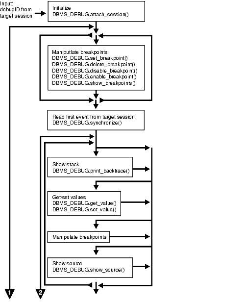

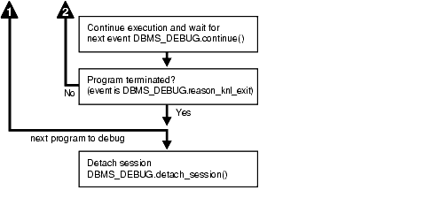

Figure 63-1 and Figure 63-2 illustrate the flow of operations in the session to be debugged and in the debugging session.
Figure 1: Target Session
{: #GUID-94955692-A9B7-4FFD-8E3F-DE91D361E956__BCGIFDGB .titleinfigure}
Figure 2: Debug Session {: #GUID-94955692-A9B7-4FFD-8E3F-DE91D361E956__I1011786 .titleinfigure}
Figure 3: Debug Session (Cont.) {: #GUID-94955692-A9B7-4FFD-8E3F-DE91D361E956__GUID-FBE31542-7CCE-484F-A45B-80B6075E9A31 .titleinfigure}

The best way to get the source code (for a program that is being run) is to use SQL. For example:
DECLARE
info DBMS_DEBUG.runtime_info;
BEGIN
-- call DBMS_DEBUG.SYNCHRONIZE, CONTINUE,
-- or GET_RUNTIME_INFO to fill in 'info'
SELECT text INTO <buffer> FROM all_source
WHERE owner = info.Program.Owner
AND name = info.Program.Name
AND line = info.Line#;
END;
However, this does not work for nonpersistent programs (for example, anonymous blocks and trigger invocation blocks). For nonpersistent programs, call SHOW_SOURCE. There are two flavors: one returns an indexed table of source lines, and the other returns a packed (and formatted) buffer.
The second overloading of SHOW_SOURCE returns the source in a formatted buffer, complete with line-numbers. It is faster than the indexed table version, but it does not guarantee to fetch all the source.
If the source does not fit in bufferlength (buflen), then additional pieces can be retrieved using the GET_MORE_SOURCE procedure (pieces returns the number of additional pieces that need to be retrieved).
