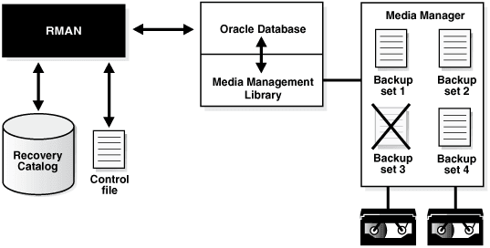

12.1.2 Basic Concepts of Backup and Repository Maintenance
RMAN provides multiple commands to maintain RMAN backups and repository records.
Following are the RMAN maintenance commands:
  • The CATALOG command enables you to add records about RMAN and user-managed backups that are currently not recorded in the RMAN repository, or to remove records for backups that are recorded.
  • The CHANGE command enables you to update the status of records in the RMAN repository.
  • The CROSSCHECK command enables you to synchronize the logical backup records with the physical reality of files in backup storage.
  • The DELETE command enables you to delete backups from the operating system.
12.1.2.1 About Maintenance Commands and RMAN Repository Metadata
RMAN always stores its metadata in the control file of each target database on which it performs operations. If you register a target database in the recovery catalog, then RMAN stores the metadata for this target database in the recovery catalog.
All of the RMAN maintenance commands work with or without a recovery catalog.

12.4.1.1 About RMAN Crosschecks
Crosschecks update outdated RMAN repository information about backups whose repository records do not match their physical status. For example, if a user removes archived logs from disk with an operating system command, the repository still indicates that the logs are on disk, when in fact they are not.
Figure 12-1 illustrates a crosscheck of a media manager. RMAN queries the RMAN repository for the names and locations of the four backup sets to be checked. RMAN sends this information to the target database server, which queries the media management software about the backups. The media management software then checks its media catalog and reports back to the server that backup set 3 is missing. RMAN updates the status of backup set 3 to EXPIRED in the repository. The record for backup set 3 is deleted after you run DELETE EXPIRED.
Figure 12-1 Crosschecking a Media Manager
Description of Figure 12-1 follows
Description of "Figure 12-1 Crosschecking a Media Manager"
Crosschecks are useful because they can do the following:
  • Update outdated information about backups that disappeared from disk or tape or became corrupted
  • Update the repository if you delete archived redo logs or other files with operating system commands
Use the crosscheck feature to check the status of a backup on disk or tape. If the backup is on disk, then CROSSCHECK checks whether the header of the file is valid. If a backup is on tape, then the command checks that the backups exist in the media management software catalog.
Backup pieces and image copies can have the status AVAILABLE, EXPIRED, or UNAVAILABLE. You can view the status of backups by running the RMAN LIST command or by querying V$BACKUP_FILES or recovery catalog views such as RC_DATAFILE_COPY or RC_ARCHIVED_LOG. A crosscheck updates the RMAN repository so that all of these techniques provide accurate information. RMAN updates each backup in the RMAN repository to status EXPIRED if the backup is no longer available. If a new crosscheck determines that an expired backup is available again, then RMAN updates its status to AVAILABLE.
The CROSSCHECK command does not delete operating system files or remove repository records. You must use the DELETE command for these operations.
You can issue the DELETE EXPIRED command to delete all expired backups. RMAN removes the record for the expired file from the repository. If for some reason the file still exists on the media, then RMAN issues warnings and lists the mismatched objects that cannot be deleted.
