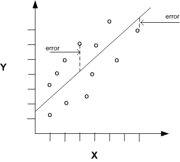

4.1.1.1 Linear Regression
A linear regression technique can be used if the relationship between the predictors and the target can be approximated with a straight line.
Regression with a single predictor is the easiest to visualize. Simple linear regression with a single predictor is shown in the following figure:
Figure 4-1 Linear Regression With a Single Predictor
Description of "Figure 4-1 Linear Regression With a Single Predictor"
Linear regression with a single predictor can be expressed with the following equation.
y = θ2x + θ1 + e
The regression parameters in simple linear regression are:
                              The slope of the line (2) — the angle between a data point and the regression line
                              The y intercept (1) — the point where x crosses the y axis (x = 0)
