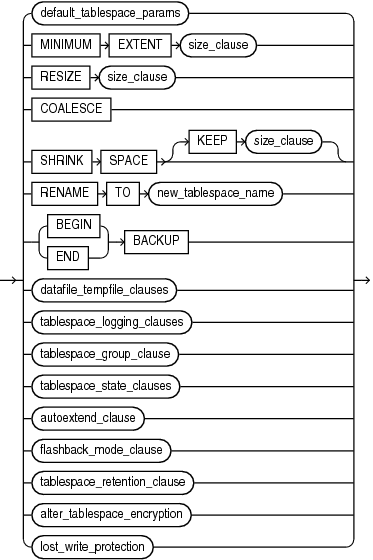

Syntax
alter_tablespace::=
Description of the illustration alter_tablespace.eps
(alter_tablespace_attrs::=)
Description of the illustration alter_tablespace_attrs.eps
(default_tablespace_params::=, size_clause::=, datafile_tempfile_clauses::=, tablespace_logging_clauses::=, tablespace_group_clause::=, tablespace_state_clauses::=, autoextend_clause::=, flashback_mode_clause::=, tablespace_retention_clause::=, alter_tablespace_encryption::=, lost_write_protection::=)

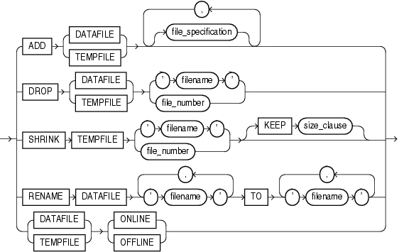

Description of the illustration datafile_tempfile_clauses.eps
(file_specification::=).
The tablespace file clauses let you add or modify a data file or temp file.
ADD Clause
Specify ADD to add to the tablespace a data file or temp file specified by file_specification. Use the datafile_tempfile_spec form of file_specification (see file_specification) to list regular data files and temp files in an operating system file system or to list Oracle Automatic Storage Management disk group files.
For locally managed temporary tablespaces, this is the only clause you can specify at any time.
If you omit file_specification, then Oracle Database creates an Oracle Managed File of 100M with AUTOEXTEND enabled.
You can add a data file or temp file to a locally managed tablespace that is online or to a dictionary managed tablespace that is online or offline. Ensure the file is not in use by another database.
Restriction on Adding Data Files and Temp Files
You cannot specify this clause for a bigfile (single-file) tablespace, as such a tablespace has only one data file or temp file.
Note: On some operating systems, Oracle does not allocate space for a temp file until the temp file blocks are actually accessed. This delay in space allocation results in faster creation and resizing of temp files, but it requires that sufficient disk space is available when the temp files are later used. To avoid potential problems, before you create or resize a temp file, ensure that the available disk space exceeds the size of the new temp file or the increased size of a resized temp file. The excess space should allow for anticipated increases in disk space use by unrelated operations as well. Then proceed with the creation or resizing operation.
See Also: file_specification, “Adding and Dropping Data Files and Temp Files: Examples”, and “Adding an Oracle-managed Data File: Example”
DROP Clause
Specify DROP to drop from the tablespace an empty data file or temp file specified by filename or file_number. This clause causes the data file or temp file to be removed from the data dictionary and deleted from the operating system. The database must be open at the time this clause is specified.
The ALTER TABLESPACE … DROP TEMPFILE statement is equivalent to specifying the ALTER DATABASE TEMPFILE … DROP INCLUDING DATAFILES.
Restrictions on Dropping Files
To drop a data file or temp file, the data file or temp file:
SHRINK TEMPFILE Clause
This clause is valid only when altering a temporary tablespace. It lets you reduce the amount of space the specified temp file is taking. In the optional KEEP clause, the size_clause defines the lower bound that the temp file can be shrunk to. It is the opposite of MAXSIZE for an autoextensible tablespace. If you omit the KEEP clause, then the database will attempt to shrink the temp file as much as possible as long as other storage attributes are satisfied.
RENAME DATAFILE Clause
Specify RENAME DATAFILE to rename one or more of the tablespace data files. The database must be open, and you must take the tablespace offline before renaming it. Each filename must fully specify a data file using the conventions for filenames on your operating system.
This clause merely associates the tablespace with the new file rather than the old one. This clause does not actually change the name of the operating system file. You must change the name of the file through your operating system.
See Also: “Moving and Renaming Tablespaces: Example”
The following statement adds a data file to the tablespace. When more space is needed, new 10-kilobytes extents will be added up to a maximum of 100 kilobytes:
ALTER TABLESPACE tbs_03
    ADD DATAFILE 'tbs_f04.dbf'
    SIZE 100K
    AUTOEXTEND ON
    NEXT 10K
    MAXSIZE 100K;
The following statement drops the empty data file:
    DROP DATAFILE 'tbs_f04.dbf';
The following statements add a temp file to the temporary tablespace created in “Creating a Temporary Tablespace: Example” and then drops the temp file:
ALTER TABLESPACE temp_demo ADD TEMPFILE 'temp05.dbf' SIZE 5 AUTOEXTEND ON;
ALTER TABLESPACE temp_demo DROP TEMPFILE 'temp05.dbf';
