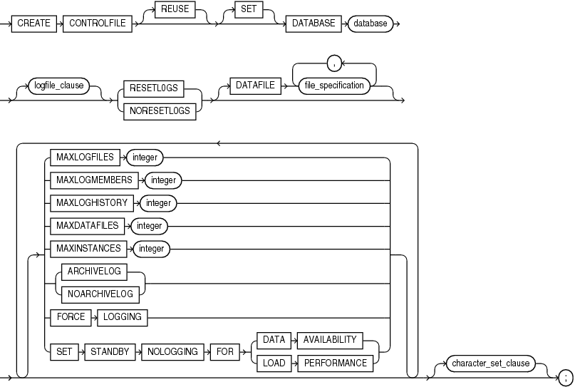

Syntax
create_controlfile::=
Description of the illustration create_controlfile.eps
