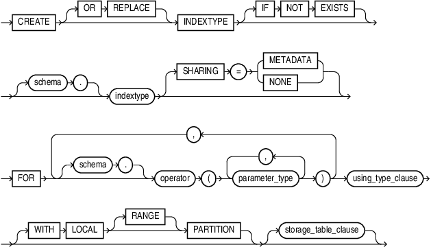

Syntax

IF NOT EXISTS
Specifying IF NOT EXISTS has the following effects:
  • If the indextype does not exist, a new one is created at the end of the statement.
  • If the indextype exists, it is detected and a new one is not created.
You can only specify OR REPLACE or IF NOT EXISTS in a statement at a time. Using both OR REPLACE with IF NOT EXISTS in the very same statement results in an error.
You cannot specify IF EXISTS with CREATE statements.
schema
Specify the name of the schema in which the indextype resides. If you omit schema, then Oracle Database creates the indextype in your own schema.
indextype
Specify the name of the indextype to be created. The name must satisfy the requirements listed in "Database Object Naming Rules".
SHARING
Use the sharing clause if you want to create the object in an application root in the context of an application maintenance. This type of object is called an application common object and it can be shared with the application PDBs that belong to the application root.
You can specify how the object is shared using one of the following sharing attributes:
  • METADATA - A metadata link shares the metadata, but its data is unique to each container. This type of object is referred to as a metadata-linked application common object.
  • NONE - The object is not shared and can only be accessed in the application root.
FOR Clause
Use the FOR clause to specify the list of operators supported by the indextype.
  • For schema, specify the schema containing the operator. If you omit schema, then Oracle assumes the operator is in your own schema.
  • For operator, specify the name of the operator supported by the indextype.
    All the operators listed in this clause must be valid operators.
  • For parameter_type, list the types of parameters to the operator.
using_type_clause
The USING clause lets you specify the type that provides the implementation for the new indextype.
For implementation_type, specify the name of the type that implements the appropriate Oracle Data Cartridge Interface (ODCI).
  • You must specify a valid type that implements the routines in the ODCI.
  • The implementation type must reside in the same schema as the indextype.
See Also:
Oracle Database Data Cartridge Developer's Guide for additional information on this interface
WITH LOCAL PARTITION
Use this clause to indicate that the indextype can be used to create local domain indexes on range-, list-, hash-, and interval-partitioned tables. You use this clause in combination with the storage_table_clause in several ways (see storage_table_clause).
  • The recommended method is to specify WITH LOCAL PARTITION WITH SYSTEM MANAGED STORAGE TABLES. This combination uses system-managed storage tables, which are the preferred storage management, and lets you create local domain indexes on range-, list-, hash-, and interval-partitioned tables. In this case the RANGE keyword is optional and ignored, because it is no longer needed if you specify WITH LOCAL PARTITION WITH SYSTEM MANAGED STORAGE TABLES.
  • You can specify WITH LOCAL RANGE PARTITION (including the RANGE keyword) and omit the storage_table clause. Local domain indexes on range-partitioned tables are supported with user-managed storage tables for backward compatibility. Oracle does not recommend this combination because it uses the less efficient user-managed storage tables.
If you omit this clause entirely, then you cannot subsequently use this indextype to create a local domain index on a range, list-, hash-, or interval-partitioned table.
Use this clause to specify how storage tables and partition maintenance operations for indexes built on this indextype are managed:
  • Specify WITH SYSTEM MANAGED STORAGE TABLES to indicate that the storage of statistics data is to be managed by the system. The type you specify in statistics_type should be storing the statistics related information in tables that are maintained by the system. Also, the indextype you specify must already have been created or altered to support the WITH SYSTEM MANAGED STORAGE TABLES clause.
  • Specify WITH USER MANAGED STORAGE TABLES to indicate that the tables that store the user-defined statistics will be managed by the user. This is the default behavior.
See Also:
Oracle Database Data Cartridge Developer's Guide for more information about storage tables for domain indexes
array_DML_clause
Use this clause to let the indextype support the array interface for the ODCIIndexInsert method.
type and varray_type
If the data type of the column to be indexed is a user-defined object type, then you must specify this clause to identify the varray varray_type that Oracle should use to hold column values of type. If the indextype supports a list of types, then you can specify a corresponding list of varray types. If you omit schema for either type or varray_type, then Oracle assumes the type is in your own schema.
If the data type of the column to be indexed is a built-in system type, then any varray type specified for the indextype takes precedence over the ODCI types defined by the system.
See Also:
Oracle Database Data Cartridge Developer's Guide for more information on the ODCI array interface
