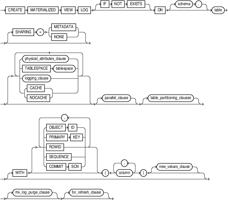

create_materialized_vw_log::=
Description of the illustration create_materialized_vw_log.eps
(physical_attributes_clause::=, logging_clause::=, parallel_clause::=, table_partitioning_clauses::= (in CREATE TABLE), new_values_clause::=, mv_log_purge_clause::=, for_refresh_clause::=.)
