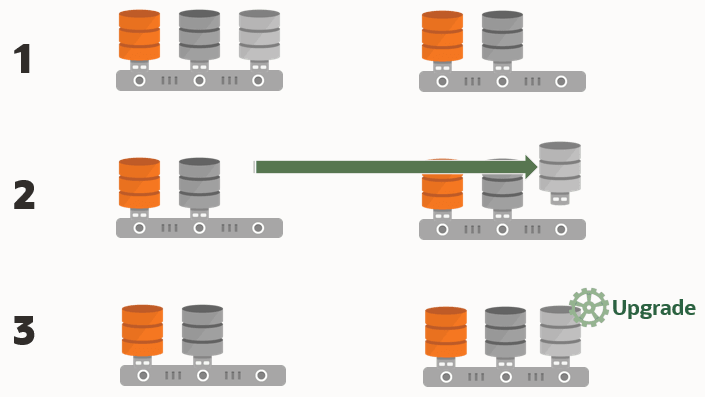

The following illustration shows the unplug-plug operation, in this case of a single PDB:
  1. There is one source Oracle Database, and one target release Oracle Database. At this stage, create your configuration file and run AutoUpgrade in Analyze mode (autoupgrade.jar -mode analyze) to check your readiness for upgrade, and to correct any issues that are reported.
  2. You run AutoUpgrade in Deploy mode (autoupgrade.jar -mode deploy). AutoUpgrade uses the information you provide in the configuration file to move the PDB to the target release, and plug in the PDB.
  3. AutoUpgrade runs prefixups, and then upgrades the PDB to the target release.
Figure 3-2 Unplug-Plug Upgrades from Source to Target
Description of Figure 3-2 follows
Description of "Figure 3-2 Unplug-Plug Upgrades from Source to Target"
