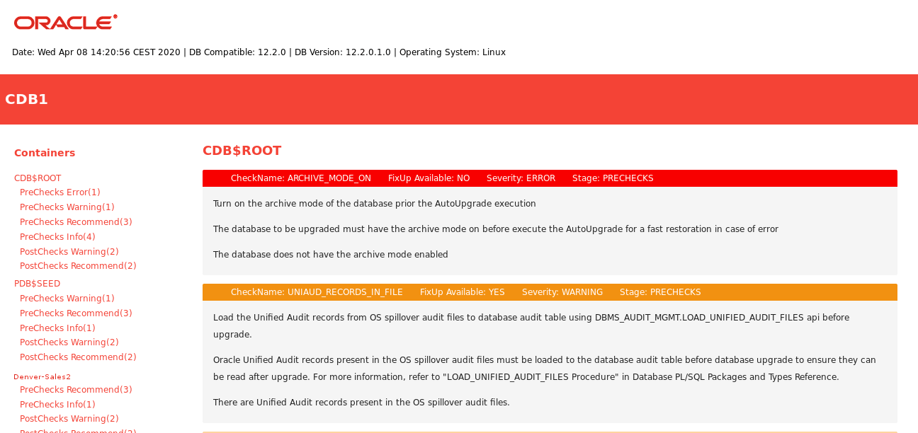

Checking the Upgrade Checks Overview File
Learn how to use the AutoUpgrade Upgrade Checks Overview file to prepare for your upgrade.
log_dir parameter.
The file is written using the following format, where
log-path is the path you specify for log files,
sid is the Oracle Database system identifier (SID),
and job-number is the AutoUpgrade job number:
/log-path/sid/job-number/prechecksDB12,
and with the job number
100:/home/oracle/autoupgrade/DB12/DB12/100/prechecksReview the Upgrade Checks Overview file, and correct any errors that are reported before proceeding with the upgrade. You can also run AutoUpgrade in Fixup mode to correct many errors.
Figure 2-1 Example of the Upgrade Checks Overview File
Description of "Figure 2-1 Example of the Upgrade Checks Overview File"
In the topic area of the file the results file example shows two
report messages for CDB$ROOT, which show the name of the
check, whether or not a fixup is available that can be run using AutoUpgrade
in Fixup mode, the severity of the issue, and the stage of AutoUpgrade that
is being run.
Parent topic: Performing Preupgrade Checks Using AutoUpgrade
