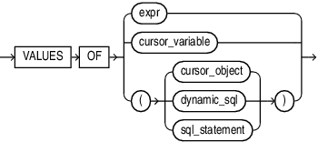

values_of_control
The element type of a collection must be assignment compatible with the iterand.
