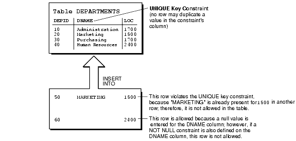

13.7 When to Use UNIQUE Constraints
Use a UNIQUE constraint (which designates a unique key) on any column or combination of columns (except the primary key) where duplicate non-NULL values are not allowed. For example:
| Unique Key | Primary Key |
Employee Social Security Number |
Employee number |
Truck license plate number |
Truck number |
Customer phone number (country code column, area code column, and local phone number column) |
Customer number |
Department name column and location column |
Department number |
Figure 13-1 shows a table with a UNIQUE constraint, a row that violates the constraint, and a row that satisfies it.
Figure 13-1 Rows That Violate and Satisfy a UNIQUE Constraint
Description of "Figure 13-1 Rows That Violate and Satisfy a UNIQUE Constraint"

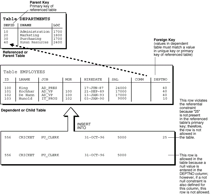

13.8 Enforcing Referential Integrity with FOREIGN KEY Constraints
When two tables share one or more columns, you use can use a FOREIGN KEY constraint to enforce referential integrity—that is, to ensure that the shared columns always have the same values in both tables.
A FOREIGN KEY constraint is also called a referential integrity constraint, and its CONSTRAINT_TYPE is R in the static data dictionary views *_CONSTRAINTS.
Designate one table as the referenced or parent table and the other as the dependent or child table. In the parent table, define either a PRIMARY KEY or UNIQUE constraint on the shared columns. In the child table, define a FOREIGN KEY constraint on the shared columns. The shared columns now comprise a foreign key. Defining additional constraints on the foreign key affects the parent-child relationship.
Figure 13-2 shows a foreign key defined on the department number. It guarantees that every value in this column must match a value in the primary key of the department table. This constraint prevents erroneous department numbers from getting into the employee table.
Figure 13-2 shows parent and child tables that share one column, a row that violates the FOREIGN KEY constraint, and a row that satisfies it.
Figure 13-2 Rows That Violate and Satisfy a FOREIGN KEY Constraint
Description of "Figure 13-2 Rows That Violate and Satisfy a FOREIGN KEY Constraint"

13.8.1 FOREIGN KEY Constraints and NULL Values
Foreign keys allow key values that are all NULL, even if there are no matching PRIMARY or UNIQUE keys.
By default (without any
NOTNULLorCHECKclauses), theFOREIGNKEYconstraint enforces the match none rule for composite foreign keys in the ANSI/ISO standard. -
To enforce the match full rule for
NULLvalues in composite foreign keys, which requires that all components of the key beNULLor all be non-NULL, define aCHECKconstraint that allows only allNULLor all non-NULLvalues in the composite foreign key. For example, with a composite key comprised of columnsA,B, andC:CHECK ((A IS NULL AND B IS NULL AND C IS NULL) OR (A IS NOT NULL AND B IS NOT NULL AND C IS NOT NULL)) -
In general, it is not possible to use declarative referential integrity to enforce the match partial rule for
NULLvalues in composite foreign keys, which requires the non-NULLportions of the key to appear in the corresponding portions in the primary or unique key of a single row in the referenced table. You can often use triggers to handle this case.See Also:
