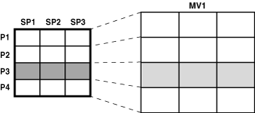

7.1.3 About Partition Change Tracking (PCT) Refresh for Materialized Views
Partition Change Tracking is the capability to leverage the knowledge about changes within individual partitions on a table contained in a materialized view for a potentially more efficient materialized refresh of the materialized view.
When there have been some partition maintenance operations on the detail tables, Partition Change Tracking is the only method of fast refresh that can be used. PCT-based refresh on a materialized view is enabled only if all the conditions described in "About Partition Change Tracking" are satisfied.
In the absence of partition maintenance operations on detail tables, when you request a FAST method (method => 'F') of refresh through procedures in DBMS_MVIEW package, Oracle uses a heuristic rule to try log-based rule fast refresh before choosing PCT refresh. Similarly, when you request a FORCE method (method => '?'), Oracle chooses the refresh method based on the following order: log-based fast refresh, PCT refresh, LPCT refresh, and complete refresh. Alternatively, you can request the PCT method (method => 'P'), and Oracle uses the PCT method provided all PCT requirements are satisfied.
Oracle can use TRUNCATE PARTITION on a materialized view if it satisfies the conditions in "Benefits of Partitioning a Materialized View" and hence, make the PCT refresh process more efficient.

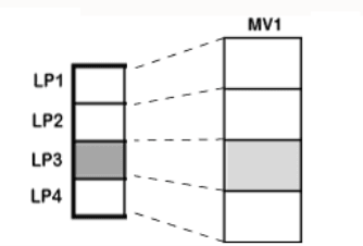

7.1.4 About Logical Partition Change Tracking (LPCT) Refresh for Materialized Views
Logical Partition Change Tracking is the capability to leverage the knowledge about changes within individual logical partitions on a table contained in a materialized view for a potentially more efficient materialized refresh of the materialized view. Unlike Partition Change Tracking which relies on the physical partitioning of tables, you define the logical partitions of your tables independently of any existing or non-existing partitioning schema of a table.
With LPCT, materialized view staleness can be tracked at the granularity of the logical partitions, and consequently the Query Rewrite engine can use the data in fresh logical partitions of the materialized view, even if some parts of the materialized may be stale. As a result, the materialized views becomes more usable. In many real-world applications, this results in significant improvement to query performance due to the fine-grained query rewrite. LPCT can perform refresh operations targeted at stale logical partitions only, which avoids complete re-loading the data.
Without LPCT, a materialized view on a non-partitioned table is either completely stale or completely fresh. When a materialized view is determined to be stale, it cannot be used for query rewrites even though the data needed by the query may be fresh.
The LPCT tracking mechanism records and consolidates the change statistics based on given LPCT key. Adjacent change data is grouped into a logical partition. During refresh, instead of using materialized view log, LPCT looks at the changes in the logical partitions. These are limited to a single column and RANGE or INTERVAL logical partitions. LPCT does not enforce partitioning of the base table. It tracks changes within defined RANGE or INTERVAL partitions in new dictionary tables. The syntax for refreshing a materialized view using LPCT refresh is as follows.
execute DBMS_MVIEW.REFRESH(<mview_name>,'L');
Unlike PCT, which must be specified at table creation, LPCT can be created, modified, or dropped on the base table at any time, independent of table creation. The base table can be partitioned or non-partitioned, which makes it more adaptable than PCT. Because the LPCT framework requires metadata only and no changes to the base table, it costs less physical overhead than PCT. LPCT can be combined with PCT to identify more fine-grained stale ranges and allow for more query rewrites and faster materialized view refresh. If a base table is both physically partitioned and also has an LPCT defined on a different partitioning key, then any dependent materialized views can be refreshed using a combined LPCT and PCT methods by specifying the 'L' option in the call to DBMS_MVIEW.REFRESH().
In tracking, LPCT is more lightweight than a materialized view log because it does not log each modified row on base table. Since it does not need to scan the entire materialized view log and join with base table for fresh data, an LPCT refresh outperforms log-based fast refresh, especially if modified rows are relatively large.
Logical Partition Change Tracking (LPCT) outperforms log-based refresh when modified rows are relatively large. An LPCT refresh can be combined with log-based refresh to improve the efficiency even more by targeting at more precise rows.

Determining the Freshness of Physical Partitions
You can check freshness of physical partitions using Partition Change Tracking (PCT). Here's an instance where there is a stale partition.
PCT Freshness
Query USER_MVIEW_DETAIL_PARTITION to access PCT freshness information for partitions, as shown in the following:
SELECT MVIEW_NAME,DETAILOBJ_NAME,DETAIL_PARTITION_NAME,
   DETAIL_PARTITION_POSITION,FRESHNESS
FROM USER_MVIEW_DETAIL_PARTITION
WHERE MVIEW_NAME = MV1;
MVIEW_NAME  DETAILOBJ_NAME  DETAIL_PARTITION_NAME  DETAIL_PARTITION_POSITION  FRESHNESS
       MV1               T1                    P1                          1      FRESH
       MV1               T1                    P2                          2      FRESH
       MV1               T1                    P3                          3      STALE
       MV1               T1                    P4                          4      FRESH
Determining the Freshness of Logical Partitions
Use Logical Partition Change Tracking (LPCT) to determine the staleness/freshness of logical partitions.
In this example, the logical partitions are LP1, LP2, LP3, and LP4. Assume that LP3 is stale.
LPCT freshness
Logical partitioning does not support subpartitions.
You can query DBA_MVIEW_DETAIL_LOGICAL_PARTITION to determine freshness of logical partitions.
SQL> SELECT MVIEW_NAME, DETAILOBJ_NAME, LPARTNAME, LPART#, FRESHNESS \
FROM DBA_MVIEW_DETAIL_LOGICAL_PARTITION WHERE MVIEW_NAME = 'MV1' ORDER BY 1,2,3,4;
MVIEW_NAME            DETAILOBJ_NAME       LPARTNAME       LPART#    FRESHNESS
       MV1                   SALES             LP1            1        FRESH
       MV1                   SALES             LP2            2        FRESH
       MV1                   SALES             LP3            3        STALE
       MV1                   SALES             LP4            4        FRESH

Example 7-5 Verifying Which Subpartitions are Fresh
Query USER_MVIEW_DETAIL_SUBPARTITION to access PCT freshness information for subpartitions, as shown in the following:
SELECT MVIEW_NAME,DETAILOBJ_NAME,DETAIL_PARTITION_NAME, DETAIL_SUBPARTITION_NAME,
    DETAIL_SUBPARTITION_POSITION,FRESHNESS
FROM USER_MVIEW_DETAIL_SUBPARTITION
MVIEW_NAME DETAILOBJ DETAIL_PARTITION DETAIL_SUBPARTITION_NAME DETAIL_SUBPARTITION_POS FRESHNESS
       MV1        T1               P1                      SP1                       1     FRESH
       MV1        T1               P1                      SP2                       1     FRESH
       MV1        T1               P1                      SP3                       1     FRESH
       MV1        T1               P2                      SP1                       1     FRESH
       MV1        T1               P2                      SP2                       1     FRESH
       MV1        T1               P2                      SP3                       1     FRESH
       MV1        T1               P3                      SP1                       1     STALE
       MV1        T1               P3                      SP2                       1     STALE
       MV1        T1               P3                      SP3                       1     STALE
       MV1        T1               P4                      SP1                       1     FRESH
       MV1        T1               P4                      SP2                       1     FRESH
       MV1        T1               P4                      SP3                       1     FRESH
