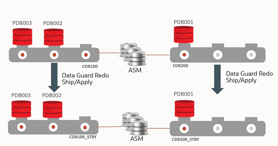

Enable Oracle Data Guard on the target CDB to create a standby database (CDB200_STBY).
The standby database must reside on the same cluster as the source standby database.
The configuration should resemble the image below.

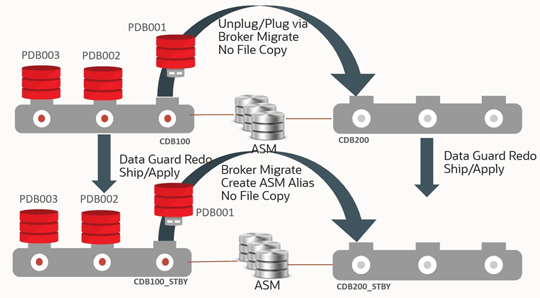

When the command is executed, it:
  1. Connects to the destination database and ASM instances to ensure credentials and connect strings are correct
  2. Performs a variety of prechecks - If any precheck fails, the command stops processing and returns control to the user, an error is returned, and no changes are made on the target CDB
  3. Creates a flashback guaranteed restore point in the destination standby CDB - This requires a short stop and start of redo apply
  4. Closes the PDB on the source primary
  5. Unplugs the PDB on the source primary - If TDE is in use, the keys are included in the manifest file generated as part of the unplug operation
  6. Drops the PDB on the source primary database with the KEEP DATAFILES clause, ensuring that the source files are not dropped
  7. Waits for the drop PDB redo to be applied to the source standby database - It must wait because the files are still owned by the source standby database until the drop redo is applied
    The command waits a maximum of TIMEOUT minutes (default 10). If the redo hasn't been applied by then the command fails and you must manually complete the process.
  8. Manages the ASM aliases for the PDB files at the standby, removing any existing aliases and creating new aliases as needed - If the standby files already exist in the correct location, all aliases for the standby copy of the PDB are removed
  9. Plugs in the PDB into the destination primary CDB - If TDE is in use, the keys are imported into the destination primary keystore as part of the plug-in
  10. Ships and applies redo for the plug-in operation to the destination CDB, which uses any created aliases (if necessary) to access the files and incorporate them into the standby database
  11. Validates that the standby files are added to the destination standby using redo apply
  12. Opens the PDB in the destination primary database
  13. Stops redo apply
  14. Drops the flashback guaranteed restore point from the destination standby database
  15. If TDE is enabled, redo apply remains stopped, if TDE is not enabled, redo apply is restarted
The image below shows the process of PDB001 unplugging from CDB100/CDB100_STBY, and plugging into CDB200/CDB200_STBY.

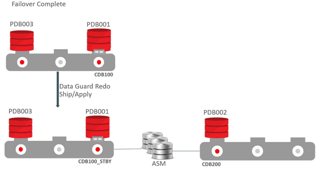

The image below shows the configuration after migration.

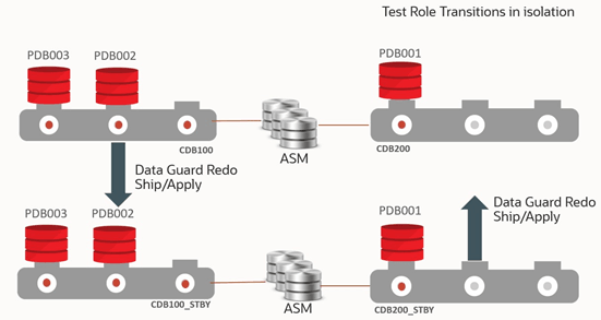

Step 7: Perform PDB role transition testing
After completing the migration, you can now perform required Oracle Data Guard role transitions or DR test with the PDB in destination CDB (CDB200). No other PDBs in the source CDB (CDB100) are impacted.
In addition, you continue to maintain the Data Guard benefits for both the source and destination CDB, such as DR readiness, Automatic Block Media Recovery for data corruptions, Fast-Start Failover to bound recovery time, Lost Write detection for logical corruptions, offloading reads to the standby to reduce scale and reduce impact of the primary, and so on. etc.
  • Connect to the destination CDB using DGMGRL and perform the switchover.
    $ dgmgrl sys@cdb200 as sysdba
    DGMGRL> switchover to CDB200_STBY;
    The image below shows the configuration after Data Guard switchover of the PDB.
    Description of pdb-switch-test.png follows
You can continue performing your DR testing for the PDB.

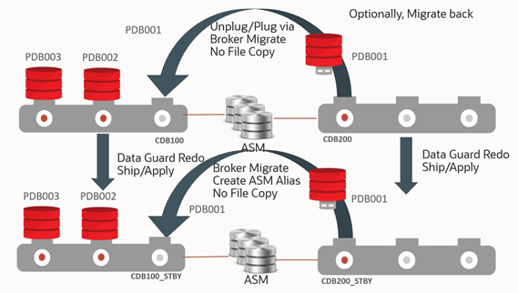

Step 8: Return the PDB to the original CDB
After migration and role transition testing, switch back to the original configuration for this CDB and migrate the PDB back to the original Data Guard configuration, again automatically maintaining the standby database files. Data Guard broker migration handles any aliases that need to be dropped or created as part of the migration process.
See Full Example Commands with Output for examples with complete output.

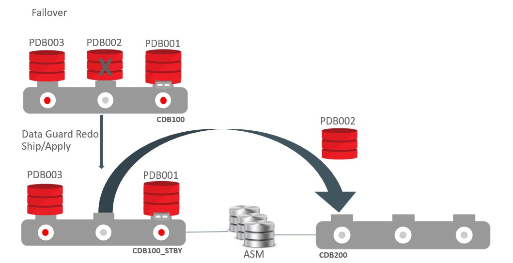

Assume that one of the source primary PDBs (PDB002) experiences a failure, as shown in the image below, which requires a long recovery period, but the failure does not impact the other PDBs (PDB001 and PDB003), and the standby for the source CDB continues to apply redo without error. The image below shows this outage scenario.
This configuration will use files from PDB002 at the standby site (CDB100_STBY) to plug into the destination CDB (CDB200) to restore read/write application access and then drop the sick PDB (PDB002) from the source primary CDB (CDB100). This will not be a native unplug operation because native unplug requires a read/write CDB and in this scenario we're extracting from the standby.

Step 5: Fail over the PDB from the standby
Fail over the sick PDB (PDB002) from the standby CDB (CDB100_STBY) to the destination CDB (CDB200).
  1. Start a DGMGRL session connecting to the source configuration standby database (CDB100_STBY).
    You must connect to the source standby database as SYSDBA using something similar to the following:
    $ dgmgrl
    DGMGRL> connect sys@cdb100_stby_inst1 as sysdba
  2. Run the DGMGRL MIGRATE PLUGGABLE DATABASE command to perform the failover.
    The DGMGRL FAILOVER command has a similar format to the MIGRATE PLUGGABLE DATABASE command.
    Do not use the STANDBY FILES keyword for the failover operation.
    If data loss is detected (SCN in the header of the first SYSTEM tablespace standby data file is less than the corresponding SCN of the file in the primary) and IMMEDIATE has not been specified, the MIGRATE PLUGGABLE DATABASE command will fail. The most common reason is that the PDB in the primary CDB is still open, the PDB on the primary should be closed before attempting a failover.
    You must resolve the SCN discrepancy or accept the data loss with the IMMEDIATE clause.
  3. Fail over the PDB
    The CONNECT alias should connect to the destination primary instance that is on the same host as the broker CLI session/source standby database instance to ensure that the plug-in operation can access the PDB unplug manifest file that will be created.
    In the following examples, you will be prompted for the SYSDBA password for the destination CDB (CDB200) when the broker attempts to connect to the CDB200_INST1 instance.
    • For non-TDE enabled environments:
      DGMGRL> migrate pluggable database PDB002 to container CDB200
       using '/tmp/PDB002.xml>' connect as sys@”CDB200_INST1”;
    • For TDE enabled environments:
       secret “some_value”
       keystore identified by “destination_keystore_password”
       keyfile ‘/tmp/pdb002_key.dat’
       source keystore identified by “source_keystore_password”;
      In TDE environments, if SECRET, KEYSTORE, KEYFILE, or SOURCE KEYSTORE are not specified in the command line, the MIGRATE command fails. You can also use PROMPT SECRET, PROMPT KEYSTORE, PROMPT SOURCE KEYSTORE to provide a password using command line input during the migration.
Once the connection to the destination is established the command will:
  1. Perform all necessary validations for the failover operation
  2. If TDE is enabled, export the TDE keys for the PDB from the source standby keystore
  3. Stop redo apply on the source standby if it is running
  4. Create the manifest on the standby at the location specified in the command using the DBMS_PDB.DESCRIBE command
  5. Disable recovery of the PDB at the source standby
  6. If TDE is enabled, import TDE keys into the destination CDB keystore to allow the plug-in to succeed
  7. Plug in the PDB in the destination database using the standby's data files (NOCOPY clause) and with STANDBYS=NONE.
  8. Open the PDB in all instances of the destination primary database
  9. If TDE is enabled, issue ADMINISTER KEY MANAGEMENT USE KEY in the context of the PDB to associate the imported key and the PDB.
  10. Unplug the PDB from the source primary. If errors occur on unplug messaging is provided to user to perform cleanup manually
  11. If unplug succeeds, drop the PDB from the source primary with the KEEP DATAFILES clause. This will also drop the PDB in all of the source standby databases.
The image below shows the environment during failover.

The image below shows the environment after failover.
And this image shows the environment after enabling recovery.
Step 9: Optionally to Migrate Back
See the migration steps in Configuring PDB Switchover.

 standby multitenant container database TB19MIG1_STB.",
      "13:29:17 Creating pluggable database TBM1_PDB1 on multitenant container
 database tb19mig2.",
      "13:29:19 Checking whether standby multitenant container database
 TB19MIG2_STB has added all data files for pluggable database TBM1_PDB1.",
      "13:29:19 Stopping Redo Apply services on multitenant container database
 TB19MIG2_STB.",
      "13:29:22 Opening pluggable database TBM1_PDB1 on all instances of
 multitenant container database tb19mig2.",
      "13:29:26 The guaranteed restore point \"grp_20250409132833_1246692955\"
 was dropped for multitenant container database \"TB19MIG2_STB\".",
      "13:29:26 Please complete the following steps to finish the operation:",
      "13:29:26 Copy keystore located in
 /var/opt/oracle/dbaas_acfs/tb19mig2/wallet_root/tde/ for migration destination
 primary database to /var/opt/oracle/dbaas_acfs/tb19mig2/wallet_root/tde/ for
 migration destination standby database.",
      "13:29:26 Start DGMGRL, connect to multitenant container database tb19mig2,
 and issue command \"EDIT DATABASE TB19MIG2_STB SET STATE=APPLY-ON\".",
"13:29:26 If the Oracle Clusterware is configured on multitenant container
 database tb19mig2, add all non-default services for the migrated pluggable
 database in Cluster Ready Services.",
 database TB19MIG2_STB, add all non-default services for the migrated pluggable
      "13:29:26 Migration of pluggable database TBM1_PDB1 completed.",
      "13:29:26 Succeeded."
Example 40-3 Migrate with TDE
DGMGRL> MIGRATE PLUGGABLE DATABASE PDB001 TO CONTAINER CDB200 USING
 ‘/tmp/pdb001.xml’
 CONNECT AS sys/password@cdb200_inst1 SECRET "some_value"
 KEYSTORE IDENTIFIED BY "destination_TDE_keystore_passwd"
 STANDBY FILES sys/standby_ASM_sys_passwd@standby_asm_inst1
 SOURCE STANDBY cdb100_stby DESTINATION STANDBY cdb200_stby;
Master keys of the pluggable database PDB001 to need to be migrated.
Keystore of pluggable database PDB001 is open.
Beginning migration of pluggable database PDB001.
Source multitenant container database is cdb100.
Destination multitenant container database is cdb200.
Connecting to "+ASM1".
Connected as SYSASM.
Stopping Redo Apply services on multitenant container database cdb200_stby.
The guaranteed restore point "..." was created for multitenant container
 database "cdb200_stby".
Restarting redo apply services on multitenant container database cdb200_stby.
Closing pluggable database PDB001 on all instances of multitenant container
 database cdb100.
Unplugging pluggable database PDB001 from multitenant container database cdb100.
Pluggable database description will be written to /tmp/pdb001.xml
Dropping pluggable database PDBT001 from multitenant container database cdb100.
Waiting for the pluggable database PDB001 to be dropped from standby multitenant
 container
database cdb100_stby.
Creating pluggable database PDB1001 on multitenant container database cdb200.
Checking whether standby multitenant container database cdb200_stby has added
 all data files for pluggable database PDB001.
Opening pluggable database PDB001 on all instances of multitenant container
 database cdb400.
The guaranteed restore point "..." was dropped for multitenant container
1. Copy keystore located in <cdb200 primary keystore location> for migration
 destination primary database to <cdb200 standby keystore location> for
2. Start DGMGRL, connect to multitenant container database cdb200_stby, and
 issue command "EDIT DATABASE cdb200_stby SET STATE=APPLY-ON".
3. If the clusterware is configured on multitenant container databases cdb200
 or cdb200_stby, add all non-default services for the migrated pluggable
 database in cluster ready services.
Migration of pluggable database PDB001 completed.
Succeeded.
Example 40-4 Failover without TDE
DGMGRL> migrate pluggable database PDB002 immediate to container CDB200
 using '/tmp/<pdb002.xml>';
Username: USERNAME@cdb200
Password:
Connected to "cdb200"
Connected as SYSDBA.
Beginning migration of pluggable database pdb002.
Source multitenant container database is cdb100_stby.
Connected to "cdb100"
Closing pluggable database pdb002 on all instances of multitenant container
 database cdb100.
Continuing with migration of pluggable database pdb002 to multitenant container
 database cdb200.
Stopping Redo Apply services on source multitenant container database cdb100_stby.
Succeeded.
Pluggable database description will be written to /tmp/pdb002.xml.
Disabling media recovery for pluggable database pdb002.
Restarting redo apply services on source multitenant container database cdb100_stby.
Succeeded.
Creating pluggable database pdb002 on multitenant container database cdb200.
Opening pluggable database pdb002 on all instances of multitenant container
 database cdb200.
Unplugging pluggable database pdb002 from multitenant container database cdb100.
Pluggable database description will be written to /tmp/pdb002_temp.xml.
Dropping pluggable database pdb002 from multitenant container database cdb100.
Unresolved plug in violations found while migrating pluggable database pdb002
 to multitenant container database cdb200.
Please examine the PDB_PLUG_IN_VIOLATIONS view to see the violations that need to be
 resolved.
Migration of pluggable database pdb002 completed.
Succeeded.

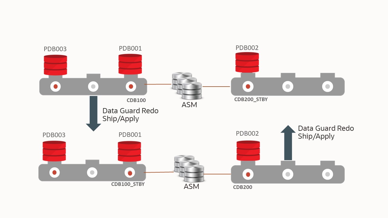

Example 40-5 Failover with TDE
NOTE: ORA-46655 errors in the output can be ignored.
 using '/tmp/PDB002.xml>' connect as sys@”CDB200” secret “some_value”
Master keys of the pluggable database PDB002 need to be migrated.
Keystore of pluggable database PDB002 is open.
Beginning migration of pluggable database PDB002.
Source multitenant container database is adg.
Connected to "cdb1001"
Exporting master keys of pluggable database PDB002.
Continuing with migration of pluggable database PDB002 to multitenant container
 database cdb200.
Stopping Redo Apply services on multitenant container database adg.
Pluggable database description will be written to /tmp/PDB002.xml.
Closing pluggable database PDB002 on all instances of multitenant container
 database adg.
Disabling media recovery for pluggable database PDB002.
Restarting redo apply services on multitenant container database adg.
Unplugging pluggable database PDB002 from multitenant container database cdb100.
Pluggable database description will be written to /tmp/ora_tfilSxnmva.xml.
Dropping pluggable database PDB002 from multitenant container database cdb100.
Importing master keys of pluggable database PDB002 to multitenant container
 database cdb200.
Creating pluggable database PDB002 on multitenant container database cdb200.
Opening pluggable database PDB002 on all instances of multitenant container
 database cdb200.
ORA-46655: no valid keys in the file from which keys are to be imported
 database cdb200.
 database cdb200.
If the Oracle Clusterware is configured on multitenant container database CDB200,
 add all non-default services for the migted pluggable database in Cluster Ready
 Services.
Migration of pluggable database PDB002 completed.
Succeeded.

PDB Failover
Source primary database
CDB100 =
          (DESCRIPTION =
            (CONNECT_TIMEOUT=120)(TRANSPORT_CONNECT_TIMEOUT=90)(RETRY_COUNT=3)
            (ADDRESS =
                (PROTOCOL = TCP)
                (HOST = <source-primary-scan-name>)
                (PORT = <source-primary-listener-port>)
            (CONNECT_DATA =
              (SERVER = DEDICATED)
              (SERVICE_NAME = <source-primary-cdb$root-service-name>)
              (FAILOVER_MODE =
                  (TYPE = select)
                  (METHOD = basic)
Source standby database
CDB100_STBY =
          (DESCRIPTION =
            (ADDRESS =
                (PROTOCOL = TCP)
                (HOST = <source-standby-scan-name>)
                (PORT = <source-standby-listener-port>)
            (CONNECT_DATA =
              (SERVICE_NAME = <source-standby-cdb$root-service-name>)
              (FAILOVER_MODE =
                  (TYPE = select)
                  (METHOD = basic)
Source standby database local instance
This must connect to an instance on the same host that dgmgrl is being executed
CDB100_STBY_INST1=
    (DESCRIPTION=
      (ADDRESS=
        (PROTOCOL= TCP)
        (HOST= <source-standby-scan-name>)
        (PORT= <source-standby-listener-port>))
      (CONNECT_DATA=
        (SERVER= DEDICATED)
        (SERVICE_NAME= <source-standby-cdb$root-service-name>)
        (INSTANCE_NAME = <source-standby-local-instance-name>)
Destination primary database
CDB200=
    (DESCRIPTION=
      (ADDRESS=
        (PROTOCOL= TCP)
      (CONNECT_DATA=
        (SERVER= DEDICATED)
        (SERVICE_NAME= <destination-primary-cdb$root-service-name>)))
Destination primary local instance
CDB200_INST1=
    (DESCRIPTION=
      (ADDRESS=
        (PROTOCOL= TCP)
      (CONNECT_DATA=
        (SERVER= DEDICATED)
        (INSTANCE_NAME = <destination-primary-local-instance-name>)
