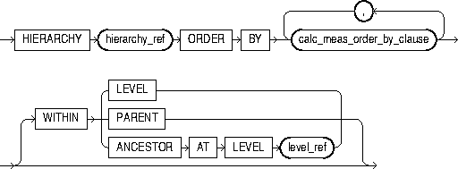

calc_meas_order_by_clause::=

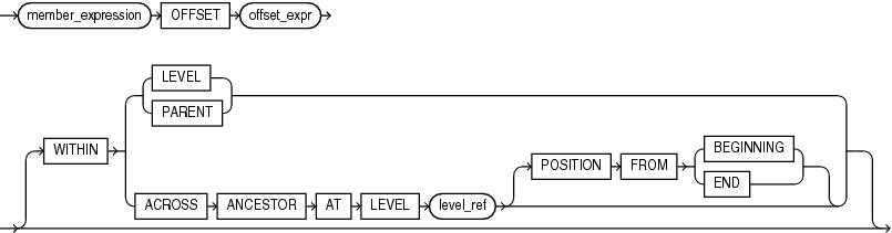

hier_lead_lag_expression::=
hier_lead_lag_clause::=

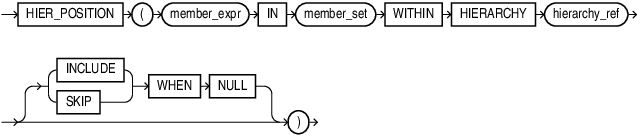

hier_cond::=
hier_position::=

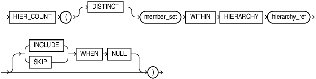

hier_count::=

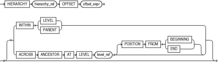

lead_lag_clause
Specifies the hierarchy to evaluate and an offset value. The parameters of the lead_lag_clause
are the following:
HIERARCHY
hierarchy_ref
specifies the alias of a hierarchy as defined in the analytic view. -
OFFSET
offset_expr
specifies acalc_meas_expression
that resolves to a number. The number specifies how many members to move either forward or backward from the current member. The ordering of members within a level is determined by the definition of the attribute dimension used by the hierarchy. -
WITHIN
LEVEL
specifies locating the related member by moving forward or backward by the offset number of members within the members that have the same level depth as the current member. The ordering of members within the level is determined by the definition of the attribute dimension used by the hierarchy.The
WITHIN
LEVEL
operation is the default if neither theWITHIN
LEVEL
nor theACROSS
ANCESTOR
AT
LEVEL
keywords are specified. -
WITHIN
PARENT
specifies locating the related member by moving forward or backward by the offset number of members within the members that have the same parent as the current member. -
ACROSS
ANCESTOR
AT
LEVEL
level_ref
specifies locating the related member by navigating up to the ancestor (or to the member itself if no ancestor exists) of the current member at the level specified bylevel_ref
, and noting the position of each ancestor member (including the member itself) within its parent. Thelevel_ref
parameter is the name of a level in the specified hierarchy.Once the ancestor member is found, navigation moves either forward or backward the offset number of members within the members that have the same depth as the ancestor member. After locating the related ancestor, navigation proceeds back down the hierarchy from this member, matching the position within the parent as recorded on the way up (in reverse order). The position within the parent is either an offset from the first child or the last child depending on whether
POSITION
FROM
BEGINNING
orPOSITION
FROM
END
is specified. The default value isPOSITION
FROM
BEGINNING

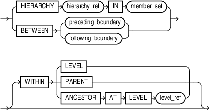

The av_window_clause
parameter selects a range of members related to the current member. The range is between the members specified by the preceding_boundary
or following_boundary
parameters. The range is always computed over members at the same level as the current member.
Use IN member_set
to specify an arbitrary member set to be used as the window for the window expression.
The parameters for a av_window_clause
are the following:
HIERARCHY
hierarchy_ref
specifies the alias of the hierarchy as defined in the analytic view. -
BETWEEN
preceding_boundary
orfollowing_boundary
defines the set of members to relate to the current member. -
WITHIN
LEVEL
selects the related members by applying the boundary clause to all members of the current level. This is the default when theWITHIN
keyword is not specified. -
WITHIN
PARENT
selects the related members by applying the boundary clause to all members that share a parent with the current member. -
WITHIN
ANCESTOR
AT
LEVEL
selects the related members by applying the boundary clause to all members at the current depth that share an ancestor (or is the member itself) at the specified level with the current member. The value of the window expression isNULL
if the current member is above the specified level. If the level is not in the specified hierarchy, then an error occurs.

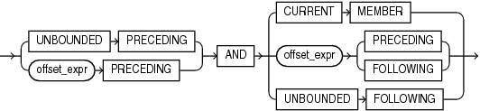

preceding_boundary
The preceding_boundary
parameter defines a range of members from the specified number of members backward in the level from the current member and forward to the specified end of the boundary. The following parameters specify the range:
UNBOUNDED
PRECEDING
begins the range at the first member in the level. -
offset_expr
PRECEDING
begins the range at theoffset_expr
number of members backward from the current member. Theoffset_expr
expression is acalc_meas_expression
that resolves to a number. If the offset number is greater than the number of members from the current member to the first member in the level, than the first member is used as the start of the range. -
CURRENT
MEMBER
ends the range at the current member. -
offset_expr
PRECEDING
ends the range at the member that isoffset_expr
backward from the current member. -
offset_expr
FOLLOWING
forward from the current member. -
UNBOUNDED
FOLLOWING
ends the range at the last member in the level.
following_boundary
The following_boundary
parameter defines a range of members from the specified number of members from the current member forward to the specified end of the range. The following parameters specify the range:
CURRENT
MEMBER
begins the range at the current member. -
offset_expr
FOLLOWING
begins the range at the member that isoffset_expr
offset_expr
FOLLOWING
UNBOUNDED
FOLLOWING

rank_clause
The rank_clause
locates a range of hierarchy members related to the current member. The range is some subset of the members in the same level as the current member. The subset is determined from the WITHIN
clause.
Valid values for the WITHIN
clause are:
WITHIN LEVEL
, which specifies that the related members are all the members of the current level. This is the default subset if theWITHIN
WITHIN PARENT
, which specifies that the related members all share a parent with the current member -
WITHIN ANCESTOR AT LEVEL
, which specifies that the related members are all of the members of the current level that share an ancestor (or self) at the specified level with the current member.
Navigates from the specified member to a related member by moving forward or backward some number of members within the context hierarchy. The HIER_LEAD
keyword returns a later member. The HIER_LAG
keyword returns an earlier member.
Navigates the offset_expr
number of members forward or backward from the specified member. The ordering of members within a level is specified in the definition of the attribute dimension.
The optional parameters of hier_lead_lag_clause
are the following:
WITHIN
LEVEL
locates the related member by moving forward or backwardoffset_expr
members within the members that have the same depth as the current member. The ordering of members within the level is determined by the definition of the attribute dimension. TheWITHIN
LEVEL
nor theACROSS
keywords are used. -
WITHIN
PARENT
members within the members that have the same depth as the current member, but only considers members that share a parent with the current member. The ordering of members within the level is determined by the definition of the attribute dimension. -
WITHIN
ACROSS
ANCESTOR
AT
LEVEL
locates the related member by navigating up to the ancestor of the current member (or to the member itself) at the specified level, noting the position of each ancestor member (including the member itself) within its parent. Once the ancestor member is found, navigation moves forward or backwardoffset_expr
members within the members that have the same depth as the ancestor member.After locating the related ancestor, navigation moves back down the hierarchy from that member, matching the position within the parent as recorded on the way up (in reverse order). The position within the parent is either an offset from the first child or the last child depending on whether
POSITION
FROM
BEGINNING
orPOSITION
FROM
END
is specified, defaulting toPOSITION
FROM
BEGINNING

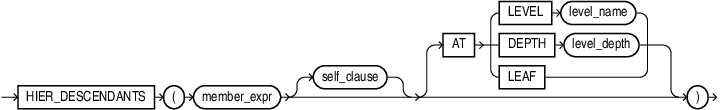

hier_descendants
Returns a member set consisting of all descendants of the specified member, optionally including the member itself. If the AT
clause is specified, the set of descendants are filtered to only include members at the specified level or depth. If the member has no descendants (i.e. is a leaf) optionally filtered to the given level and self is excluded, an empty set is returned.

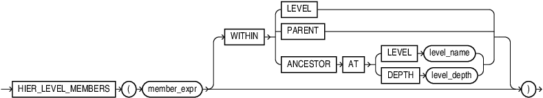

hier_level_members
Returns a member set consisting of members at the same level as the given member that have a common ancestor as defined by the WITHIN
clause. This function always includes self. WITHIN PARENT
returns all members that are children of the given member’s parent. WITHIN ANCESTOR AT
returns all members at the same level as the given member that have the same ancestor at the specified level. WITHIN LEVEL
returns all members at the same level as the given member. If the WITHIN
clause is omitted, the default is WITHIN LEVEL

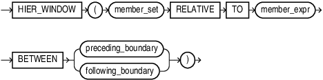

hier_window
Returns all members in order from the given set which fall within the specified boundary relative to the given member. If the given member is not in the given set, an empty set is returned.

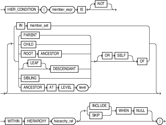

hier_cond
Use IN
member_set
to specify an arbitrary member set to use for the comparison.
hier_position
Returns the numeric 1-based position of the first occurrence of the member identified by mbr_expr in the specified member set, with references to CURRENT MEMBER
referring to the current member in the set to which it is being applied. If the member does not appear in the set, NULL
is returned. This could be useful if a user wanted to order the output of a query based on the set order.
hier_count
Returns the number of members in the member set. If the DISTINCT
keyword is included, returns the number of distinct members in the member set.
