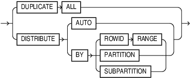

vector_index_hnsw_replication_clause
If neither
DUPLICATEnorDISTRIBUTEclause is specified, the default isDUPLICATE ALL. -
Specifying
DISTRIBUTEwith no other qualifiers defaults toDISTRIBUTE AUTO. -
In
DISTRIBUTE AUTOmode:-
Non-partitioned tables are distributed by
ROWID RANGE. -
Partitioned or sub-partitioned tables are distributed by
[SUB]PARTITION.
You may specify either
DUPLICATE ALLorDISTRIBUTE, but not both.
