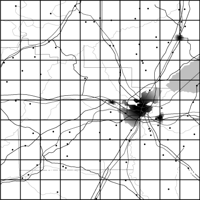

A power utility, Power-To-The-People, develops a sophisticated model to decide how to deploy its resources. The region served by the utility is represented by a grid laid over a geographic area. This grid is illustrated in Figure 15-1.
Figure 15-1 Region Served by the Power Utility
Description of Figure 15-1 follows
Description of "Figure 15-1 Region Served by the Power Utility"
This region may be surrounded by other regions some of whose power needs are supplied by other utilities. As pictured, every region is composed of geographic quadrants, called cells, on a 10x10 grid. There are several ways of identifying cells — by spatial coordinates (longitude/latitude), by a matrix numbering (1,1; 1,2;...), and by numbering them sequentially, as illustrated in Figure 15-2.

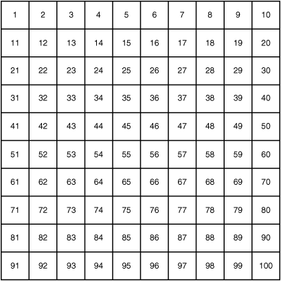

Figure 15-2 Regional Grid Cells in Numbered Sequence
Description of Figure 15-2 follows
Description of "Figure 15-2 Regional Grid Cells in Numbered Sequence"
Within the area represented by each cell, the power used by consumers in that area is recorded each hour. For example, the power demand readings for a particular hour might be represented by Table 15-1 (cells here represented on a matrix).

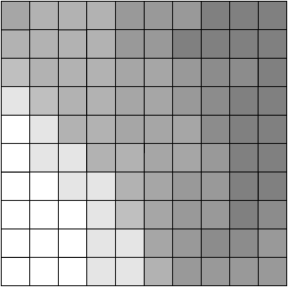

  • Satellite cameras provide images regarding current conditions that are converted into grayscale images that match the grid illustrated in Figure 15-3.
Figure 15-3 Grayscale Representation of Satellite Image
Description of Figure 15-3 follows
Description of "Figure 15-3 Grayscale Representation of Satellite Image "
These images are designed so that lighter is colder. Thus, the image shows a cold front moving into the region from the south-west. By correlating the data provided by the grayscale images with temperature readings taken at the same time, the utility has been able to determine what the power demand is given weather conditions viewed from the stratosphere.
The reason that this is important is that a crucial part of this modeling has to do with noting the rapidity and degree of change in the incoming reports as weather changes and power is deployed. The following diagram shows same cold front at a second recording, illustrated in Figure 15-4.

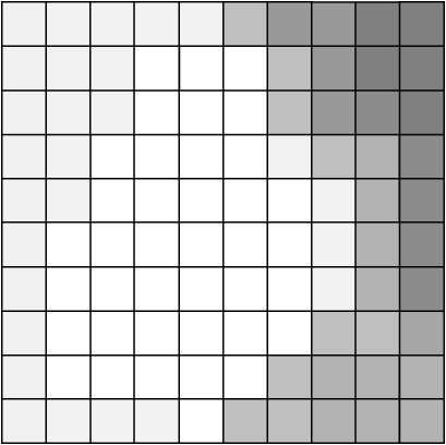

Figure 15-4 Grayscale Representation of Weather Conditions at Second Recording
Description of Figure 15-4 follows
Description of "Figure 15-4 Grayscale Representation of Weather Conditions at Second Recording"
By analyzing the extent and speed of the cold front, the utility is able to project what the conditions are likely to be in the short and medium term, as in Figure 15-5.

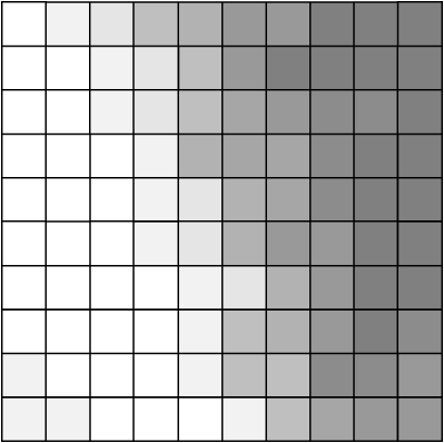

Figure 15-5 Grayscale Representation of Conditions as Projected
Description of Figure 15-5 follows
Description of "Figure 15-5 Grayscale Representation of Conditions as Projected "
By combing the data about these conditions and other anomalous situations (such as the failure of a substation), the utility must be able to organize the most optimal deployment of its resources. Figure 15-6 reflects the distribution of substations across the region.

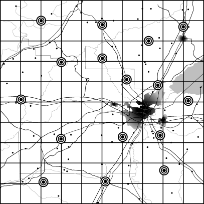

Figure 15-6 Distribution of Power Stations Across the Region
Description of Figure 15-6 follows
Description of "Figure 15-6 Distribution of Power Stations Across the Region"

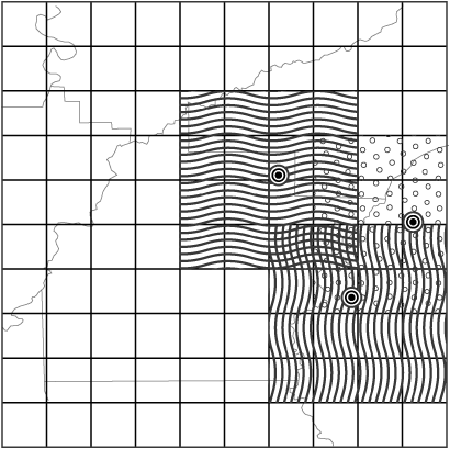

The distribution of power stations means that the utility can redirect its deployment of electricity to the areas of greatest need. Figure 15-7 gives a pictorial representation of the overlap between three stations.
Figure 15-7 Areas Served by Three Power Stations
Description of Figure 15-7 follows
Description of "Figure 15-7 Areas Served by Three Power Stations"

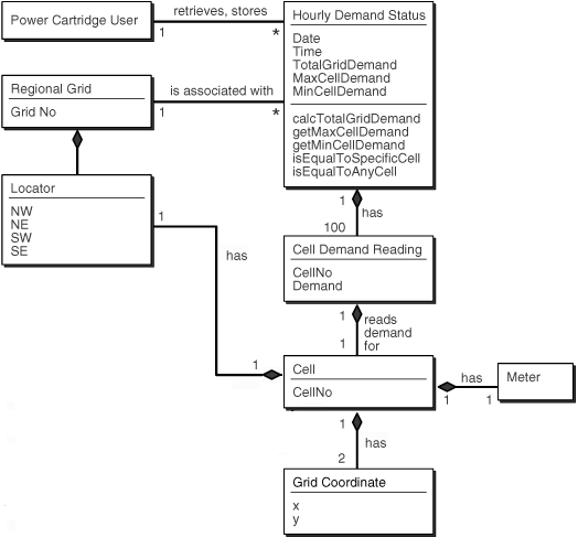

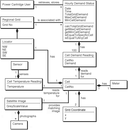

15.2 Modeling the Application
Consider a technical and business scenario for modeling an application. The Class Diagram in Figure 15-8 describes the application objects using the Unified Modelling Language (UML) notation.
Figure 15-8 Application Object Model of the Power Demand Cartridge
Description of Figure 15-8 follows
Description of "Figure 15-8 Application Object Model of the Power Demand Cartridge"
