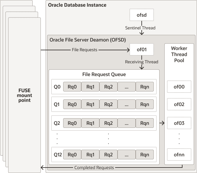

When an instance starts, the OFSD process gets spawned on operating system platforms, such as Linux, where OFS is supported. OFSD is multi-threaded and non-fatal. It serves both file system management requests and file requests from each mounted file system.
The centralized server background process model of OFS allows multiple file systems to be mounted and accessed using a limited set of server threads. It allows better resource sharing and a linear scalability with new file server threads created on demand. Both memory and CPU used by these threads are controlled through system wide parameters set in the RDBMS instance.
OFSD process starts two types of threads: receiver thread and worker thread. The receiver thread receives requests from the mounted file system. The name of this thread name is similar to of01
. The requests received by this thread are placed in a submit queue which is served by different worker threads. The submit queue is hash partitioned to efficiently distribute the incoming requests across all the worker threads. By default, OFSD starts 3 worker threads. You can update the value of the OFS_THREADS
parameter to increase the number of worker thread.
OFSD supports these 2 types of file systems: DBFS and OFS.
Use the DBMS_FS
PL/SQL procedures to create, mount, and work with the file systems managed by the OFSD process.
OFSD uses a pool of worker threads to serve requests from multiple file systems that are mounted on the instance. Use V$OFSMOUNT
to query the mounted file systems. The response that is returned is specific to each PDB. It lists only the file systems that are mounted in the specified PDB.
