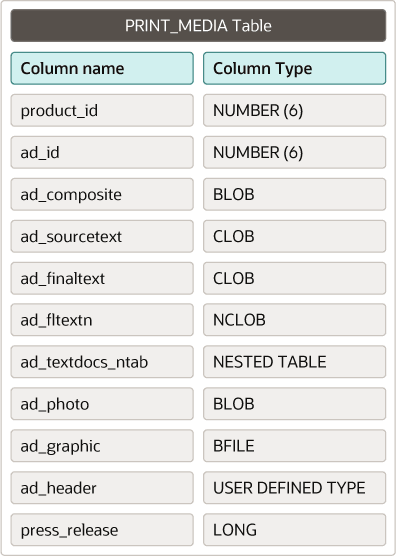

Most of the in the following sections use print_media
table. Following
is the structure of print_media
table:
