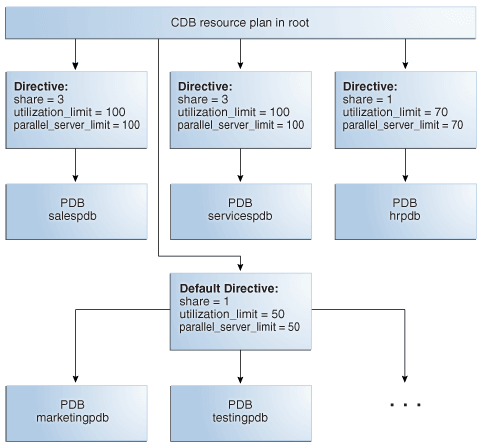

Using Oracle Resource Manager (Resource Manager), you can create CDB resource plans and set initialization parameters to allocate resources to PDBs.
In a CDB, multiple workloads within multiple PDBs can complete for system and CDB resources. Resource Manager can manage resources on two levels: CDB and PDB.

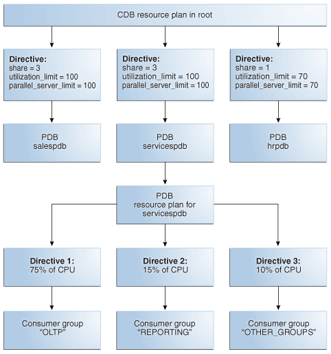

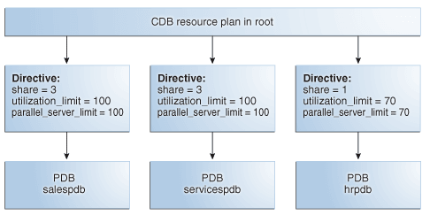

CDB Resource Plans

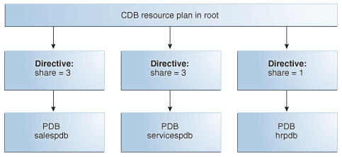

A CDB resource plan allocates resources to its PDBs according to its set of resource plan directives (directives). A parent-child relationship exists between a CDB resource plan and its directives. Each resource plan directive references either a set of PDBs or an individual PDB.
A performance profile specifies shares of system resources for a set of PDBs. PDB performance profiles enable you to manage resources for large numbers of PDBs by specifying Resource Manager directives for profiles instead of individual PDBs.
The directives control allocation of CPU and parallel execution servers. A directive can control the allocation of resources to PDBs based on the share value that you specify for each PDB or PDB performance profile. A higher share value results in more guaranteed resources. For PDBs and PDB performance profiles, you can also set utilization limits for CPU and parallel servers.
You can create a CDB resource plan by using the CREATE_CDB_PLAN procedure in the DBMS_RESOURCE_MANAGER PL/SQL package, and set a CDB resource plan using the RESOURCE_MANAGER_PLAN parameter. You create directives for a CDB resource plan by using the CREATE_CDB_PLAN_DIRECTIVE procedure.
PDB Resource Plans
A CDB resource plan allocates a portion of the system resources to a PDB. A PDB resource plan determines how this portion is allocated within the PDB.
You can create a PDB resource plan by using the CREATE_PLAN procedure in the DBMS_RESOURCE_MANAGER PL/SQL package, and set a PDB resource plan using the RESOURCE_MANAGER_PLAN parameter. You create directives for a PDB resource plan by using the CREATE_PLAN_DIRECTIVE procedure.

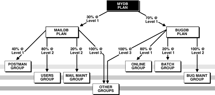

Consumer Groups, Plans, and Plan Directives
Resource Manager includes several elements that you can manage.
About the Elements of Resource Manager
The elements of the Resource Manager include resource consumer groups, resource plans, and resource plan directives.
Element Description
Resource consumer group
A group of sessions that are grouped together based on resource requirements. The Resource Manager allocates resources to resource consumer groups, not to individual sessions.
Resource plan
A container for directives that specify how resources are allocated to resource consumer groups. You specify how the database allocates resources by activating a specific resource plan.
Resource plan directive
Associates a resource consumer group with a particular plan and specifies how resources are to be allocated to that resource consumer group.
You use the DBMS_RESOURCE_MANAGER PL/SQL package to create and maintain these elements. The elements are stored in tables in the data dictionary. You can view information about them with data dictionary views.

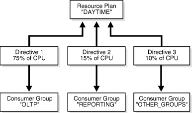

About Resource Plan Directives
The Resource Manager allocates resources to consumer groups according to the set of resource plan directives (directives) that belong to the currently active resource plan.
There is a parent-child relationship between a resource plan and its resource plan directives. Each directive references one consumer group, and no two directives for the currently active plan can reference the same consumer group.
A directive has several ways in which it can limit resource allocation for a consumer group. For example, it can control how much CPU the consumer group gets as a percentage of total CPU, and it can limit the total number of sessions that can be active in the consumer group.
CDB resource plan allocates resources to its PDBs according to its set of resource plan directives (directives). A parent-child relationship exists between a CDB resource plan and its resource plan directives. Each directive references either a set of PDBs in a performance profile, or a single PDB. You can specify directives for both individual PDBs and for PDB performance profiles in the same CDB. No two directives for the currently active plan can reference the same PDB or the same PDB performance profile.

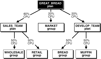

CPU
To manage CPU resources, Resource Manager allocates resources among consumer groups and redistributes CPU resources that were allocated but were not used. You can also set a limit on the amount of CPU resources that can be allocated to a particular consumer group.
Management Attributes
Management attributes enable you to specify how CPU resources are to be allocated among consumer groups and subplans.
Multiple levels of CPU resource allocation (up to eight levels) provide a means of prioritizing CPU usage within a plan. Consumer groups and subplans at level 2 get resources that were not allocated at level 1 or that were allocated at level 1 but were not completely consumed by a consumer group or subplan at level 1. Similarly, resource consumers at level 3 are allocated resources only when some allocation remains from levels 1 and 2. The same rules apply to levels 4 through 8. Multiple levels not only provide a way of prioritizing, but they provide a way of explicitly specifying how all primary and leftover resources are to be used.
Use the management attributes MGMT_Pn, where n is an integer between 1 and 8, to specify multiple levels of CPU resource allocation. For example, use the MGMT_P1 directive attribute to specify CPU resource allocation at level 1 and MGMT_P2 directive attribute to specify resource allocation at level 2.
Use management attributes with parallel statement directive attributes, such as Degree of Parallelism Limit and Parallel Server Limit, to control parallel statement queuing. When parallel statement queuing is used, management attributes are used to determine which consumer group is allowed to issue the next parallel statement. For example, if you set the MGMT_P1 directive attribute for a consumer group to 80, that group has an 80% chance of issuing the next parallel statement.
See Also:
Oracle Database VLDB and Partitioning Guide for information about parallel statement queuing
Table 27-1 illustrates a simple resource plan with three levels.
Table 27-1 A Simple Three-Level Resource Plan
Consumer Group Level 1 CPU Allocation Level 2 CPU Allocation Level 3 CPU Allocation
HIGH_GROUP
80%
LOW_GROUP
50%
MAINT_SUBPLAN
50%
OTHER_GROUPS
100%
High priority applications run within HIGH_GROUP, which is allocated 80% of CPU. Because HIGH_GROUP is at level one, it gets priority for CPU utilization, but only up to 80% of CPU. This leaves a remaining 20% of CPU to be shared 50-50 by LOW_GROUP and the MAINT_SUPLAN at level 2. Any unused allocation from levels 1 and 2 are then available to OTHER_GROUPS at level 3. Because OTHER_GROUPS has no sibling consumer groups or subplans at its level, 100% is specified.
Within a particular level, CPU allocations are not fixed. If there is not sufficient load in a particular consumer group or subplan, residual CPU can be allocated to remaining consumer groups or subplans. Thus, when there is only one level, unused allocation by any consumer group or subplan can be redistributed to other "sibling" consumer groups or subplans. If there are multiple levels, then the unused allocation is distributed to the consumer groups or subplans at the next level. If the last level has unused allocations, these allocations can be redistributed to all other levels in proportion to their designated allocations.
As an example of redistribution of unused allocations from one level to another, if during a particular period, HIGH_GROUP consumes only 25% of CPU, then 75% is available to be shared by LOW_GROUP and MAINT_SUBPLAN. Any unused portion of the 75% at level 2 is then made available to OTHER_GROUPS at level 3. However, if OTHER_GROUPS has no session activity at level 3, then the 75% at level 2 can be redistributed to all other consumer groups and subplans in the plan proportionally.

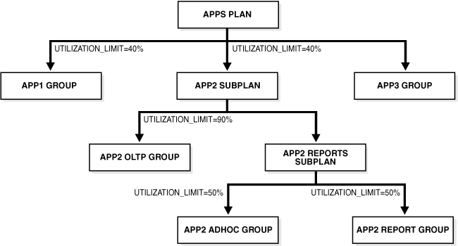

Utilization Limit
Use the UTILIZATION_LIMIT attribute to impose an absolute upper limit on CPU utilization for a resource consumer group. This absolute limit overrides any redistribution of CPU within a plan.
In the previous scenario, suppose that due to inactivity elsewhere, LOW_GROUP acquires 90% of CPU. Suppose that you do not want to allow LOW_GROUP to use 90% of the server because you do not want non-critical sessions to inundate the CPUs. The UTILIZATION_LIMIT attribute of resource plan directives can prevent this situation.
Setting the UTILIZATION_LIMIT attribute is optional. If you omit this attribute for a consumer group, there is no limit on the amount of CPU that the consumer group can use. Therefore, if all the other applications are idle, a consumer group that does not have UTILIZATION_LIMIT set can be allocated 100% of the CPU resources.
You can also use the UTILIZATION_LIMIT attribute as the sole means of limiting CPU utilization for consumer groups, without specifying level limits.
Table 27-2 shows a variation of the previous plan. In this plan, using UTILIZATION_LIMIT, CPU utilization is capped at 75% for LOW_GROUP, 50% for MAINT_SUBPLAN, and 75% for OTHER_GROUPS. (Note that the sum of all utilization limits can exceed 100%. Each limit is applied independently.)

In the example described in Table 27-2, if HIGH_GROUP is using only 10% of the CPU at a given time, then the remaining 90% is available to LOW_GROUP and the consumer groups in MAINT_SUBPLAN at level 2. If LOW_GROUP uses only 20% of the CPU, then 70% can be allocated to MAINT_SUBPLAN. However, MAINT_SUBPLAN has a UTILIZATION_LIMIT of 50%. Therefore, even though more CPU resources are available, the server cannot allocate more than 50% of the CPU to the consumer groups that belong to the subplan MAINT_SUBPLAN.
You can set UTILIZATION_LIMIT for both a subplan and the consumer groups that the subplan contains. In such cases, the limit for a consumer group is computed using the limits specified for the subplan and that consumer group. For example, the MAINT_SUBPLAN contains the consumer groups MAINT_GROUP1 and MAINT_GROUP2. MAINT_GROUP1 has UTILIZATION_LIMIT set to 40%. However, the limit for MAINT_SUBPLAN is set to 50%. Therefore, the limit for consumer group MAINT_GROUP1 is computed as 40% of 50%, or 20%. For an example of how to compute UTILIZATION_LIMIT for a consumer group when limits are specified for both the consumer group and the subplan to which the group belongs, see "Example 4 - Specifying a Utilization Limit for Consumer Groups and Subplans".

To allocate resources among PDBs, assign a share value to each PDB or performance profile. A higher share value results in more guaranteed resources for a PDB or the PDBs that use the performance profile.
Specify a share value for a PDB using the DBMS_RESOURCE_MANAGER.CREATE_CDB_PLAN_DIRECTIVE procedure and for a PDB performance profile using the DBMS_RESOURCE_MANAGER.CREATE_CDB_PROFILE_DIRECTIVE procedure. In both cases, the shares parameter specifies the share value for the PDB. Multiple PDBs can use the same PDB performance profile.
The following figure shows an example of three PDBs with share values specified for them in a CDB resource plan.
Figure 27-1 Shares in a CDB Resource Plan
Description of Figure 27-1 follows
Description of "Figure 27-1 Shares in a CDB Resource Plan"
The preceding figure shows that the total number of shares is seven (3 plus 3 plus 1). The salespdb and the servicespdb PDB are each guaranteed 3/7 of the resources, while the hrpdb PDB is guaranteed 1/7 of the resources. However, any PDB can use more than the guaranteed amount of a resource when no resource contention exists.
The following table shows the resource allocation to the PDBs in the preceding figure based on the share values. The table assumes that loads of the PDBs consume all system resources allocated.

The following figure shows an example of three PDBs with shares and utilization limits specified for them in a CDB resource plan.
Figure 27-2 Shares and Utilization Limits in a CDB Resource Plan
Description of Figure 27-2 follows
Description of "Figure 27-2 Shares and Utilization Limits in a CDB Resource Plan"
The preceding figure shows that there are no utilization limits on the salespdb and servicespdb PDBs because utilization_limit and parallel_server_limit are both set to 100% for them. However, the hrpdb PDB is limited to 70% of the applicable system resources because utilization_limit and parallel_server_limit are both set to 70%.
This scenario assumes that the PARALLEL_SERVERS_TARGET initialization parameter does not specify a lower limit in a PDB. When the PARALLEL_SERVERS_TARGET initialization parameter specifies a lower limit for parallel execution servers in a PDB, the lower limit is used.

The Default Directive for PDBs
When you do not explicitly define directives for a PDB, the PDB uses the default directive for PDBs.
The following table shows the attributes of the initial default directive for PDBs.
Table 27-6 Initial Default Directive Attributes for PDBs
Directive Attribute Value
shares
1
utilization_limit
100
100
When a PDB is plugged into a CDB and no directive is defined for it, the PDB uses the default directive for PDBs.
You can create new directives for the new PDB. You can also change the default directive attribute values for PDBs by using the UPDATE_CDB_DEFAULT_DIRECTIVE procedure in the DBMS_RESOURCE_MANAGER package.
When a PDB is unplugged from a CDB, the directive for the PDB is retained. If the same PDB is plugged back into the CDB, then it uses the directive defined for it if the directive was not deleted manually.
Figure 27-3 shows an example of the default directive in a CDB resource plan.
Figure 27-3 Default Directive in a CDB Resource Plan
Description of Figure 27-3 follows
Description of "Figure 27-3 Default Directive in a CDB Resource Plan"
Figure 27-3 shows that the default PDB directive specifies that the share is 1, the utilization_limit is 50%, and the parallel_server_limit is 50%. Any PDB that is part of the CDB and does not have directives defined for it uses the default PDB directive. Figure 27-3 shows the PDBs marketingpdb and testingpdb using the default PDB directive. Therefore, marketingpdb and testingpdb each get 1 share and utilization limits of 50.
About PDB Resource Plans
A PDB resource plan determines how the resources for a specific PDB are allocated to consumer groups within this PDB.
A PDB resource plan differs from a CDB resource plan, which determines the amount of resources allocated to each PDB. The following restrictions apply to PDB resource plans:
  • A PDB resource plan cannot have subplans.
  • A PDB resource plan cannot have a multiple-level scheduling policy.

PDB Resource Plan: Example
A one-to-many relationship exists between CDB resource plans and PDB resource plans.
The following figure shows an example of a CDB resource plan and a PDB resource plan.
Figure 27-4 A CDB Resource Plan and a PDB Resource Plan
Description of Figure 27-4 follows
Description of "Figure 27-4 A CDB Resource Plan and a PDB Resource Plan"
The preceding figure shows some of the directives in a PDB resource plan for the servicespdb PDB. Other PDBs in the CDB can also have PDB resource plans.
Example: A Simple Resource Plan
An example illustrates a simple resource plan.
Figure 27-5 shows a simple resource plan for an organization that runs online transaction processing (OLTP) applications and reporting applications simultaneously during the daytime. The currently active plan, DAYTIME, allocates CPU resources among three resource consumer groups. Specifically, OLTP is allotted 75% of the CPU time, REPORTS is allotted 15%, and OTHER_GROUPS receives the remaining 10%. Any group can use more resources than it is guaranteed if there is no resource contention. For example, OLTP is guaranteed 75% of the CPU, but if there is no resource contention, it can use up to 100% of the CPU.
Figure 27-5 A Simple Resource Plan
Description of Figure 27-5 follows
Description of "Figure 27-5 A Simple Resource Plan"
Oracle Database provides a procedure (CREATE_SIMPLE_PLAN) that enables you to quickly create a simple resource plan. This procedure is discussed in "Creating a Simple Resource Plan ".
The currently active resource plan does not enforce allocations until CPU usage is at 100%. If the CPU usage is below 100%, the database is not CPU-bound and hence there is no need to enforce allocations to ensure that all sessions get their designated resource allocation.
In addition, when allocations are enforced, unused allocation by any consumer group can be used by other consumer groups. In the previous example, if the OLTP group does not use all of its allocation, the Resource Manager permits the REPORTS group or OTHER_GROUPS group to use the unused allocation.

Example: A Resource Plan with Subplans
An example illustrates a resource plan with subplans.
In this example, the Great Bread Company allocates the CPU resource as shown in Figure 27-6. The figure illustrates a top plan (GREAT_BREAD) and all of its descendents. For simplicity, the requirement to include the OTHER_GROUPS consumer group is ignored, and resource plan directives are not shown, even though they are part of the plan. Rather, the CPU percentages that the directives allocate are shown along the connecting lines between plans, subplans, and consumer groups.
Figure 27-6 A Resource Plan With Subplans
Description of Figure 27-6 follows
Description of "Figure 27-6 A Resource Plan With Subplans"
The GREAT_BREAD plan allocates resources as follows:
  • 20% of CPU resources to the consumer group MARKET
  • 60% of CPU resources to subplan SALES_TEAM, which in turn divides its share equally between the WHOLESALE and RETAIL consumer groups
  • 20% of CPU resources to subplan DEVELOP_TEAM, which in turn divides its resources equally between the BREAD and MUFFIN consumer groups
It is possible for a subplan or consumer group to have multiple parents. An example would be if the MARKET group were included in the SALES_TEAM subplan. However, a plan cannot contain any loops. For example, the SALES_TEAM subplan cannot have a directive that references the GREAT_BREAD plan.

Creating a CDB Resource Plan for Managing PDBs: Scenario
This scenario illustrates each of the steps involved in creating a CDB resource plan for individual PDBs.
The scenario assumes that you want to create a CDB resource plan for a CDB named newcdb. The plan includes a directive for each PDB. In this scenario, you also update the default directive and the AutoTask directive.
The directives are defined using various procedures in the DBMS_RESOURCE_MANAGER package. The attributes of each directive are defined using parameters in these procedures. Table 27-12 describes the types of directives in the plan.
Table 27-12 Attributes for PDB Directives in a CDB Resource Plan
Directive Attribute Description See Also
shares
Resource allocation share for CPU and parallel execution server resources.
"Shares for Allocating Resources to PDBs"
utilization_limit
Resource utilization limit for CPU.
"Utilization Limits for PDBs"
Maximum percentage of parallel execution servers that a PDB can use before queuing parallel statements.
When the parallel_server_limit directive is specified for a PDB, the limit is the PARALLEL_SERVERS_TARGET value of the CDB root multiplied by the value of the parallel_server_limit parameter in the CREATE_CDB_PLAN_DIRECTIVE procedure.
Note: Oracle recommends using the PARALLEL_SERVERS_TARGET initialization parameter instead of the parallel_server_limit directive in a CDB plan.
Table 27-13 describes how the CDB resource plan allocates resources to its PDBs using the directive attributes described in Table 27-12.
Table 27-13 Sample Directives for PDBs in a CDB Resource Plan
PDB shares Directive utilization_limit Directive parallel_server_limit Directive
salespdb
3
Unlimited
Unlimited
servicespdb
3
Unlimited
Unlimited
hrpdb
1
70
70
Default
1
50
50
AutoTask
1
75
75
The salespdb and servicespdb PDBs are more important than the other PDBs in the CDB. Therefore, they get a higher share (3), unlimited CPU utilization resource, and unlimited parallel execution server resource.
The default directive applies to PDBs for which specific directives have not been defined. For this scenario, assume that the CDB has several PDBs that use the default directive. This scenario updates the default directive.
In addition, this scenario updates the AutoTask directive. The AutoTask directive applies to automatic maintenance tasks that are run in the root maintenance window.
To create a CDB resource plan:
  1. Create a pending area using the CREATE_PENDING_AREA procedure:
    exec DBMS_RESOURCE_MANAGER.CREATE_PENDING_AREA();
  2. Create a CDB resource plan named newcdb_plan using the CREATE_CDB_PLAN procedure:
    BEGIN
      DBMS_RESOURCE_MANAGER.CREATE_CDB_PLAN(
        plan    => 'newcdb_plan',
        comment => 'CDB resource plan for newcdb');
    END;
  3. Create the CDB resource plan directives for the PDBs using the CREATE_CDB_PLAN_DIRECTIVE procedure. Each directive specifies how resources are allocated to a specific PDB.
    Table 27-13 describes the directives for the salespdb, servicespdb, and hrpdb PDBs in this scenario. Run the following procedures to create these directives:
    BEGIN
      DBMS_RESOURCE_MANAGER.CREATE_CDB_PLAN_DIRECTIVE(
        pluggable_database    => 'salespdb',
        shares                => 3,
        utilization_limit     => 100,
        parallel_server_limit => 100);
    END;
    BEGIN
        pluggable_database    => 'servicespdb',
        shares                => 3,
    END;
    BEGIN
        pluggable_database    => 'hrpdb',
        shares                => 1,
        utilization_limit     => 70,
        parallel_server_limit => 70);
    END;
    All other PDBs in this CDB use the default PDB directive.
  4. If the current default CDB resource plan directive for PDBs does not meet your requirements, then update the directive using the UPDATE_CDB_DEFAULT_DIRECTIVE procedure.
    The default directive applies to PDBs for which specific directives have not been defined. See "The Default Directive for PDBs" for more information.
    Table 27-13 describes the default directive that PDBs use in this scenario. Run the following procedure to update the default directive:
    BEGIN
      DBMS_RESOURCE_MANAGER.UPDATE_CDB_DEFAULT_DIRECTIVE(
        new_shares                => 1,
        new_utilization_limit     => 50,
        new_parallel_server_limit => 50);
    END;
  5. Validate the pending area using the VALIDATE_PENDING_AREA procedure:
    exec DBMS_RESOURCE_MANAGER.VALIDATE_PENDING_AREA();
  6. Submit the pending area using the SUBMIT_PENDING_AREA procedure:
    exec DBMS_RESOURCE_MANAGER.SUBMIT_PENDING_AREA();

Viewing CDB Resource Plan Directives
An example illustrates using the DBA_CDB_RSRC_PLAN_DIRECTIVES view to display all directives defined in all CDB resource plans in the CDB.
The DEFAULT_CDB_PLAN is a default CDB plan that is supplied with Oracle Database. With DEFAULT_CDB_PLAN, every PDB has 1 share and a utilization limit of 100. If the CDB resource plan has no CPU directives configured, that is, the shares and utilization_limits directives are unset, then CPU Resource Manager uses the PDB-level CPU_MIN_COUNT and CPU_COUNT parameters to manage CPU. Note that ORA$DEFAULT_PDB_DIRECTIVE is the default directive for PDBs.
To view CDB resource plan directives:
  1. Start SQL*Plus or SQL Developer, and log in to the CDB root.
  2. Run the following query:
    COLUMN PLAN HEADING 'Plan' FORMAT A24
    COLUMN PLUGGABLE_DATABASE HEADING 'Pluggable Database' FORMAT A25
    COLUMN SHARES HEADING 'Shares' FORMAT 999
    COLUMN UTILIZATION_LIMIT HEADING 'Utilization|Limit' FORMAT 999
    COLUMN PARALLEL_SERVER_LIMIT HEADING 'Parallel|Server|Limit' FORMAT 999
    SELECT PLAN,
           PLUGGABLE_DATABASE,
           SHARES,
           UTILIZATION_LIMIT,
      FROM DBA_CDB_RSRC_PLAN_DIRECTIVES
      ORDER BY PLAN;
    Your output looks similar to the following:
                                                                          Parallel
                                                              Utilization   Server
    Plan                     Pluggable Database        Shares       Limit    Limit
    DEFAULT_CDB_PLAN         ORA$DEFAULT_PDB_DIRECTIVE      1         100      100
    DEFAULT_CDB_PLAN         ORA$AUTOTASK                              90      100
    DEFAULT_MAINTENANCE_PLAN ORA$AUTOTASK                              90      100
    DEFAULT_MAINTENANCE_PLAN ORA$DEFAULT_PDB_DIRECTIVE      1         100      100
    NEWCDB_PLAN              HRPDB                          1          70       70
    NEWCDB_PLAN              SALESPDB                       3         100      100
    NEWCDB_PLAN              ORA$DEFAULT_PDB_DIRECTIVE      1          50       50
    NEWCDB_PLAN              ORA$AUTOTASK                   1          75       75
    NEWCDB_PLAN              SERVICESPDB                    3         100      100
    The preceding output shows the directives for the newcdb_plan created in "Creating a CDB Resource Plan for Managing PDBs: Scenario" and modified in "Modifying a CDB Resource Plan".
Managing PDB Resource Plans
You can create, enable, and modify resource plans for individual PDBs.
Creating a PDB Resource Plan
You create a PDB resource plan by using procedures in the DBMS_RESOURCE_MANAGER PL/SQL package.
A CDB resource plan allocates a portion of the system's resources to a PDB. A PDB resource plan determines how this portion is allocated within the PDB.
The following is a summary of the steps required to create a PDB resource plan:
  1. In SQL*Plus, ensure that the current container is a PDB.
  2. Create a pending area using the CREATE_PENDING_AREA procedure.
  3. Create, modify, or delete consumer groups using the CREATE_CONSUMER_GROUP procedure.
  4. Map sessions to consumer groups using the SET_CONSUMER_GROUP_MAPPING procedure.
  5. Create the PDB resource plan using the CREATE_PLAN procedure.
  6. Create PDB resource plan directives using the CREATE_PLAN_DIRECTIVE procedure.
  7. Validate the pending area using the VALIDATE_PENDING_AREA procedure.
  8. Submit the pending area using the SUBMIT_PENDING_AREA procedure.
Ensure that the current container is a PDB and that the user has the required privileges when you complete these steps. See "Creating an Advanced Resource Plan" for detailed information about completing these steps.
You also have the option of creating a simple resource plan that is adequate for many situations using the CREATE_SIMPLE_PLAN procedure. See "Creating a Simple Resource Plan" for information about creating a simple resource plan.
Some restrictions apply to PDB resource plans. See "About PDB Resource Plans" for information.
When your situation calls for a more advanced resource plan, you must create the plan, with its directives and consumer groups, in a staging area called the pending area, and then validate the plan before storing it in the data dictionary.
The PL/SQL procedure DBMS_RESOURCE_MANAGER.CREATE_PLAN creates a simple or advanced plan. The procedure DBMS_RESOURCE_MANAGER.CREATE_SIMPLE_PLAN is simpler to use.
The Oracle Database Resource Manager allows you to create advanced resource plans that provide more capability than simple plans. Considerations for creating an advanced resource plan include:
  • Simple plans only control CPU allocations and can have only 8 Consumer Groups.
  • More than 8 consumer groups or resources beyond CPU allocations required, use the advanced plan API. For example, use an advanced plan for runaway query controls, idle limits, and parallel execution controls. A maximum of 28 consumer groups are allowed.
  • Sub-plans are only restricted to non-Container Databases.
  • For container databases use DBMS_RESOURCE_MANAGER.CREATE_CDB_PLAN procedure.
  • For non-container databases or pluggable databases, use the DBMS_RESOURCE_MANAGER.CREATE_PLAN API.

Example 1
The following PL/SQL block creates a resource plan directive for plan DAYTIME. (It assumes that the DAYTIME plan and OLTP consumer group are already created in the pending area.)
BEGIN
  DBMS_RESOURCE_MANAGER.CREATE_PLAN_DIRECTIVE (
   PLAN             => 'DAYTIME',
   GROUP_OR_SUBPLAN => 'OLTP',
   COMMENT          => 'OLTP group',
   MGMT_P1          => 75);
END;
This directive assigns 75% of CPU resources to the OLTP consumer group at level 1.
You can also create the REPORTING consumer group, and then execute the following PL/SQL block:
BEGIN
   PLAN                     => 'DAYTIME',
   GROUP_OR_SUBPLAN         => 'REPORTING',
   COMMENT                  => 'Reporting group',
   MGMT_P1                  => 15,
   PARALLEL_DEGREE_LIMIT_P1 => 8,
   ACTIVE_SESS_POOL_P1      => 4,
   SESSION_PGA_LIMIT        => 20);
   PLAN                     => 'DAYTIME',
   GROUP_OR_SUBPLAN         => 'OTHER_GROUPS',
   COMMENT                  => 'This one is required',
   MGMT_P1                  => 10);
END;
In this plan, consumer group REPORTING has a maximum degree of parallelism of 8 for any operation, while none of the other consumer groups are limited in their degree of parallelism. In addition, the REPORTING group has a maximum of 4 concurrently active sessions. Each session can use a maximum of 20 MB of PGA memory.

Multilevel Plan Example
An example illustrates a multilevel plan.
The following PL/SQL block creates a multilevel plan as illustrated in Figure 27-7. Default resource allocation method settings are used for all plans and resource consumer groups.
BEGIN
DBMS_RESOURCE_MANAGER.CREATE_PLAN(PLAN => 'bugdb_plan',
   COMMENT => 'Resource plan/method for bug users sessions');
DBMS_RESOURCE_MANAGER.CREATE_PLAN(PLAN => 'maildb_plan',
   COMMENT => 'Resource plan/method for mail users sessions');
DBMS_RESOURCE_MANAGER.CREATE_PLAN(PLAN => 'mydb_plan',
   COMMENT => 'Resource plan/method for bug and mail users sessions');
DBMS_RESOURCE_MANAGER.CREATE_CONSUMER_GROUP(CONSUMER_GROUP => 'Online_group',
   COMMENT => 'Resource consumer group/method for online bug users sessions');
DBMS_RESOURCE_MANAGER.CREATE_CONSUMER_GROUP(CONSUMER_GROUP => 'Batch_group',
   COMMENT => 'Resource consumer group/method for batch job bug users sessions');
DBMS_RESOURCE_MANAGER.CREATE_CONSUMER_GROUP(CONSUMER_GROUP => 'Bug_Maint_group',
   COMMENT => 'Resource consumer group/method for users sessions for bug db maint');
DBMS_RESOURCE_MANAGER.CREATE_CONSUMER_GROUP(CONSUMER_GROUP => 'Users_group',
   COMMENT => 'Resource consumer group/method for mail users sessions');
DBMS_RESOURCE_MANAGER.CREATE_CONSUMER_GROUP(CONSUMER_GROUP => 'Postal_Service_group',
   COMMENT => 'Resource consumer group/method for mail service');
DBMS_RESOURCE_MANAGER.CREATE_CONSUMER_GROUP(CONSUMER_GROUP => 'Mail_Maint_group',
   COMMENT => 'Resource consumer group/method for users sessions for mail db maint');
DBMS_RESOURCE_MANAGER.CREATE_PLAN_DIRECTIVE(PLAN => 'bugdb_plan',
   GROUP_OR_SUBPLAN => 'Online_group',
   COMMENT => 'online bug users sessions at level 1', MGMT_P1 => 80, MGMT_P2=> 0);
   GROUP_OR_SUBPLAN => 'Batch_group',
   COMMENT => 'batch bug users sessions at level 1', MGMT_P1 => 20, MGMT_P2 => 0,
   PARALLEL_DEGREE_LIMIT_P1 => 8);
   GROUP_OR_SUBPLAN => 'Bug_Maint_group',
   COMMENT => 'bug maintenance users sessions at level 2', MGMT_P1 => 0, MGMT_P2 => 100);
   COMMENT => 'all other users sessions at level 3', MGMT_P1 => 0, MGMT_P2 => 0,
   MGMT_P3 => 100);
DBMS_RESOURCE_MANAGER.CREATE_PLAN_DIRECTIVE(PLAN => 'maildb_plan',
   GROUP_OR_SUBPLAN => 'Postal_Service_group',
   COMMENT => 'mail service at level 1', MGMT_P1 => 40, MGMT_P2 => 0);
   GROUP_OR_SUBPLAN => 'Users_group',
   COMMENT => 'mail users sessions at level 2', MGMT_P1 => 0, MGMT_P2 => 80);
   GROUP_OR_SUBPLAN => 'Mail_Maint_group',
   COMMENT => 'mail maintenance users sessions at level 2', MGMT_P1 => 0, MGMT_P2 => 20);
   MGMT_P3 => 100);
DBMS_RESOURCE_MANAGER.CREATE_PLAN_DIRECTIVE(PLAN => 'mydb_plan',
   GROUP_OR_SUBPLAN => 'maildb_plan',
   COMMENT=> 'all mail users sessions at level 1', MGMT_P1 => 30);
   GROUP_OR_SUBPLAN => 'bugdb_plan',
   COMMENT => 'all bug users sessions at level 1', MGMT_P1 => 70);
END;
The preceding call to VALIDATE_PENDING_AREA is optional because the validation is implicitly performed in SUBMIT_PENDING_AREA.
Figure 27-7 Multilevel Plan Schema
Description of Figure 27-7 follows
Description of "Figure 27-7 Multilevel Plan Schema"
In this plan schema, CPU resources are allocated as follows:
  • Under mydb_plan, 30% of CPU is allocated to the maildb_plan subplan, and 70% is allocated to the bugdb_plan subplan. Both subplans are at level 1. Because mydb_plan itself has no levels below level 1, any resource allocations that are unused by either subplan at level 1 can be used by its sibling subplan. Thus, if maildb_plan uses only 20% of CPU, then 80% of CPU is available to bugdb_plan.
  • maildb_plan and bugdb_plan define allocations at levels 1, 2, and 3. The levels in these subplans are independent of levels in their parent plan, mydb_plan. That is, all plans and subplans in a plan schema have their own level 1, level 2, level 3, and so on.
  • Of the 30% of CPU allocated to maildb_plan, 40% of that amount (effectively 12% of total CPU) is allocated to Postal_Service_group at level 1. Because Postal_Service_group has no siblings at level 1, there is an implied 60% remaining at level 1. This 60% is then shared by Users_group and Mail_Maint_group at level 2, at 80% and 20%, respectively. In addition to this 60%, Users_group and Mail_Maint_group can also use any of the 40% not used by Postal_Service_group at level 1.
  • CPU resources not used by either Users_group or Mail_Maint_group at level 2 are allocated to OTHER_GROUPS, because in multilevel plans, unused resources are reallocated to consumer groups or subplans at the next lower level, not to siblings at the same level. Thus, if Users_group uses only 70% instead of 80%, the remaining 10% cannot be used by Mail_Maint_group. That 10% is available only to OTHER_GROUPS at level 3.
  • The 70% of CPU allocated to the bugdb_plan subplan is allocated to its consumer groups in a similar fashion. If either Online_group or Batch_group does not use its full allocation, the remainder may be used by Bug_Maint_group. If Bug_Maint_group does not use all of that allocation, the remainder goes to OTHER_GROUPS.
The following example describes how the utilization limit is computed for scenarios, such as the one in Figure 27-8, where you set UTILIZATION_LIMIT for a subplan and for consumer groups within the subplan. For simplicity, the requirement to include the OTHER_GROUPS consumer group is ignored, and resource plan directives are not shown, even though they are part of the plan.
Figure 27-8 Resource Plan with Maximum Utilization for Subplan and Consumer Groups
Description of Figure 27-8 follows
Description of "Figure 27-8 Resource Plan with Maximum Utilization for Subplan and Consumer Groups"
The following PL/SQL block creates the plan described in Figure 27-8.
BEGIN
    DBMS_RESOURCE_MANAGER.CREATE_CONSUMER_GROUP (
     CONSUMER_GROUP => 'APP1_GROUP',
     COMMENT        => 'Group for application #1');
     CONSUMER_GROUP => 'APP2_OLTP_GROUP',
     COMMENT        => 'Group for OLTP activity in application #2');
     CONSUMER_GROUP => 'APP2_ADHOC_GROUP',
     COMMENT        => 'Group for ad-hoc queries in application #2');
     CONSUMER_GROUP => 'APP2_REPORT_GROUP',
     COMMENT        => 'Group for reports in application #2');
    PLAN    => 'APPS_PLAN',
    COMMENT => 'Plan for managing 3 applications');
    PLAN    => 'APP2_SUBPLAN',
    COMMENT => 'Subplan for managing application #2',
    SUB_PLAN => TRUE);
    PLAN    => 'APP2_REPORTS_SUBPLAN',
    COMMENT => 'Subplan for managing reports in application #2',
    SUB_PLAN => TRUE);
    GROUP_OR_SUBPLAN      => 'APP1_GROUP',
    COMMENT               => 'Limit CPU for application #1 to 40%',
    UTILIZATION_LIMIT     => 40);
    GROUP_OR_SUBPLAN      => 'APP2_SUBPLAN',
    COMMENT               => 'Limit CPU for application #2 to 40%',
    GROUP_OR_SUBPLAN      => 'APP2_OLTP_GROUP',
    COMMENT               => 'Limit CPU for OLTP to 90% of application #2',
    UTILIZATION_LIMIT     => 90);
    GROUP_OR_SUBPLAN      => 'APP2_REPORTS_SUBPLAN',
    COMMENT               => 'Subplan for ad-hoc and normal reports for application #2');
    GROUP_OR_SUBPLAN      => 'APP2_ADHOC_GROUP',
    COMMENT               => 'Limit CPU for ad-hoc queries to 50% of application #2 reports',
    UTILIZATION_LIMIT     => 50);
    GROUP_OR_SUBPLAN      => 'APP2_REPORT_GROUP',
    COMMENT               => 'Limit CPU for reports to 50% of application #2 reports',
    COMMENT               => 'No directives for default users');
END;
In this example, the maximum CPU utilization for the consumer group APP1_GROUP and subplan APP2_SUBPLAN is set to 40%. The limit for the consumer groups APP2_ADHOC_GROUP and APP2_REPORT_GROUP is set to 50%.
Because there is no limit specified for the subplan APP2_REPORTS_SUBPLAN, it inherits the limit of its parent subplan APP2_SUBPLAN, which is 40%. The absolute limit for the consumer group APP2_REPORT_GROUP is computed as 50% of its parent subplan, which is 50% of 40%, or 20%.
Similarly, because the consumer group APP2_ADHOC_GROUP is contained in the subplan APP2_REPORTS_SUBPLAN, its limit is computed as a percentage of its parent subplan. The utilization limit for the consumer group APP2_ADHOC_GROUP is 50% of 40%, or 20%.
The maximum CPU utilization for the consumer group APP2_OLTP_GROUP is set to 90%. The parent subplan of APP2_OLTP_GROUP, APP2_SUBPLAN, has a limit of 40%. Therefore, the absolute limit for the group APP2_OLTP_GROUP is 90% of 40%, or 36%.

Updating a Plan
You use the UPDATE_PLAN procedure to update plan information.
To update a plan:
  1. Create a pending area.
  2. Run the UPDATE_PLAN procedure. For example, the following PL/SQL block updates the COMMENT parameter:
    BEGIN
      DBMS_RESOURCE_MANAGER.UPDATE_PLAN(
       PLAN => 'DAYTIME',
       NEW_COMMENT => '50% more resources for OLTP applications');
    END;
    If you do not specify the arguments for the UPDATE_PLAN procedure, they remain unchanged in the data dictionary.
  3. Submit the pending area.
Deleting a Plan
The DELETE_PLAN procedure deletes the specified plan as well as all the plan directives associated with it.
To delete a plan:
  2. Run the DELETE_PLAN_CASCADE procedure. For example, the following PL/SQL block deletes the great_bread plan and its directives.
    BEGIN
      DBMS_RESOURCE_MANAGER.DELETE_PLAN(PLAN => 'great_bread');
    END;
    The resource consumer groups referenced by the deleted directives are not deleted, but they are no longer associated with the great_bread plan.
    The DELETE_PLAN_CASCADE procedure deletes the specified plan as well as all its descendants: plan directives and those subplans and resource consumer groups that are not marked by the database as mandatory. If DELETE_PLAN_CASCADE encounters an error, then it rolls back, leaving the plan unchanged.
    You cannot delete the currently active plan.

Viewing the Currently Active Plans
The V$RSRC_PLAN view displays currently active plans.
This example sets mydb_plan, as created by the example shown in "Multilevel Plan Example", as the top level plan. It then queries the V$RSRC_PLAN view to display the currently active plans. The view displays the current top level plan and all of its descendent subplans.
ALTER SYSTEM SET RESOURCE_MANAGER_PLAN = mydb_plan;
System altered.
SELECT name, is_top_plan FROM v$rsrc_plan;
NAME             IS_TOP_PLAN
MYDB_PLAN        TRUE
MAILDB_PLAN      FALSE
BUGDB_PLAN       FALSE
