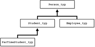

For example, suppose you have the following type hierarchy, with person_typ as the root:
Figure 6-1 Object Type Hierarchy
Description of Figure 6-1 follows
Description of "Figure 6-1 Object Type Hierarchy"
If you have created an object view hierarchy based on this type hierarchy, with an object view built on each type, you can query the object view that corresponds to the level of specialization you are interested in. For instance, you can query the view of student_typ to get a result set that contains only students, including part-time students.

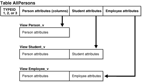

6.14.1.1 The Flat Model
In the flat model, all the views in the hierarchy are based on the same table.
In the following example, the single table AllPersons contains columns for all the attributes of person_typ, student_typ, and employee_typ.
Figure 6-2 Flat Storage Model for Object View Hierarchy
Description of Figure 6-2 follows
Description of "Figure 6-2 Flat Storage Model for Object View Hierarchy"
The typeid column identifies the type of each row. These possible values are the types created in Example 6-16, 1 = person_typ, 2 = student_typ, and 3 = employee_typ:
Example 6-17 creates the table AllPersons and then the views that make up the object view hierarchy:
Example 6-17 Creating an Object View Hierarchy
-- Requires Ex. 6-16
CREATE TABLE AllPersons
( typeid NUMBER(1),
  ssn NUMBER,
  name VARCHAR2(30),
  address VARCHAR2(100),
  deptid NUMBER,
  major VARCHAR2(30),
  empid NUMBER,
  mgr VARCHAR2(30));
CREATE VIEW Person_v OF person_typ
  WITH OBJECT OID(ssn) AS
  SELECT ssn, name, address
  FROM AllPersons
  WHERE typeid = 1;
CREATE VIEW Student_v OF student_typ UNDER Person_v
  AS
  SELECT ssn, name, address, deptid, major
  FROM AllPersons
  WHERE typeid = 2;
CREATE VIEW Employee_v OF employee_typ UNDER Person_v
  AS
  SELECT ssn, name, address, empid, mgr
  FROM AllPersons
  WHERE typeid = 3;
The flat model has the advantage of simplicity and poses no obstacles to supporting indexes and constraints. Its drawbacks are:

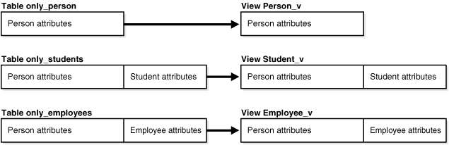

6.14.1.2 The Horizontal Model
On the horizontal model, each view or subview is based on a different table.
In the example, the tables are relational, but they could just as well be object tables for which column substitutability is turned off.
Figure 6-3 Horizontal Storage Model for Object View Hierarchy
Description of Figure 6-3 follows
Description of "Figure 6-3 Horizontal Storage Model for Object View Hierarchy"
Example 6-18 creates tables and then views based on these tables.
Example 6-18 -- Creating Table Horizontal Model
-- Requires Ex. 6-16 and Ex. 6-17
CREATE TABLE only_persons
( ssn NUMBER,
  name VARCHAR2(30),
  address VARCHAR2(100));
CREATE TABLE only_students
( ssn NUMBER,
  name VARCHAR2(30),
  deptid NUMBER,
  major VARCHAR2(30));
CREATE TABLE only_employees
( ssn NUMBER,
  name VARCHAR2(30),
  empid NUMBER,
  mgr VARCHAR2(30));
CREATE OR REPLACE VIEW Person_v OF person_typ
  SELECT *
  FROM only_persons;
CREATE OR REPLACE VIEW Student_v OF student_typ UNDER Person_v
  AS
  SELECT *
  FROM only_students;
CREATE OR REPlACE VIEW Employee_v OF employee_typ UNDER Person_v
  AS
  SELECT *
  FROM only_employees;

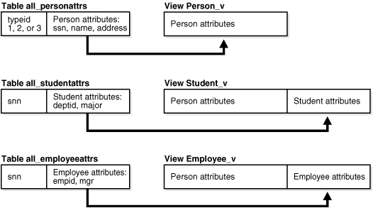

6.14.1.3 The Vertical Model
In the vertical model, there is a physical table corresponding to each view in the hierarchy.
However, the physical tables store only those attributes that are unique to their corresponding subtypes.
Figure 6-4 Vertical Storage Model for Object View Hierarchy
Description of Figure 6-4 follows
Description of "Figure 6-4 Vertical Storage Model for Object View Hierarchy"
Example 6-20 creates tables and then corresponding views.
Example 6-20 Creating table, views vertical model
CREATE TABLE all_personattrs
( typeid NUMBER,
  ssn NUMBER,
  name VARCHAR2(30),
CREATE TABLE all_studentattrs
( ssn NUMBER,
  deptid NUMBER,
CREATE TABLE all_employeeattrs
( ssn NUMBER,
  empid NUMBER,
  mgr VARCHAR2(30));
  FROM all_personattrs
  WHERE typeid = 1;
  AS
  SELECT x.ssn, x.name, x.address, y.deptid, y.major
  FROM all_personattrs x, all_studentattrs y
  WHERE x.typeid = 2 AND x.ssn = y.ssn;
CREATE OR REPLACE VIEW Employee_v OF employee_typ UNDER Person_v
  AS
  SELECT x.ssn, x.name, x.address, y.empid, y.mgr
  FROM all_personattrs x, all_employeeattrs y
  WHERE x.typeid = 3 AND x.ssn = y.ssn;
The vertical model can efficiently process queries of the kind SELECT * FROM root_view, and it is possible to index individual attributes and impose unique constraints on them. However, to re-create an instance of a type, a join over object identifiers (OIDs) must be performed for each level that the type is removed from the root in the hierarchy.
