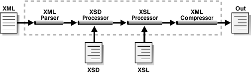

19.1.3 Multistage XML Processing
The Oracle XML Pipeline processor is built on the XML Pipeline Definition Language. The processor can take an input XML pipeline document and execute pipeline processes according to derived dependencies.
A pipeline document, which is written in XML, specifies the processes to be executed in a declarative manner. You can associate Java classes with processes by using the <processdef/> element in the pipeline document.
Use the Pipeline processor for multistage processing, which occurs when you process XML components sequentially or in parallel. The output of one stage of processing can become the input of another stage of processing. You can write a pipeline document that defines the inputs and outputs of the processes. Figure 19-1 shows a possible pipeline sequence.
Figure 19-1 Pipeline Processing
Description of Figure 19-1 follows
Description of "Figure 19-1 Pipeline Processing"
In addition to the XML Pipeline processor itself, XDK provides an API for processes that you can pipe together in a pipeline document. Table 19-2 summarizes the classes provided in the oracle.xml.pipeline.processes package.
The typical stages of processing XML in a pipeline are:
  1. Parse the input XML documents. The oracle.xml.pipeline.processes package includes DOMParserProcess for DOM parsing and SAXParserProcess for SAX parsing.
  2. Validate the input XML documents.
  3. Serialize or transform the input documents. The Pipeline processor does not enable you to connect the SAX parser to the Extensible Stylesheet Language Transformation (XSLT) processor, which requires a DOM.
In multistage processing, SAX is ideal for filtering and searching large XML documents. Use DOM to change or access XML content efficiently and dynamically.

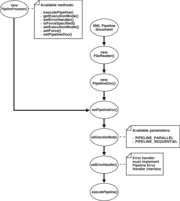

Figure 19-2 shows how to pass a pipeline document to a Java application that uses the XML Pipeline processor, configure the processor, and execute the pipeline.
Figure 19-2 Using the Pipeline Processor for Java
Description of Figure 19-2 follows
Description of "Figure 19-2 Using the Pipeline Processor for Java"
The basic steps are:
  1. Instantiate a pipeline document, which forms the input to the pipeline execution. Create the object by passing a FileReader to the constructor:
    PipelineDoc pipe;
    FileReader f;
    pipe = new PipelineDoc((Reader)f, false);
  2. Instantiate a pipeline processor. PipelineProcessor is the top-level class that executes the pipeline. Table 19-3 describes some available methods.
    Table 19-3 PipelineProcessor Methods
    Method Description
    executePipeline()
    Executes the pipeline based on the PipelineDoc set by invoking setPipelineDoc().
    getExecutionMode()
    Gets the type of execution mode: PIPELINE_SEQUENTIAL or PIPELINE_PARALLEL.
    setErrorHandler()
    Sets the error handler for the pipeline. This invocation is mandatory to execute the pipeline.
    setExecutionMode()
    Sets the execution mode. PIPELINE_PARALLEL is the default and specifies that the processes in the pipeline must execute in parallel. PIPELINE_SEQUENTIAL specifies that the processes in the pipeline must execute sequentially.
    setForce()
    Sets execution behavior. If TRUE, then the pipeline executes regardless of whether the target is up-to-date with the pipeline inputs.
    setPipelineDoc()
    Sets the PipelineDoc object for the pipeline.
    This statement instantiates the pipeline processor:
    proc = new PipelineProcessor();
  3. Set the processor to the pipeline document. For example:
    proc.setPipelineDoc(pipe);
  4. Set the execution mode for the processor and perform any other needed configuration. For example, set the mode by passing a constant to PipelineProcessor.setExecutionMode().
    This statement specifies sequential execution:
    proc.setExecutionMode(PipelineConstants.PIPELINE_SEQUENTIAL);
  5. Instantiate an error handler. The error handler must implement the PipelineErrorHandler interface. For example:
    errHandler = new PipelineSampleErrHdlr(logname);
  6. Set the error handler for the processor by invoking setErrorHandler(). For example:
    proc.setErrorHandler(errHandler);
  7. Execute the pipeline. For example:
    proc.executePipeline();

You can use the application with any of the pipeline documents in Table 19-4 to parse and transform an input XML document.
The basic steps of the program are:
  1. Perform the initial setup. The program declares references of type FileReader (for the input XML file), PipelineDoc (for the input pipeline document), and PipelineProcessor (for the processor). The first argument is the pipeline document, which is required. If a second argument is received, then it is stored in the logname String. This code fragment shows this technique:
    public static void main(String[] args)
      FileReader f;
      PipelineDoc pipe;
      PipelineProcessor proc;
      if (args.length < 1)
        System.out.println("First argument needed, other arguments are ".
                           "optional:");
        System.out.println("pipedoc.xml <output_log> <'seq'>");
        return;
      if (args.length > 1)
        logname = args[1];
  2. Create a FileReader object by passing the first command-line argument to the constructor as the file name. For example:
    f = new FileReader(args[0]);
  3. Create a PipelineDoc object by passing the reference to the FileReader object. This example casts the FileReader to a Reader and specifies no validation:
  4. Instantiate an XML Pipeline processor. This statement instantiates the pipeline processor:
  5. Set the processor to the pipeline document. For example:
  6. Set the execution mode for the processor and perform any other configuration. This code fragment uses a condition to determine the execution mode. If three or more arguments are passed to the program, then it sets the mode to sequential or parallel depending on which argument is passed. For example:
    String execMode = null;
    if (args.length > 2)
       execMode = args[2];
       if(execMode.startsWith("seq"))
       else if (execMode.startsWith("para"))
          proc.setExecutionMode(PipelineConstants.PIPELINE_PARALLEL);
  7. Instantiate an error handler. The error handler must implement the PipelineErrorHandler interface. The program uses the PipelineSampleErrHdler shown in PipelineSampleErrHdlr.java. This code fragment shows this technique:
  8. Set the error handler for the processor by invoking setErrorHandler(). This statement shows this technique:
  9. Execute the pipeline. This statement shows this technique:
    See Also:
    Oracle AI Database XML Java API Reference to learn about the oracle.xml.pipeline subpackages
