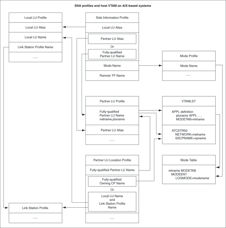

Side Information Profile
The side information profile is a required profile, which is used to identify target OLTP systems to be accessed through Oracle Database Gateway for APPC.
The side information profile identifies the following:
the partner LU alias or fully-qualified name
the remote transaction program name (optional)
the mode name
Set the profile information as follows for each side information profile field:
Set the Local LU or Control Point alias to the alias assigned to the local LU in the Local LU Profile.
Set the Mode name to the actual mode name as specified in the Mode Profile.
Set the Remote transaction program name (RTPN) using the actual remote TP name or a dummy name to be overridden at execution time.
Set the "RTPN in hexadecimal?" field to
yes
, if the remote TP name is hexadecimal. -
If there is a field for "Partner LU alias", then add the alias assigned to the partner LU in the Partner LU Profile.
If there is a field for "Fully qualified partner LU name", then add the fully qualified partner LU name of the partner LU.
Figure 7-1 shows the relationship between SNA server profiles and the VTAM definitions on the host.
Figure 7-1 Relationship Between SNA Profiles and Host VTAM Definitions
Description of "Figure 7-1 Relationship Between SNA Profiles and Host VTAM Definitions"
