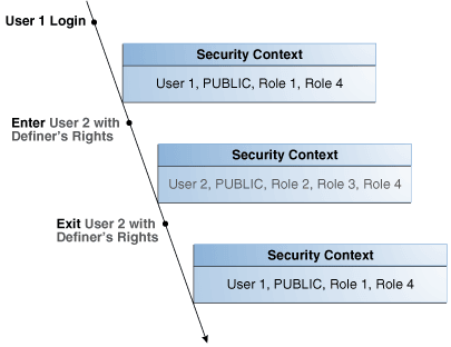

Definer's rights and invoker's rights are used to control access to privileges during user-defined procedure executions necessary to run a user-created procedure, or program unit.
In a definer's rights procedure, the procedure runs with the privileges of the owner, not the current user. The privileges are bound to the schema in which they were created. An invoker's rights procedure runs with the privileges of the current user, that is, the user who invokes the procedure. These procedures are not bound to a particular schema. They can be run by a variety of users and allow multiple users to manage their own data by using centralized application logic. Invoker's rights procedures are created with the AUTHID clause in the declaration section of the procedure code.
For example, suppose user bixby creates a procedure that is designed to modify table cust_records and then grants the EXECUTE privilege on this procedure to user rlayton. If bixby had created the procedure with definer's rights, then the procedure would look for table cust_records in bixby's schema. Had the procedure been created with invoker's rights, then when rlayton runs it, the procedure would look for table cust_records in rlayton's schema.
By default, all procedures are considered definer's rights. You can designate a procedure to be an invoker's rights procedure by using the AUTHID CURRENT_USER clause when you create or modify it, or you can use the AUTHID DEFINER clause to make it a definer's rights procedure.
You can create privilege analysis policies to capture privilege use of definer’s rights and invoker’s rights procedures.
9.2 How Procedure Privileges Affect Definer's Rights
The owner of a procedure, called the definer, must have the necessary object privileges for objects that the procedure references.
If the procedure owner grants to another user the right to use the procedure, then the privileges of the procedure owner (on the objects the procedure references) apply to the grantee's exercise of the procedure. The privileges of the procedure's definer must be granted directly to the procedure owner, not granted through roles. These are called definer's rights.
The user of a procedure who is not its owner is called the invoker. Additional privileges on referenced objects are required for an invoker's rights procedure, but not for a definer's rights procedure.
A user of a definer's rights procedure requires only the privilege to run the procedure and no privileges on the underlying objects that the procedure accesses. This is because a definer's rights procedure operates under the security domain of the user who owns the procedure, regardless of who is executing it. The owner of the procedure must have all the necessary object privileges for referenced objects. Fewer privileges need to be granted to users of a definer's rights procedure. This results in stronger control of database access.
You can use definer's rights procedures to control access to private database objects and add a level of database security. By writing a definer's rights procedure and granting only the EXECUTE privilege to a user, this user can be forced to access the referenced objects only through the procedure.
At run time, Oracle Database checks whether the privileges of the owner of a definer's rights procedure allow access to that procedure's referenced objects, before the procedure is run. If a necessary privilege on a referenced object was revoked from the owner of a definer's rights procedure, then no user, including the owner, can run the procedure.

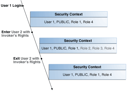

9.3 How Procedure Privileges Affect Invoker's Rights
An invoker’s rights procedure runs with all of the invoker's privileges.
Oracle Database enables the privileges that were granted to the invoker through any of the invoker's enabled roles to take effect, unless a definer's rights procedure calls the invoker's rights procedure directly or indirectly. A user of an invoker's rights procedure must have privileges (granted to the user either directly or through a role) on objects that the procedure accesses through external references that are resolved in the schema of the invoker. When the invoker runs an invoker's rights procedure, this user temporarily has all of the privileges of the invoker.
The invoker must have privileges at run time to access program references embedded in DML statements or dynamic SQL statements, because they are effectively recompiled at run time.
For all other external references, such as direct PL/SQL function calls, Oracle Database checks the privileges of the owner at compile time, but does not perform a run-time check. Therefore, the user of an invoker's rights procedure does not need privileges on external references outside DML or dynamic SQL statements. Therefore, the developer of an invoker's rights procedure only needs to grant privileges on the procedure itself, not on all objects directly referenced by the invoker's rights procedure.

An invoker’s rights procedure is useful in situations where a lower-privileged user must run a procedure owned by a higher-privileged user.
When a user runs an invoker's rights procedure (or any PL/SQL program unit that has been created with the AUTHID CURRENT_USER clause), the procedure temporarily inherits all of the privileges of the invoking user while the procedure runs.
During that time, the procedure owner has, through the procedure, access to this invoking user's privileges. Consider the following scenario:
  1. User ebrown creates the check_syntax invoker's rights procedure and then grants user jward the EXECUTE privilege on it.
  2. User ebrown, who is a junior programmer, has only the minimum set of privileges necessary for their job. The check_syntax procedure resides in ebrown's schema.
  3. User jward, who is a manager, has a far more powerful set of privileges than user ebrown.
  4. When user jward runs the check_syntax invoker's rights procedure, the procedure inherits user jward's higher privileges while it runs.
  5. Because user ebrown owns the check_syntax procedure, this user has access to user jward's privileges whenever jward runs the check_syntax procedure.
The danger in this type of situation—in which the lower privileged ebrown's procedure has access to jward's higher privileges whenever jward runs the procedure—lies in the risk that the procedure owner can misuse the higher privileges of the invoking user. For example, user ebrown could make use of jward's higher privileges by rewriting the check_syntax procedure to give ebrown a raise or delete ebrown's bad performance appraisal record. Or, ebrown originally could have created the procedure as a definer's rights procedure, granted its EXECUTE privilege to jward, and then later on change it to a potentially malicious invoker's rights procedure without letting jward know. These types of risks increase when random users, such as application users, have access to a database that uses invoker's rights procedures.
When user jward runs ebrown's invoker's rights procedure, there is an element of trust involved. This user must be assured that ebrown will not use the check_syntax procedure in a malicious way when it accesses jward's privileges. The INHERIT PRIVILEGES and INHERIT ANY PRIVILEGES privileges can help user jward control whether user ebrown's procedure can have access to jward's privileges. Any user can grant or revoke the INHERIT PRIVILEGES privilege on themselves to the user whose invoker's rights procedures they want to run. SYS users manage the INHERIT ANY PRIVILEGES privilege.

9.7.3 How Code Based Access Control Works with Invoker's Rights Program Units
Code based access control can run a program unit in an invoking user's context and with roles associated with this context.
Consider a scenario where there are two application users, 1 and 2. Application user 2 creates the invoker's right program unit, grants database role 2 to the invoker's rights unit, and then grants EXECUTE privileges on the invoker's rights unit to application user 1.
Figure 9-1 shows the database roles 1 and 2 granted to application users 1 and 2, and an invoker's right program unit.
Figure 9-1 Roles Granted to Application Users and Invoker's Right Program Unit
Description of Figure 9-1 follows
Description of "Figure 9-1 Roles Granted to Application Users and Invoker's Right Program Unit"
The grants are as follows:
  • Application user 1 is directly granted database roles 1 and 4.
  • Application user 2 is directly granted database role 2, which includes application roles 3 and 4.
  • The invoker's right program unit is granted database role 2.
When application user 1 logs in and runs the invoker's rights program unit, then the invoker's rights unit runs with the combined database roles of user 1 and the database roles attached to the invoker's rights unit.
Figure 9-2 shows the security context in which the invoker's rights unit is run. When application user 1 first logs on, application user 1 has the database PUBLIC role (by default), and the database roles 1 and 4, which have been granted to it. Application user 1 next runs the invoker's rights program unit created by application user 2.
The invoker's rights unit runs in application user 1's context, and has the additional database role 2 attached to it. Database roles 3 and 4 are included, as they are a part of database role 2. After the invoker's rights unit exits, then application user 1 only has the application roles that have been granted to it, PUBLIC, role 1, and role 4.
Figure 9-2 Security Context in Which Invoker's Right Program Unit IR Is Run
Description of Figure 9-2 follows
Description of "Figure 9-2 Security Context in Which Invoker's Right Program Unit IR Is Run"
9.7.4 How Code Based Access Control Works with Definer's Rights Program Units
Code based access control can be used to secure definer’s rights.
Code based access control works with definer's rights program units to enable the program unit to run using the defining user's rights, with the privileges of a combined set of database roles that are associated with this user.
Consider a scenario where application user 2 creates a definer's rights program unit, grants role 2 to the definer's rights program unit, and then grants the EXECUTE privilege on the definer's rights program unit to application user 1.
Figure 9-3 shows the database roles granted to application users 1 and 2, and a definer's rights program unit.
Figure 9-3 Roles Granted to Application Users and Definer's Rights Program Unit
Description of Figure 9-3 follows
Description of "Figure 9-3 Roles Granted to Application Users and Definer's Rights Program Unit"
  • Application user 2 is directly granted database role2, which includes database roles 3 and 4.
  • The definer's right program unit is granted database role 2.
When application user 1 logs in and runs definer's right program unit, then the definer's rights unit runs with the combined database roles of application user 2 and the database roles attached to the definer's rights unit (roles 2, 3, and 4).
Figure 9-4 shows the security context in which the definer's right program unit is run. When application user 1 first logs on, application user 1 has the database PUBLIC role (by default), and the database roles 1 and4, which have been granted to it. Application user 1 next runs the definer's rights program unit created by application user 2.
The definer's rights program unit runs in application user 2's context, and has the additional database role 2 attached to it. Database roles 3 and 4 are included, as they are a part of database role 2. After the definer's rights unit exits, application user 1 only has the database roles that have been granted to it (PUBLIC, role 1, and role 4).
Figure 9-4 Security Context in Which Definer's Right Program Unit DR Is Run
Description of Figure 9-4 follows
Description of "Figure 9-4 Security Context in Which Definer's Right Program Unit DR Is Run"
