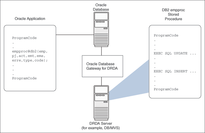

The procedural feature of the gateway enables invocation of native DRDA server stored procedures.
After the stored procedure is defined to the DRDA server, the gateway is able to use the existing DRDA server definition to run the procedure. The gateway does not require special definitions to call the DB2 stored procedure. Standard Oracle PL/SQL is used by the Oracle application to run the stored procedure.
In Figure 4-2, an Oracle application calls the empproc stored procedure that is defined to the DRDA server (for example, DB2 UDB for z/OS).
Figure 4-2 Running DRDA Server Stored Procedures
Description of "Figure 4-2 Running DRDA Server Stored Procedures"
From the perspective of the application, running the DB2 stored procedure is no different from invoking a stored procedure at a remote Oracle database instance.
