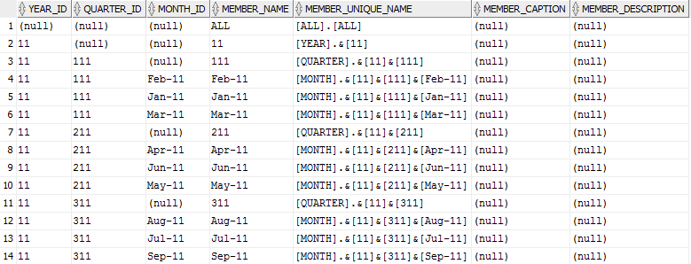

The following selects the attribute columns and some of the hierarchical columns from TIME_HIER when TIME_ATTR_DIM is the attribute dimension defined in Example 26-1.
SELECT year_id, quarter_id, month_id,
member_name, member_unique_name
member_caption, member_description
FROM time_hier
ORDER BY hier_order;
An excerpt from the query results are:

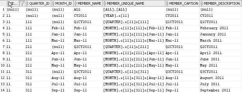

Example 26-3 Providing Values for Some Hierarchical Attributes
This is the excerpt from the results of the query of the hierarchy based on the simple attribute dimension in About Attribute Dimensions and Hierarchies.
While this hierarchy is functional, it lacks some important features. Note that the MEMBER_NAME column might not be easily readable, and the MEMBER_CAPTION and MEMBER_DESCRIPTION columns do not return data.
This new definition of the time_attr_dim attribute dimension includes the _NAME columns from the TIME_DIM table. In the definitions of the levels, it specifies attributes that contain values for the hierarchical attributes MEMBER_NAME, MEMBER_CAPTION, and MEMBER_DESCRIPTION. This definition provides a hierarchy that uses the attribute dimension with descriptive values for the level members.

This statement selects the attribute columns and some of the hierarchical columns from the TIME_HIER hierarchy.
member_name, member_unique_name,
FROM time_hier

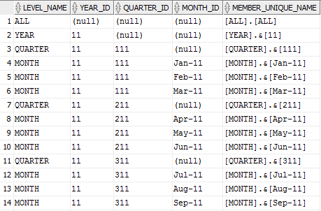

This query includes the hierarchy order attribute.
SELECT year_id,
quarter_id,
month_id,
member_name,
hier_order
FROM time_hier
This is an excerpt from the query results.
The level members are now sorted by end dates.

Select the LEVEL_NAME, _ID, and MEMBER_UNIQUE_NAME columns from the TIME_HIER hierarchy.
SELECT level_name,
year_id,
quarter_id,
month_id,
member_unique_name
FROM time_hier
The hierarchy now knows the relationship between the months, quarters, and years attributes, as shown in the following results of the preceding query. The MEMBER_UNIQUE_NAME values are now created from only the level name and the KEY attribute value; they no longer must include the full lineage as seen in Example 26-3.
