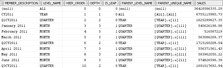

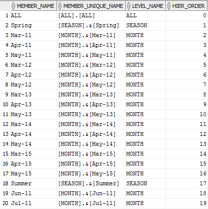

A query that selects from an analytic view that does not include filters has the potential of returning large numbers of rows. However, in this query, the SALES_AV analytic view includes a single hierarchy that returns only 86 rows.
SELECT *
  FROM sales_av HIERARCHIES(time_hier)
  ORDER BY time_hier.hier_order;
This is a excerpt of the returned values.

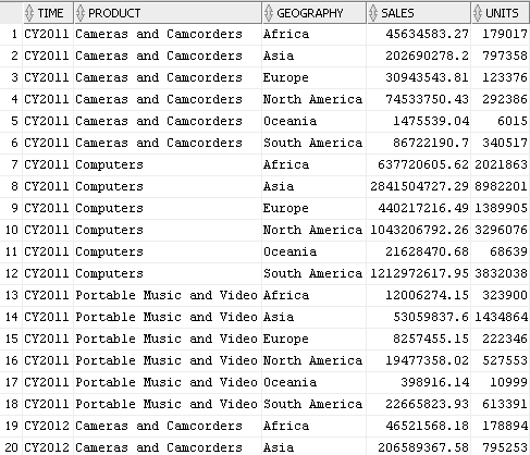

The following query adds the PRODUCT_HIER and GEOGRAPHY_HIER hierarchies to the HIERARCHIES phrase of the FROM clause.
SELECT time_hier.member_name AS Time,
 product_hier.member_name AS Product,
 geography_hier.member_name AS Geography,
 sales,
 units
FROM
 sales_av HIERARCHIES (time_hier, product_hier, geography_hier)
WHERE time_hier.level_name in ('YEAR')
  AND product_hier.level_name in ('DEPARTMENT')
  AND geography_hier.level_name in ('REGION')
ORDER BY time_hier.hier_order,
  product_hier.hier_order,
  geography_hier.hier_order;
The query returns 50 rows. The following image shows only the first 20 rows.

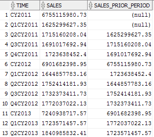

Select the SALES and SALES_PRIOR_PERIOD measures at the YEAR and QUARTER levels.
SELECT time_hier.member_name as TIME,
 sales,
 sales_prior_period
FROM
WHERE time_hier.level_name IN ('YEAR','QUARTER')
In this excerpt from the query results, note that the LAG expression returns prior periods within the same level.

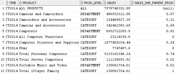

The SALES_SHR_PARENT_PROD measure calculates the ratio of a SALES value at the CATEGORY or DEPARTMENT level to SALES of the parent in the PRODUCT_HIER hierarchy, such as the ratio of SALES for Total Server Computers to Computers.
This query selects SALES and SALES_SHR_PARENT_PROD measure for CY2014 at each level of the PRODUCT_HIER hierarchy.
 product_hier.level_name     AS Prod_Level,
 sales,
 ROUND(sales_shr_parent_prod,2) AS sales_shr_parent_prod
FROM
 sales_av HIERARCHIES (time_hier, product_hier)
WHERE time_hier.year_name = 'CY2014'
AND time_hier.level_name = 'YEAR'
ORDER BY product_hier.hier_order;
The results of the query are:

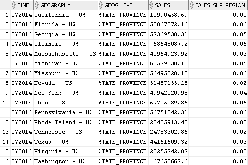

The SALE_SHR_REGION measure calculates the share of SALES at the STATE or COUNTRY levels to SALES at the REGION level, for example, the ratio of SALES for California - US to SALES for North America.
This query returns the values for the SALES and SALES_SHR_REGION measures for year CY2014 and states in the United States.
 geography_hier.level_name   AS Geog_Level,
 sales,
 ROUND(sales_shr_region,2)   AS sales_shr_region
FROM
 sales_av HIERARCHIES (time_hier, geography_hier)
AND geography_hier.country_name = 'United States'
AND geography_hier.level_name = 'STATE_PROVINCE'
ORDER BY geography_hier.hier_order;
This is the result of the query.

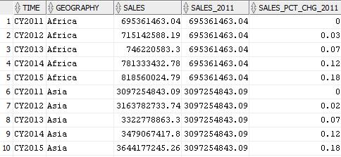

Regardless of filters in the query, the SALES_2011 measure always returns data for the year CY2011. The SALES_PCT_CHG_2011 measure calculates the percent difference between the current time period and CY2011.
This query selects SALES, SALES_2011 and SALES_PCT_CHG_2011 at the YEAR and REGION levels.
 sales,
 sales_2011,
 ROUND(sales_pct_chg_2011,2) as sales_pct_chg_2011
FROM
WHERE time_hier.level_name = 'YEAR'
AND geography_hier.level_name = 'REGION'
ORDER BY geography_hier.hier_order,
This is an excerpt from the query results. Note that for each row SALES_2011 returns SALES for CY2011.

Create a hierarchy in which MONTH is a child of SEASON.
CREATE OR REPLACE HIERARCHY time_season_hier
USING time_attr_dim
  (month CHILD OF
   season);
Select data from the TIME_SEASON_HIER hierarchy.
SELECT member_name,
  member_unique_name,
  level_name,
  hier_order
FROM time_season_hier
ORDER BY hier_order;
In the results of the query, the TIME_SEASON_HIER hierarchy returns rows for the ALL level, SEASONS, and MONTHS. This image captures the first twenty of the rows returned.
