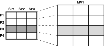

7.1.3 About Partition Change Tracking (PCT) Refresh for Materialized Views
Partition Change Tracking is the capability to leverage the knowledge about changes within individual partitions on a table contained in a materialized view for a potentially more efficient materialized refresh of the materialized view.
When there have been some partition maintenance operations on the detail tables, Partition Change Tracking is the only method of fast refresh that can be used. PCT-based refresh on a materialized view is enabled only if all the conditions described in "About Partition Change Tracking" are satisfied.
In the absence of partition maintenance operations on detail tables, when you
request a FAST
method (method => 'F'
) of refresh
through procedures in DBMS_MVIEW
package, Oracle uses a heuristic rule
to try log-based rule fast refresh before choosing PCT refresh. Similarly, when you
request a FORCE
method (method => '?'
), Oracle
chooses the refresh method based on the following order: log-based fast refresh, PCT
refresh, LPCT refresh, and complete refresh. Alternatively, you can request the PCT
method (method => 'P'
), and Oracle uses the PCT method provided all
PCT requirements are satisfied.

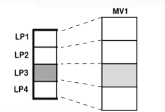

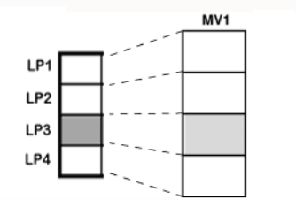

7.1.4 About Logical Partition Change Tracking (LPCT) Refresh for Materialized Views
Logical Partition Change Tracking is the capability to leverage the knowledge about changes within individual logical partitions on a table contained in a materialized view for a potentially more efficient materialized refresh of the materialized view. Unlike Partition Change Tracking which relies on the physical partitioning of tables, you define the logical partitions of your tables independently of any existing or non-existing partitioning schema of a table.
With LPCT, materialized view staleness can be tracked at the granularity of the logical partitions, and consequently the Query Rewrite engine can use the data in fresh logical partitions of the materialized view, even if some parts of the materialized may be stale. As a result, the materialized views becomes more usable. In many real-world applications, this results in significant improvement to query performance due to the fine-grained query rewrite. LPCT can perform refresh operations targeted at stale logical partitions only, which avoids complete re-loading the data.
Without LPCT, a materialized view on a non-partitioned table is either completely stale or completely fresh. When a materialized view is determined to be stale, it cannot be used for query rewrites even though the data needed by the query may be fresh.
The LPCT tracking mechanism records and consolidates the change statistics based on given LPCT key. Adjacent change data is grouped into a logical partition. During refresh, instead of using materialized view log, LPCT looks at the changes in the logical partitions. These are limited to a single column and RANGE or INTERVAL logical partitions. LPCT does not enforce partitioning of the base table. It tracks changes within defined RANGE or INTERVAL partitions in new dictionary tables. The syntax for refreshing a materialized view using LPCT refresh is as follows.
execute DBMS_MVIEW.REFRESH(<mview_name>,'L');
Unlike PCT, which must be specified at table creation, LPCT can be created,
modified, or dropped on the base table at any time, independent of table creation. The
base table can be partitioned or non-partitioned, which makes it more adaptable than
PCT. Because the LPCT framework requires metadata only and no changes to the base table,
it costs less physical overhead than PCT. LPCT can be combined with PCT to identify more
fine-grained stale ranges and allow for more query rewrites and faster materialized view
refresh. If a base table is both physically partitioned and also has an LPCT defined on
a different partitioning key, then any dependent materialized views can be refreshed
using a combined LPCT and PCT methods by specifying the 'L'
option in
the call to DBMS_MVIEW.REFRESH()
In tracking, LPCT is more lightweight than a materialized view log because it does not log each modified row on base table. Since it does not need to scan the entire materialized view log and join with base table for fresh data, an LPCT refresh outperforms log-based fast refresh, especially if modified rows are relatively large.
Logical Partition Change Tracking (LPCT) outperforms log-based refresh when modified rows are relatively large. An LPCT refresh can be combined with log-based refresh to improve the efficiency even more by targeting at more precise rows.

Determining the Freshness of Physical Partitions
You can check freshness of physical partitions using Partition Change Tracking (PCT). Here's an instance where there is a stale partition.
Query USER_MVIEW_DETAIL_PARTITION
to access PCT
freshness information for partitions, as shown in the
following:
SELECT MVIEW_NAME,DETAILOBJ_NAME,DETAIL_PARTITION_NAME, DETAIL_PARTITION_POSITION,FRESHNESS FROM USER_MVIEW_DETAIL_PARTITION WHERE MVIEW_NAME = MV1;
MVIEW_NAME DETAILOBJ_NAME DETAIL_PARTITION_NAME DETAIL_PARTITION_POSITION FRESHNESS ---------- -------------- --------------------- ------------------------- --------- MV1 T1 P1 1 FRESH MV1 T1 P2 2 FRESH MV1 T1 P3 3 STALE MV1 T1 P4 4 FRESH
Determining the Freshness of Logical Partitions
Use Logical Partition Change Tracking (LPCT) to determine the staleness/freshness of logical partitions.
In this example, the logical partitions are LP1, LP2, LP3, and LP4. Assume that LP3 is stale.
Logical partitioning does not support subpartitions.You can query
DBA_MVIEW_DETAIL_LOGICAL_PARTITION
to determine freshness of
logical
partitions.
SQL> SELECT MVIEW_NAME, DETAILOBJ_NAME, LPARTNAME, LPART#, FRESHNESS \
FROM DBA_MVIEW_DETAIL_LOGICAL_PARTITION WHERE MVIEW_NAME = 'MV1' ORDER BY 1,2,3,4;
MVIEW_NAME DETAILOBJ_NAME LPARTNAME LPART# FRESHNESS
MV1 SALES LP1 1 FRESH
MV1 SALES LP2 2 FRESH
MV1 SALES LP3 3 STALE
MV1 SALES LP4 4 FRESH
