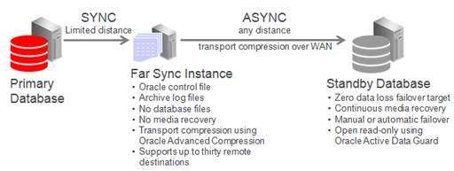

Far Sync Deployment Topologies
Oracle Active Data Guard Far Sync provides the ability to perform a zero data loss failover to a remote standby database without requiring a second standby database or complex operation.
Data Guard enables this by deploying a far sync instance (a lightweight Oracle instance that has only a control file, SPFILE, password file and standby log files; there are no database files or online redo logs) at a distance that is within an acceptable range of the primary for synchronous transport. A far sync instance receives redo from the primary through synchronous transport and immediately forwards the redo to up to 29 remote standby databases using asynchronous transport. A far sync instance can also forward redo to the Oracle Database Backup, Logging, and Recovery Appliance.
Figure 16-1 Far Sync Architecture Overview
general far sync setup as described in the previous paragraph

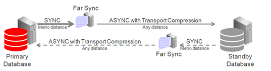

Case 1: Zero Data Loss Protection Following Role Transitions
This is the most basic example in which a primary database uses high availability far sync instances to extend zero data loss failover to a remote standby database.
Ideally the high availability far sync instance is deployed in a location separate from the primary database to isolate it from site failure, but within a metro area distance (network RTT of 5ms or less – subject to performance testing). Even if no separate location is available there is still a benefit to deploying a far sync instance within the same data center to enable fast, zero data loss failover for all unrecoverable outages short of full site failure.
The remote high availability far sync instance is idle while the standby database is in a standby role. It becomes active when the standby database transitions to the primary database role, enabling zero data loss failover to the new standby (old primary). The high availability far sync instance that is local to the original primary database becomes inactive while it is in a standby role.
Figure 16-2 Role Transition Facilitated by Far Sync
far sync keeps data loss to zero during a role transition as described in the previous paragraph

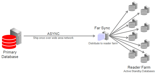

Case 2: Reader Farm Support
Far Sync can support up to 30 remote destinations, making it a very useful tool for supporting a reader farm – an Active Data Guard configuration having multiple active standby databases to easily scale read performance.
In this example the reader farm is configured in a remote location from the primary database. The primary ships once over the WAN to the far sync instance located in the remote destination and Far Sync distributes redo locally to all active standby databases in the reader farm.
Figure 16-3 Far Sync Ships Redo to Reader Farm
the primary database ships redo to a reader farm by way of a far sync instance as described in the paragraph above

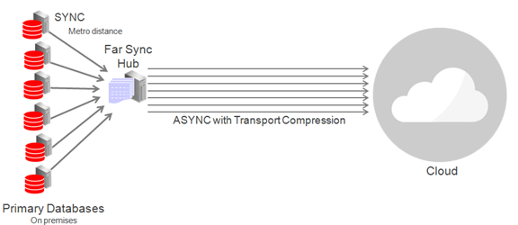

Case 3: Cloud Deployment With Far Sync Hub
Far Sync is a very lightweight process; a single physical server can support multiple far sync instances, each providing zero data loss failover to a remote destination.
The diagram below shows primary databases shipping to a single physical machine operating as a far sync "hub" consisting of multiple far sync instances on a single physical machine. Primaries and the far sync hub are on-premises while standby databases are deployed remotely in the cloud.
Note that all of the systems in this configuration (primary and standby database hosts and far sync instance host) must meet the usual requirements for compatibility in a Data Guard configuration described in Data Guard Support for Heterogeneous Primary and Physical Standbys in Same Data Guard Configuration (Doc ID 413484.1).
Figure 16-4 Far Sync Hub Architecture
far sync is show as a system between a group of primary databases and a cloud
